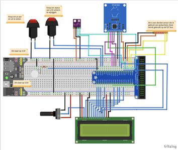

Step 1: Electronic Circuit Online
This is the circuit made with fritzing. Everything is connected to 3.3V except the LCD dispaly and the potentionmeter to 5v.
Step 2: Electronic Circuit Physical
In this step, you start connecting everything one at a time. Use the schematic to verify that everything is connected properly. Also be sure to check that the two grounds are connected.
