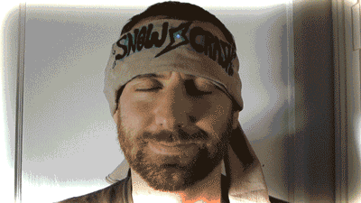

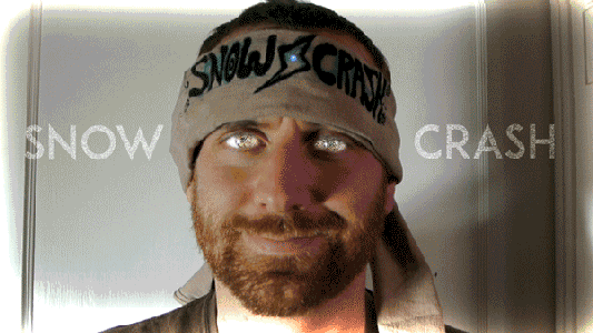

It's a simple headband that makes you see crazy flashing, mutating light patterns! It also seems to make you feel energetic or calm depending on the frequency. Passing High-Voltage, Low-Current electricity through your forehead to give yourself a private light-show has never been easier. It's cheap, and not that hard to make. In fact, if you have one of our Mod personal massagers or a dilduino board, you hook this setup directly to it and let yourself be internally massaged with vibrations that sync up to crazy light patterns in your eyes! Let us show you how to do this! If you follow our steps, you will have an awesome device for seeing crazy visuals and potentially changing your mood, as well as a DIY Tens-unit for stimulating your nerves!

Phosphenes (http://en.wikipedia.org/wiki/Phosphene) are little flashes of light that occur when your retina gets stimulated. They can occur from magnetic, electronic, or even physical stimulation. In our setup they seem to occur most intensely when the electricity passing around your head changes abruptly. People doing TDCS notice these right when they start or stop the electricity. By turning on and off the current quickly we can get all kinds of crazy flashing patterns and visuals.

Use the same protocol as with your muscles. FIRST TURN THE VOLTAGE ALL THE WAY DOWN. Then SLOWLY increase it. You will have much lower tolerance for voltages on your head than thicker parts of your body. The sweet spot we have found is around 9V.
