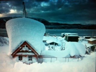

Also shown is why I wanted thick walls. It snowed 2 feet.
While you are breathing inside ice will form on the inner walls from condensation. This blocks any air from getting inside.YOU MUST HAVE FRESH AIR or Carbon Dioxide will build up and can cause death. If it is Snowing on your door slab keep making a fresh air hole through the new fallen Snow.This Shelter is to save your life in a Emergency.
