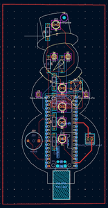

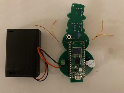

Each year I host a soldering social at my local Hackspace, Norwich Hackspace (https://norwichhackspace.org). I try to come up with something different each year, the first year, in 2023, I developed PCB Christmas trees with an Atmel 328p microcontroller (Arduino Uno or Nano) controlling an array of LEDs. In 2024 I designed a musical PCB bauble, again controlled by an Arduino 328p microcontroller flashing LEDs and playing music through a piezo buzzer. Having covered music and sound, for 2025 I decided I wanted to integrate a design with some kind of wireless communication.
I decided to depart from using my beloved, tried and trusted, Atmel 328p microcontroller and try out my new love, the Raspberry Pi Pico W development board, which uses the fantastic RP2040 microcontroller. One of the great features of the Raspberry Pi Pico dev board is that it is really easy to use it to host a webpage. This gave me the idea of hosting an online greetings card on the Pi Pico. To make life easier I wanted recipients to simply scan a QR code with their phone to see their seasonal greeting.
The Instructable guides you through the process of how I designed, built and coded this project. Please feels to hack, copy or adapt it any way you wish!
Check out the embedded video to see it work.

Here's a list of materials I used:
  1. Snowman Shaped PCB x 1
  2. Raspberry Pi Pico W Development Board x 1
  3. 1x20 2.54mm Pitch Female / Male Connector Strip x 2
  4. 1x20 2.54mm Pitch Male / Male Connector Strip x 2
  5. 5mm LEDs (colour of your choice) x 5
  6. 3mm LEDs (colour of your choice) x 2
  7. 1k ohm Resistors 10mm pitch x 8
  8. 2-Way Screw Connector Terminal x 1
  9. Piezo Buzzer 7.62mm pitch x 1 (optional)
  10. 3xAAA Battery Holder
  11. Copper Wire (for Arms)
  12. Solder
  13. PLA (For Base)
  14. Important!! Orange oven hardening modelling clay - for his nose x 1
Here's a list of the tools that I used:
  1. Laptop computer with Thonny IDE
  2. Soldering Iron
  3. Electronics Cutters
  4. Micro USB connector Lead
  5. Some Sticky Tack (to hold components in place when soldering)
  6. 3D Printer (for Base)

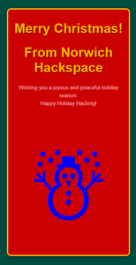

Step 1: Software Design - Option 1: Pi Pico As an Access Point and Local Server
I designed this project with two options in mind, the first option sets up the Pi Pico as a stand alone Access Point, hosts the website and blinks the LEDs on the PCB. Option 2 connects to the local network, host the website and blinks the LEDs on the PCB. Option 1 is better if you have more than one Pi Pico in the area as they are not competing for access on the network. This step shows you how to write the Micropython code for the Pico as an access point, in summary it does the following:
  1. Turns your Pico W into an access point
  2. Serves your uploaded index.html and style.css.
  3. Blinks the LEDs as programmed.
  4. Runs any other components (such as the buzzer)
  5. Doesn’t connect to any other Wi-Fi networks

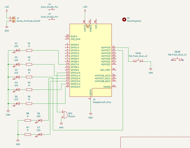

LED SETUP – Larson Scanner (Knight Rider style)
# LED SETUP – Larson scanner (Knight Rider style)
led_pins = [7, 11, 17, 14, 15] # GPIO numbers for 5 LEDs
leds = [Pin(pin, Pin.OUT) for pin in led_pins]
def larson_scanner(delay=0.06):# change delay to suit
"""Move the light from left to right, then back again."""
for i in range(len(leds)):
leds[i].on()
time.sleep(delay)
leds[i].off()
for i in range(len(leds) - 2, 0, -1):
leds[i].on()
time.sleep(delay)
leds[i].off()
A list of GPIO numbers defines the 7 LEDs used for the scanner effect. The pins for the LEDs were based on the PCB routing requirements.
Each GPIO pin is set as an output, and the larson_scanner() function animates them in sequence.
The function turns LEDs on one at a time from left to right, then back again (excluding the ends to avoid double-lighting). A delay value controls animation speed. This animation runs continuously in the main loop alongside the web server.

Step 2: Software Design - Option 2: Pi Pico As a Local Server
This option is good if you only want to operate one Pi Pico Webserver on your network. I find this option actually responds to website requests much faster than option one. The disadvantage is that the router’s DHCP server assigns an IP address to the device. This means you have to connect the Pico to your laptop and Thonny to get the IP address. You are then at the mercy of your router’s DHCP server which may change the IP address in the future. It is fairly simple to setup a fixed IP address in your Python code however I have found this makes accessing the webpage less reliable.

TURN ON THE LEDs
# ==== TURN ON ALL THE LEDS FIRST ====
# Define a list of pin numbers
led_pins = [7, 11, 17, 14, 15, 12, 13] # Adjust pin numbers as needed
# Create LED objects using a list comprehension
leds = [Pin(p, Pin.OUT) for p in led_pins]
# Turn all LEDs on using a loop
for led in leds:
led.on()
This option is much simple and only turns the LEDs on, no blinking.
  1. A list of GPIO pin numbers (led_pins) is created to define which pins have LEDs attached.
  2. A list comprehension then creates Pin objects for each LED and configures them as outputs.
  3. A for loop turns them all on at startup:

Step 4: Website Design
Bells and whistles on a PCB are nice, but this project is all about creating a cyber greetings card hosted on the Pico. For this reason we need to a design a seasonal webpage.
The Pi Pico doesn't have much storage so you need to keep you webpage simple. adding images is possible but I found they slowed things down and were best avoided.
I have included the HTML script as an attachment for you to modify and use as you like together with the CSS. However, I think it's very important to actually understand the code you are using, so here's a quick overview of the website script.
Document Type + HTML Structure
<!DOCTYPE html>
<html lang="en">
<!DOCTYPE html> tells the browser this is an HTML5 document.
<html lang="en"> begins the page and declares that the site content is in English.
The <head> Section
<head>
<meta charset="UTF-8">
<meta name="viewport" content="width=device-width, initial-scale=1.0">
<title>Merry Christmas from NH!</title>
<link rel="stylesheet" href="style.css">
</head>
The <head> contains important non-visible information:
  1. <meta charset="UTF-8">
  2. Ensures the page supports all standard characters (English, symbols, emojis, etc).
  3. <meta name="viewport"...>
  4. Makes the page scale correctly on phones and tablets (responsive layout).
  5. <title>
  6. Sets the browser tab name.
  7. <link rel="stylesheet"...>
  8. Loads the external CSS file (style.css) that styles the page.
The <body> Section
<body>
<div class="container">
Everything visible on the page goes inside <body>.
A <div> is a general-purpose layout box.
This one uses the CSS class container to centre the content and apply styling.
Headings
<h1>Merry Christmas!</h1>
<h1>From Norwich Hackspace</h1>
Two large headings displayed inside the main container.
Their appearance is controlled by the CSS h1 style.
Festive Message Paragraph
<p class="message"; style="color:pink;">
Wishing you a joyous and peaceful holiday season.<br>
Happy Holiday Hacking!
</p>
<p class="message"> styles the text based on the .message rule in your CSS.
The inline style style="color:pink;" overrides the CSS colour.
<br> forces a line break between the two sentences.
Snowman Symbol
<p style="color:blue; font-size:360px; margin:0;">
&#9731
</p>
I originally wanted to add a nice image here but it took up too much storage. Instead I used a Unicode encoding, 9731 is a Unicode code point in decimal as it corresponds to U+2603, named SNOWMAN. It looks pretty good!
Displays a large snowman using the HTML entity &#9731.
Because I always seem to end-up making spaghetti code I used some inline CSS that sets:
  1. blue colour,
  2. very large size (360px),
  3. no margin, so it sits neatly in the container.
End of Document
</div>
</body>
</html>
Closes the content container, page body, and HTML document.

Step 5: PCB Design
As with previous designs, for the PCB I used two software packages, Fusion360 and KiCAD. Fusion360 was used to design the custom shape of the PCB and KiCAD was used add the components and connecting wire traces.
There are multiple PCB design tutorials online for Fusion360 and KiCAD and other PCB design software packages.
Designing the PCB and developing the software was an iterative process. This is because I found that when designing the PCB it made more sense to use different pins than used on the first revision of the software. I therefore had the update main.py program once I had placed all the components and routed the traces.
I added a Piezo buzzer to the PCB and connected it to GPIO 1o on the Pico. I have not used it on the software yet, however I wanted to have the option to use it in the future and for other people to hack. The is the same as for the push button connected to GPIO 24.
To power the PCB there's two options. You can attach a power bank to the Pi Pico USB port or you can connect a 4.5V (3xAA or 3xAAA) battery pack to the terminal connector which is connected to the VSYS pin. The VSYS has a minimum input of 1.8V and maximum of 5.5V.
Please follow these links if you want the design files or to directly order a PCB.
The files for this code are available if you follow this link.
https://drive.google.com/drive/folders/1YnS_oBNWMFLJHQVA1XIPPKFZLlL_ugeX?usp=drive_link

Step 7: Soldering and Assembly
When I solder the components to a PCB I usually start with the physically lowest components (such as the resistors) and then work up to the highest components (the LEDs) as it makes it easier. The order I soldered the components was:
  1. 2 x 2x20 pin male header pins (to the Raspberry Pi Pico).
  2. 7 x 1K ohm LED
  3. 7 x LEDs
  4. 1 x momentary push buttons
  5. 2 x 2x20 pin female header pins.
  6. 1 x Piezo Buzzer.
  7. The Screw Connector on the back.
  8. The copper wire for the snowman's arms
Top Tip! I found that if I first soldered the male/male pins to the Pi Pico, then push-fitted the female/male pins onto the Pico male/male pins and then finally located the male side of the female/male ins to the PCB it helps locate the pins perfectly.
On the front of the PCB all the resistors are 8 x 1K ohm resistors near the LED positions (R1 to R7) and need to be positioned in their holes. Once I've pulled the leads through I bend them outwards at 45 degrees to stop the resistor falling out of the PCB. I then solder all the leads in place and trim off the excess lead.
To solder the connection remember to heat the connection of the PCB and the lead and then feed in just enough solder to make a neat joint. Then pull the soldering iron away and let the joint cool making sure not to move it.
The resistors are there to limit the current going to the LEDs and prevent it from becoming damaged and failing. They also mean your battery can last longer. When you place the resistors on the PCB in doesn't matter which way round they go.
The LEDs are a diode which means current can only go through them in one direction so it's very important they are put in the correct way round. An LED has two wires from it, usually called legs, and one is longer than the other. the Long leg goes to the positive and the short leg goes to the negative. If you look carefully at the PCB the LED position has two holes. One hole is surrounded by a square shape, this hole is for the negative LED lead (the short lead).
The momentary push button will only fit one way round so it's important that they are placed correctly. You may have to bend the pins a very small amount but not too much.
The Piezo Buzzer also needs to be installed the correct way round. Make sure the + terminal on the buzzer is placed in the hole marked with a + symbol.
The copper wire is soldered into the two holes named J1 and J2. This is your chance to be creative, you can bend and solder the arms to your own design.
A really useful tip for soldering components to a PCB is to place them in the correct position and then hold them there temporarily with blue tack. This enables you to turn the PCB upside-down without all the components falling out. This is how I soldered the microcontroller socket.
When you finally screw in the battery pack power leads ensure the red wire goes to the positive terminal and the black wire goes to the negative terminal.
To finish off the design I made a little carrot for his nose out of some orange oven hardening modelling clay.
