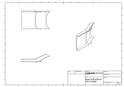

Step 4: 3D Printing - Plow
Now it is time to design the plow! Using Tinkercad and Fusion 360, design a plow. Ensure you also design a connector that can hold the servo which controls the plow, and attaches it to the body of the plow. At the back of the plow, ensure a section protrudes back slightly, to allow the servo to have room to rotate the plow. Make sure to keep technical drawings and prototypes. It is recommended to print a miniature prototype of the plow prior to printing the full size, to ensure the scale is correct.

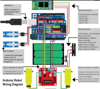

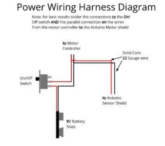

Step 6: Electrical
Using the wiring diagram, assemble the electrical components. Also attach a switch on the cable between the battery pack and the rest of the components. You will need to solder this, and solder several other parts as well such as soldering the motors to the wires.
Here is a few things to watch out for when wiring:
Make a Common Ground:
  • Ensure all components share a common ground. When testing, i was able to remove one ground cable and it still worked, but make sure GND is all connected.
Motor Controllers:
  • ensure the wires are in the right direction. Flip if motor is going backwards.
Servo :
  • Connect the control wire to a PWM-capable pin.
  • Remember that servos need 3 pins, which differ from motors.
Bluetooth Module:
  • Connect BT module’s TX to Arduino’s RX and RX to Arduino’s TX.
  • disconnect when uploading code
Analog Write:
  • Use PWM pins for controlling motors and servo. These are the pins with the little curved line by the pin. You need to do this for later on when we modify the code to support a 3rd motor.
Battery Pack/Switch:
  • Include a switch between the battery pack and circuit.
  • Ensure the battery pack meets voltage and current requirements - I first used a switch that was too small, and it caused the entire system to not work.
Wiring and Connections:
  • Secure all connections to prevent issues. I did this step at the end, but would recommend you do it as soon as you wire up, so wires don't become loose in testing. Good connections are key.

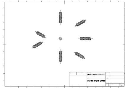

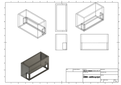

Now it's time to add the addition part. In this case, it is a salt dispenser which can dispense salt. I 3D printed both the augur and holder. Also print the motor gear connector which connects the motors to the gears. Design these parts.

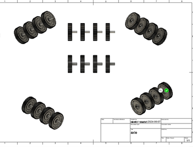

Step 11: Gears
Print 4 gears for the augur to connect to the e3rd motor. Design one or use a premade Fusion 360 Gear. The file is in step 10, drill a larger hole in the wood frame of the car as needed to support the gears.
Step 12: Wiring for 3rd Motor
Wire up the third motor and second motor controller. Also print the parts from above.
Here is a few other things to keep in mind, which were not mentioned in the first set of wiring tips in step 6:
Wire Length: Keep wires short to reduce resistance and this also makes it neater and easier to troubleshoot later on.
Color Coding: Use standard color codes (e.g., red for power, black for ground) to easily identify connections. Make signal wire colours different also.
Connector Types: Use connectors and jointers when needed. Don't just put a stripped wire into the Arduino pin, make sure the connector is attached and working. Solder when required.
Wire Types: Use stranded wire for flexibility and solid core wire for connections into the pins. I found the stranded core wired did not fit into the board well, so recommend using solid core.
Routing (Cable Management): Use cable ties or clips to keep wires neatly bundled and organized. I did not do this until the very end, and had issues troubleshooting as a result. It will make troubleshooting easier. I recommend being on top of cable management as you wire up, to reduce confusion and make it more straightforward.

Now that you have all the parts for the addition ready, it is time to assemble. Use a variety of hot glue, super glue, duct tape and paper to attach and assemble the salt dispenser, attach it to the 3rd motor, and build a chute for the salt to exit out of the bottom of the wood vehicle frame. Drill as needed.
