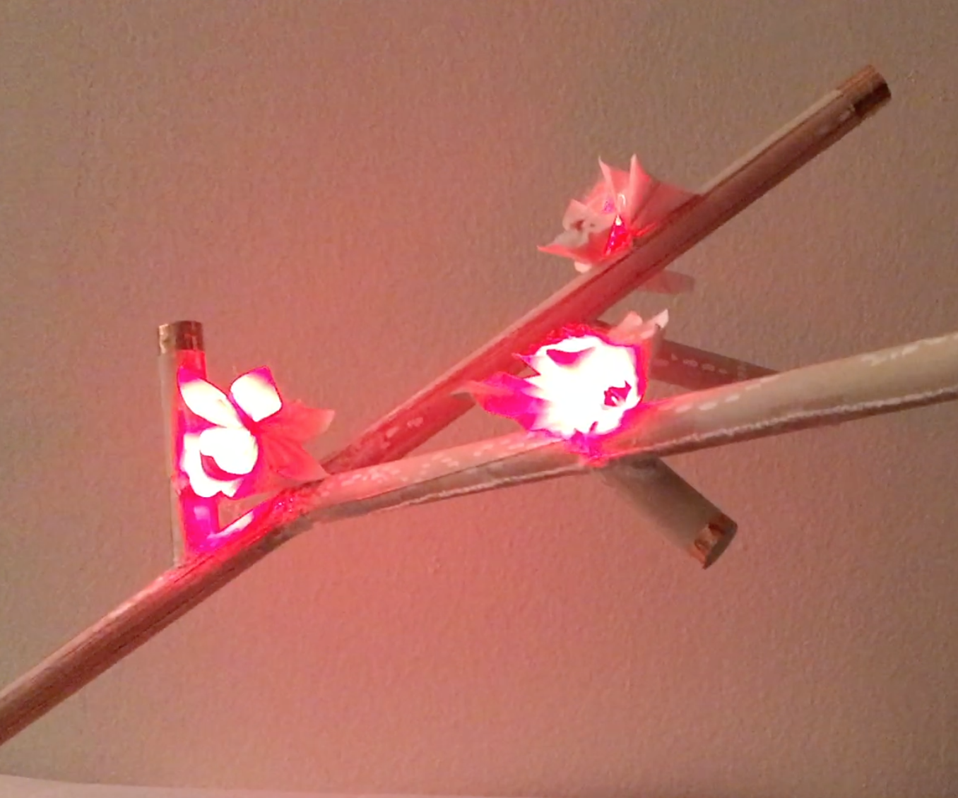

Step 3: Insert LEDs in Paper Crafts
After completing paper crafts, put white and blue LEDs inside origami snowflakes and cover the surface with cotton puffs.

Attach all origami snowflakes on tip of the frames with glues or tape. In this case, I used Arduino to control the LEDs and muscle wire, I had to link each led legs with conductive thread and extend it to the Arduino.
*IMPROTANT
Since you should keep seperate conductive thread not to touch with each other, you need to wind thread on each wire.
