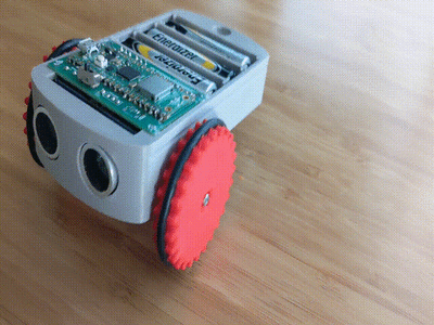

Step 1: 3D Print the Robot Parts
Download the STL Files: Download files for SoManyRobots DIY - Print In Place Robot
• Robot Body
• Robot Wheel
• Robot Case
3D Print Settings
• Use PETG filament for durable robot components.
• Use minimally 0.2 mm layer height.
• Use gyroid infill pattern for increased strength.
3D Print the Parts
• 1x Robot Body
• 2x Robot Wheels
• 1x Robot Case
Step 2: Mount Continuous Rotation Servos and Wheels
Mount Continuous Rotation Servos: Attach the continuous rotation servos to the body of the robot using screws.
• Route the servo wire through the bottom of the robot body to be attached with the electronics in subsequent steps.
• Servos will be placed on the Robot Body and use mounting holes that exist with the servo shaft facing the front of the robot.
• Use the Servomounting screws to mount continuous rotation servo to the Robot Body.
• Repeat for the second continuous rotation servo.
Add O-Ring to Wheels Add the Nitrile O-Ring to the 3D Printed Wheels.
• Slip the Nitrile O-Ring around the 3D Printed Wheel between the teeth.
• Ensure that the Nitrile O-Ring has a tight fit with the teeth on the circumference of the wheel.
• Repeat for the second 3D Printed Wheel.
Attach the Wheels: Secure the 3D Printed Wheels to the continuous rotation servos.
• Press the 3D Printed Wheel to the continuous rotation servo.
• Use the Servoscrew to mount the 3D Printed Wheel to the continuous rotation servo.
• Tighten the Servoscrew until secure and the servo begins to spin.

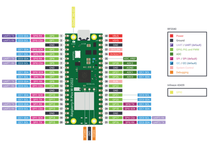

Prototyping with the Raspberry Pi Pico W has many options. Using a solderless breadboard allows flexibility to reuse, test, and extend designs without soldering and making it more difficult to iterate quickly.
Solderless breadboards include strips of 0.1" on center holes that may be used to insert electronic components or wire to build circuits. We will use 22 Gauge Solid Wire to build connections between electronic components.
In this step we will use a Raspberry Pi Pico W that has been soldered with header pins. If your Raspberry Pi Pico W did not come with header pins, you will need to add these.
While wiring a circuit or programming with a Microcontroller, using the reference pinout document allows you to understand the capabilities and purpose of each pin. The Pinout for the Raspberry Pi Pico W can be accessed from the official Raspberry Pi Pico docs(pinout image used with attribution).

Place AA Battery Terminals into the Robot Body
• Start with the Positive end (flat with single wire)
• Route the wire through the wire channel in the Robot Body
• Press the Positive terminal into the battery holder.
• Continue with the Negative end (spring with single wire)
• Press the Negative terminal into the battery holder.
• Finally add both of the Positive Negative Conversion terminals
• Ensure that the polarity of the terminals has been maintained.
• Press the Positive Negative Conversion terminals into the battery holder.
Make connections with the electronics to the So Many Robots PCB with Raspberry Pi Pico W
• Connect the Left Servo wire to the PCB header marked Left Motor.
• Connect the Right Servo wire to the PCB header marked Right Motor.
• Connect the Battery ground wire to the PCB ground connection.
• Connect the Battery 4.5V wire to the PCB power connection.
Place the So Many Robots PCB with Raspberry Pi Pico W into the Robot Body
• Fit the Ultrasonic Sensor into the front of the Robot Body.
• The Ultrasonic Sensor transmitter and receiver should be fitted through the circles.
• Ensure that all wires have been secured, a zip tie may be used to secure excess wires.
• Carefully adjust wires into the Robot Body.
• Place the So Many Robots PCB onto the Robot Body with the USB port above the right wheel.
• The PCB and robot body should fit securely together.
Insert 3x AA batteries
• Switch the robot into the On state by sliding the Slide Switch on the So Many Robots PCB.
• Expect the robot to power on with the LED in a blinking state ready to connect.
