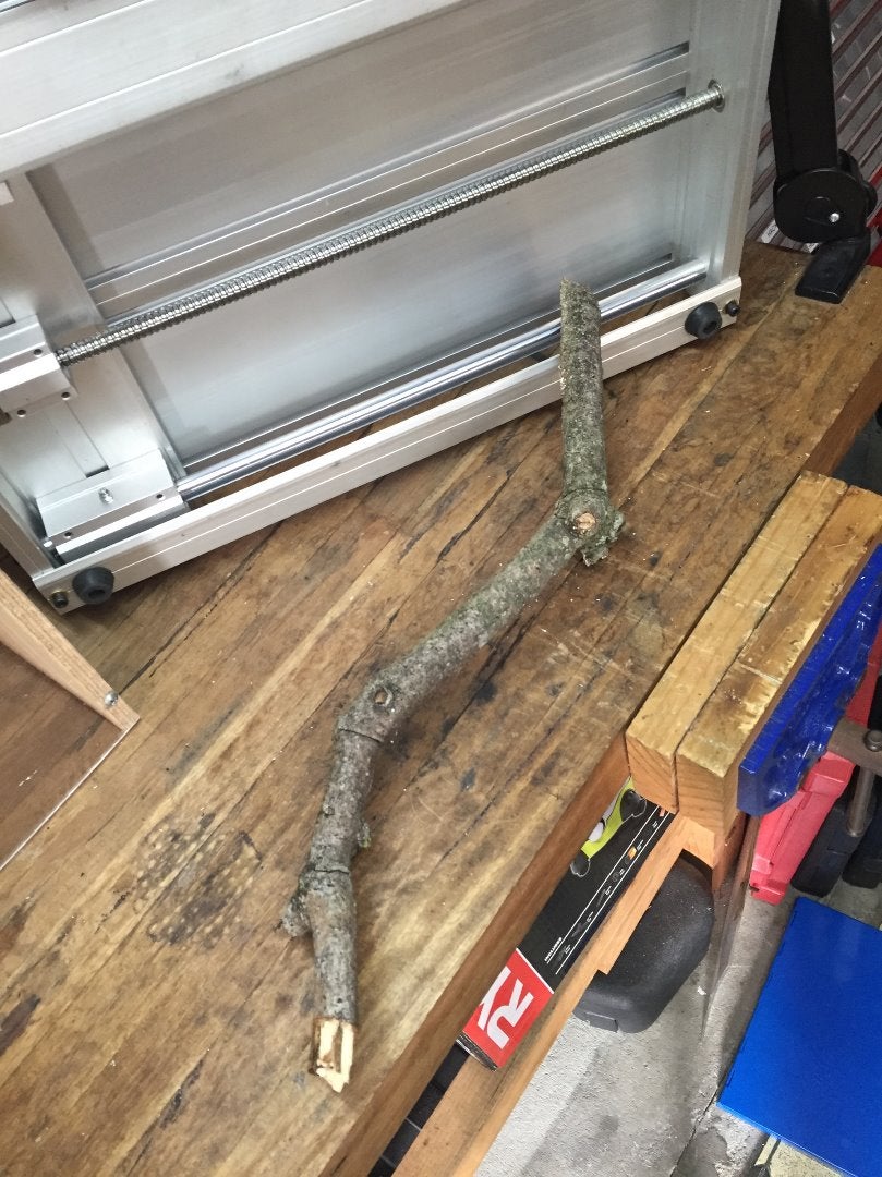

Step 2: History - Using a Stick
Using a stick to dig a hole in the ground is not good for much really. Perhaps this technique is useful if you wish to trap small animals. Later advances in this technology were based on making the stick sharper.

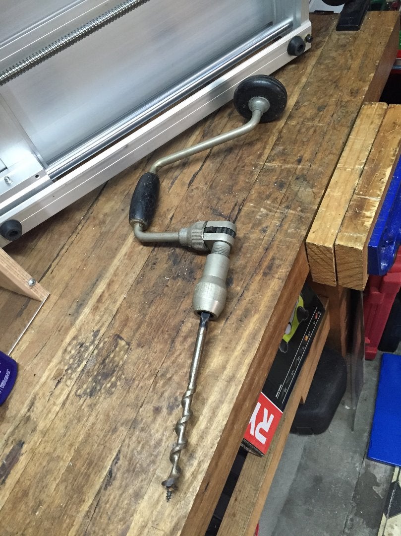

Step 3: History - Auger Bit and Brace
Used for boring medium to large diameter holes in timber. This tool has a long and proud history. Much like steam locomotives.

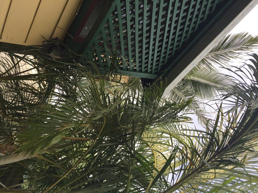

Step 8: Accessibility
Is the drilling location difficult to access? If the location is on a piece of wood on your bench then congratulations. You have selected an easy and relatively safe location for making your hole.
If your hole's location is on the underside of a car or at the very edge of your two-story home then you have a more difficult circumstance. You need to use your ingenuity to devise a way of making your hole more accessible.

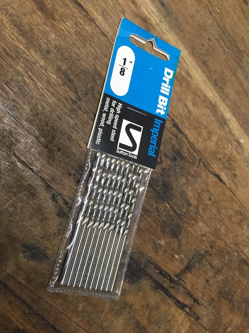

Step 14: Soft Materials - Bits
You're spoiled for choice here. There are many selections for types of bits and bobs that you can use to drill your hole. Simply select a bit that will create the diameter and depth hole that you require.
Step 15: Soft Materials - Drills
Almost any drill can be used for soft materials. The larger the hole the more torque you need. Start with a drill on the small end of available sizes.

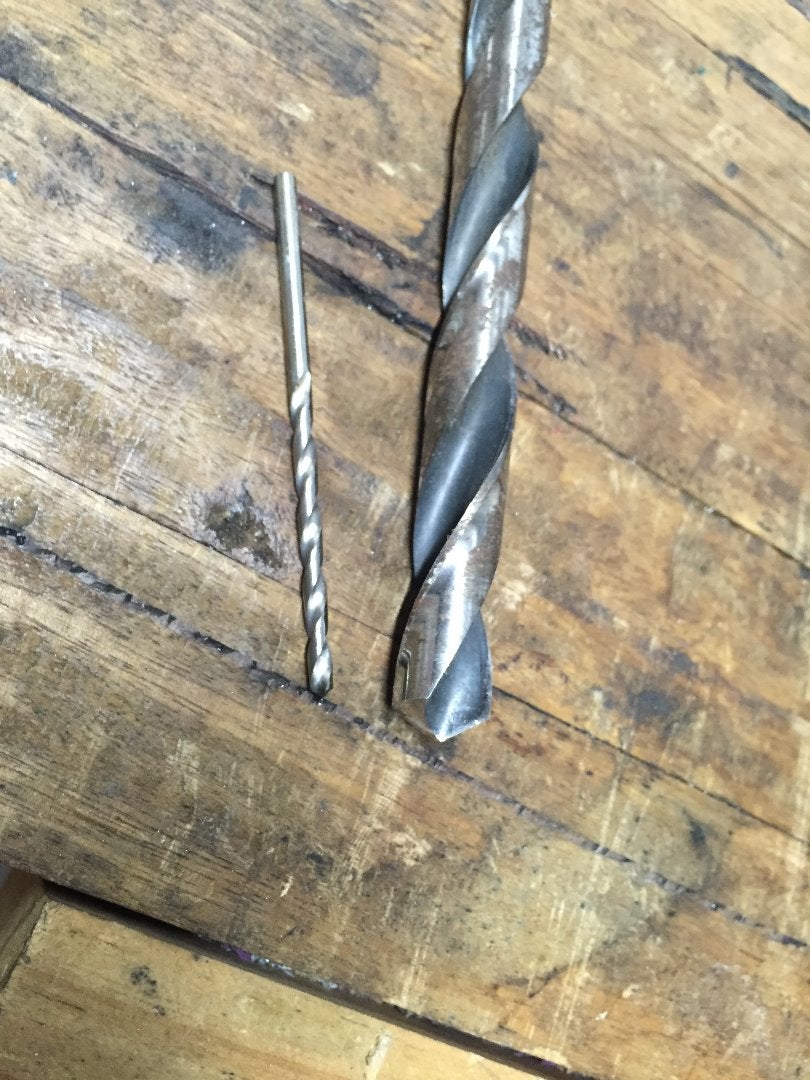

Step 25: Drill a Pilot
We can all do without so much pressure in our lives, right? The same is true for your hole.
Moderate to large sized holes in hard materials and large sized holes in soft material require a pilot. A pilot is a small hole that is drilled in advance of the main hole. If you drill a pilot, you will "fly through" your main hole. Ha! Geez I make me laugh.
Personally, I keep a whole squadron of pilot bits.
Pilot bits are expendable. These are the ones most likely to get blunted, broken and lost. Sound like airplane pilots? Anyway, the pilot hole helps greatly to relieve pressure on your main drill bit. Whew.
