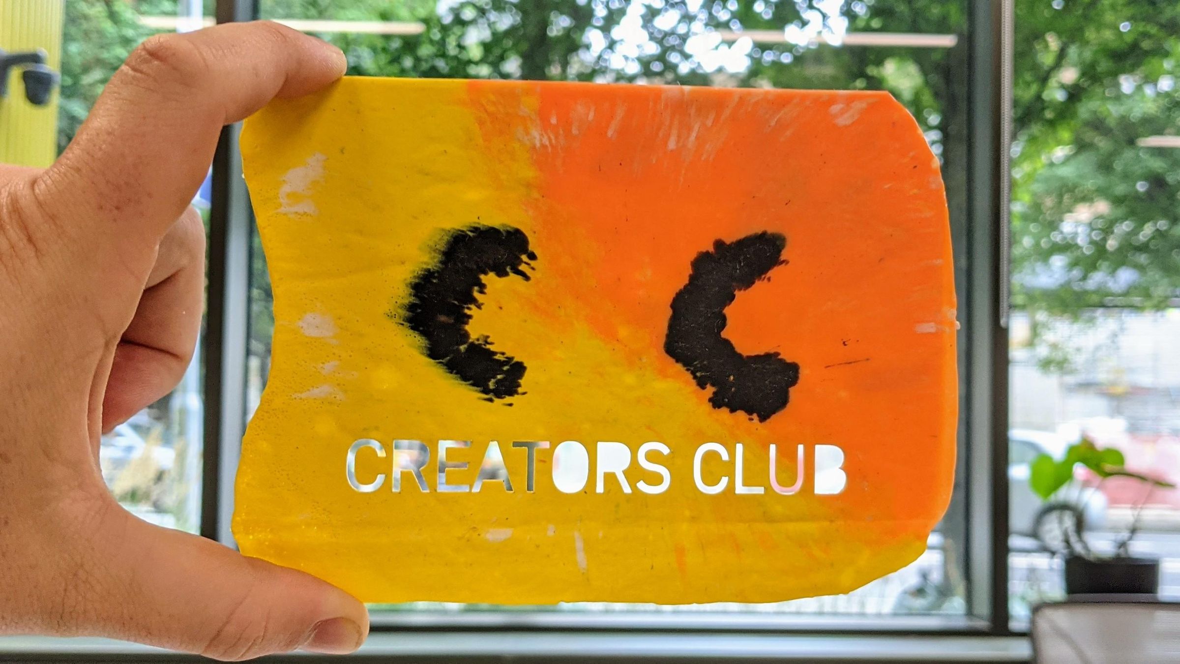

  • When each person is ready begin to pass out the their desired soap base and let them get mixing.
  • As the participants continue to plan mix and pour their creations into the moulds, be on hand to help keep their workspace tidy and to reset the ingredients and examples in the middle of the table.
  • As the workshop comes to an end, be sure that participants mark their creations and are confident of what ended up in each soap.
  • Keep the soaps to cure for 24 hours and invite the participants back to remove the soaps from their moulds when they collect them. Allowing participants to remove the soap is important, it is the final reveal and outcome of the participant's experiments.
