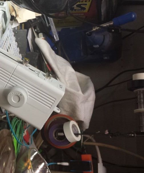

Step 3: Soldering Madness
Installed all the switches and the battery holder. Soldered one lead from the battery to one pole of each switch. The other pole of each switch gets wired to the corresponding pin on the female connector.
Don't make the mistake of forgetting that the numbers are mirror image on the backside like I did.
Leds got glued into their holes with some clear rtv silicone. Bent and soldered the negative leads to each other and then wired to the negative pole of the battery holder. The other lead from the leds each got a resister and some shrink tubing on it, then wired to the appropriate pin on the male connector. After I had soldered them to the wrong pins and had to figure out why it was giving me such unexpected wrong results.
Test button, resister and led got wired up mostly to allow one to test if the battery has gone dead or not.
