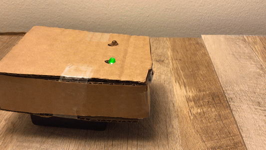

Step 6: Making a Cover
Now we can make a cover for our project to make it look nice.
Step 7: Cutting the Cardboard
Let’s first start with cutting the cardboard. We will make the top and bottom then we will make the sides. ( NOTE: your cardboard sizes might be different than mine )
Step 8: Cutting the Holes for the Distance Sensor
Now pick one of your short sides and cut holes for the distance sensor
Step 9: Connecting the Sides
Now take all of your sides and tape them together, then tape that to the bottom. when you are done with that try fitting the Arduino in.
Step 10: Cutting Holes for the Top
We obviously can’t see the LED's through the cardboard but we can poke holes so we can see the LED's. measure from the distance sensor to the LED then from the side to the LED. on the piece that covers the top do the same measurements and then cut the hole where ever the measurements line up. do the same thing for the other side.
Step 11: Cutting a Hole for the Battery Pack
Cut a small hole in the side so we can plug in our battery pack
Step 12: Your Done!
Now that you have finished you can go check every thing or you can go right ahead and test it.
