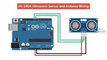

  1. Test each SR04 sensor separately using the SR04 example sketch on Arduino. It can be accessed here.

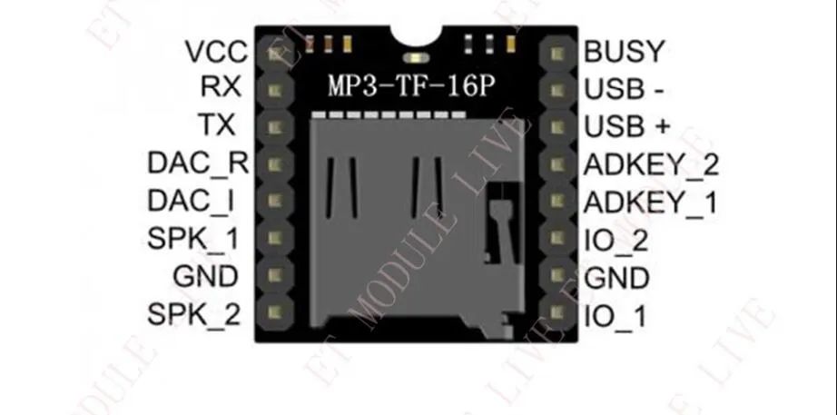

  1. DFPlayer Mini - VCC > POS side of power bus, RX > 11 (attach 1k resistor), TX > 10 (attach 1k resistor), SPK 1 > GND side of speaker, GND > GND side of power bus, SPK 2 > POS side of speaker
To avoid additional confusing on the MP3 player, I have also attached a zoomed in photo of it so you can see the pins better!
