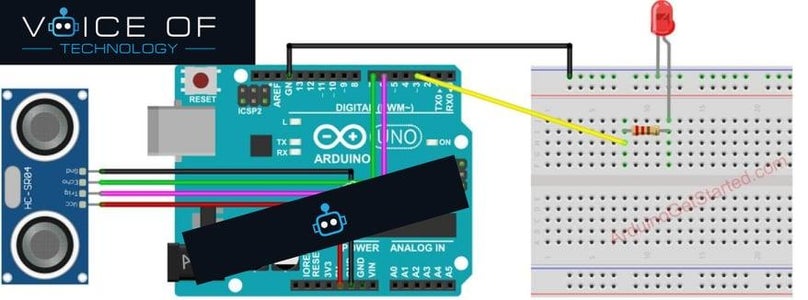

Circuit diagram-
Its a very simple project ,so the circuit is also very normal but the effective is the representation with the practical wa to express,
so connect :1) TRIG PIN OF ULTRASONIC SENSOR TO PIN NO. -6 OF ARDUINO
2)ECHO PIN WILL BE CONNECTED TO - 7PIN OF ARDUINO
3)Now connect the +5 volt pin of Arduino to the positive pin of Ultrasonic sensor.
4)Ground pin of Arduino to the ground of Ultrasonic sensor
5)The positive of led will be connected to the 3rd pin of Arduino with a resistance of 1kohm .
6)Ground of led will be grounded in arduino ground pin.
