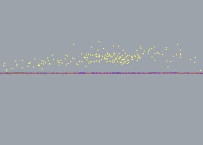

Step 3: Modeling
I used Rhino and the parametric plug-in Grasshopper to import GIS data and related attributes through the custom plug-ins Local Code and Heron. Both plug-ins allow for the geometry and attribute data to be imported together. The attributes can then be used to create three-dimensional models representing the data.
For example:
The Housing Density is simply an extrusion of the census blocks to the height of each density number.
The Median Income Level is slightly more complicated. It involves first taking the centroid of the census block and then raising it up to the height of the median income. Additional points are spread evenly along the perimeter of the city boundary. These points are then used to create a mesh surface that approximates income topography of the city.
The Ambient Noise Levels is a similar process to income, but includes an additional step that creates thickened mesh outline frame, rather than a surface.

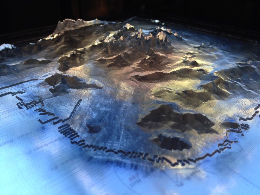

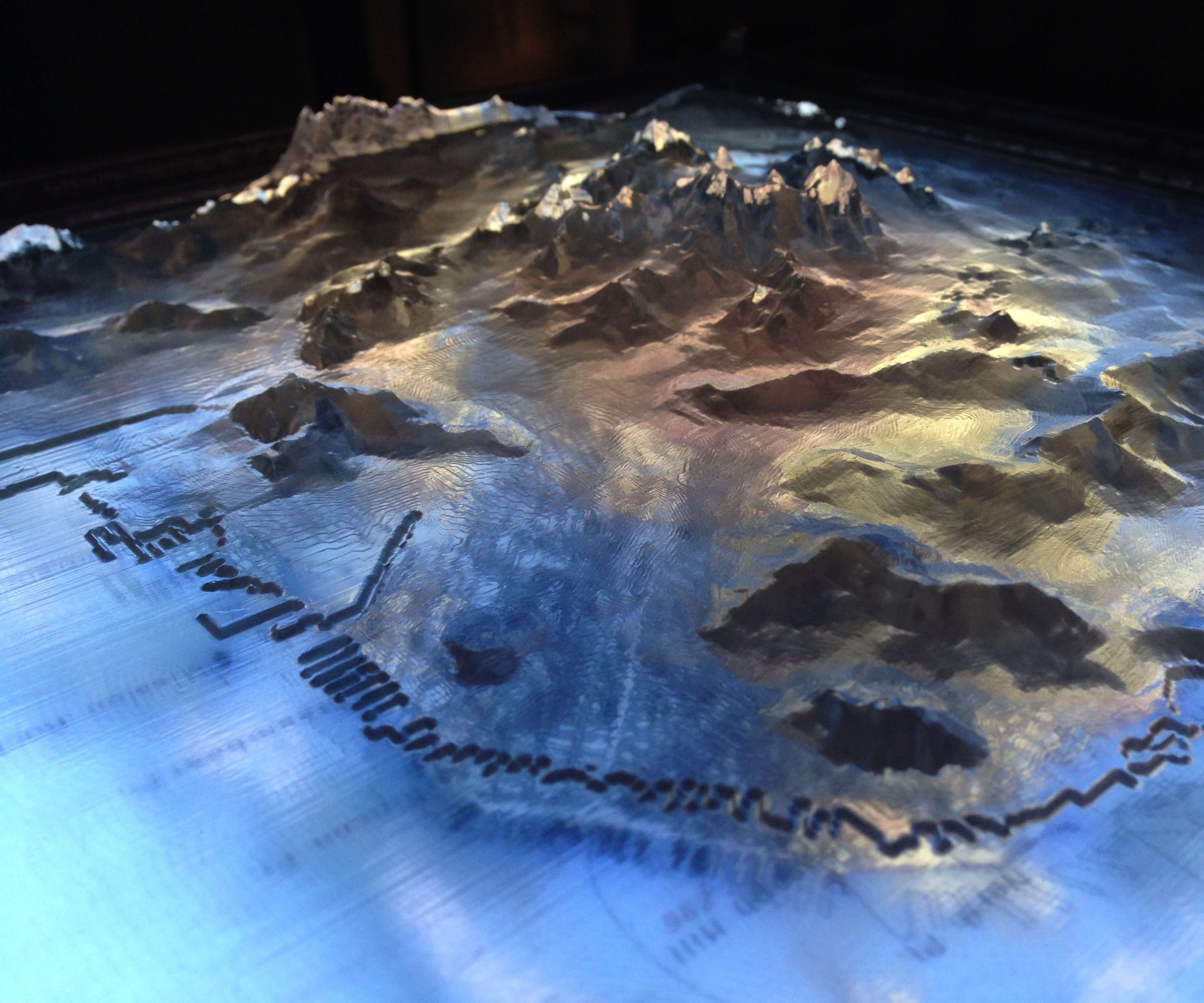

Step 5: 3D Printing
If all goes well with the .stl export and mesh editing in Meshmixer, it’s time to 3D Print. I used an Objet Connex 500 resin printer with materials Vero White and Tango Black Plus. This gave me the ability to print grey scale combinations of the two materials.

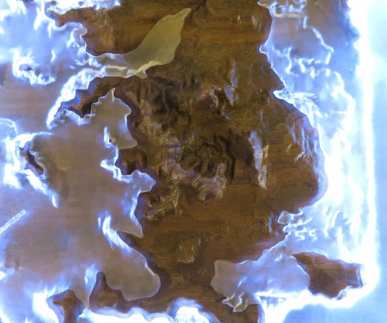

Step 6: Display
To display the 3D printed maps, I created a walnut veneer and birch frame on a Metabeam lasercutter. I then assembled the plywood frames by sandwiching the prints between the wood layers. I’m currently adding LED lights to the assemblage, which will highlight the translucent quality of the resin prints.
