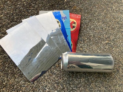

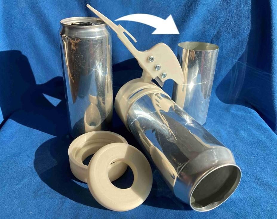

As usual, we start with normal soda cans. Here we use half liter soda cans from which we extract the soda can sheets. I've already posted an instructable on how to flatten the soda can sheets (link).
There is no need to remove the ink from the soda cans. We simply make our number with the inside facing out. However, if you are interested in removing the ink, there is another instructable (link) showing this procedure.
First, cut the soda can sheets to the desired dimensions using a utility knife. A single sheet will not be sufficient because of the length of the number. Here I have used two sheets to put the entire number together.
