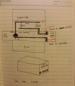

Step 3: Add Base Lamp Soft Circuitry
You can start from the base lamp, which is much easier. There are multiple ways to design the circuit, the drawings are just a demo of what I used for the lamp. The final look can be seen in the real lamp.
Some tips to pay attention:
1. Notice the +/- of LEDs and coin batteries. There will be one coin battery and two LEDs in each lamp.
2. After connecting the circuit, you can use nonconductive tape to fix the battery.
3. Soldering between copper tape and LEDs would largely improve the connection, so as the coin battery. If you don't know how to do that, tape it tight and increase the contact area.
4. The second image shows how to make the circuits of two lamps disconnected at the beginning but connected when attached.
