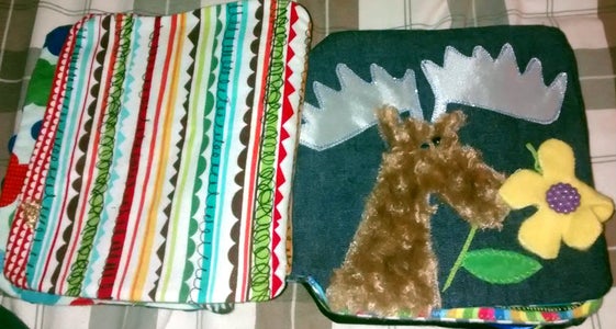

You can find many different busy-book patterns online and it is nice to have them, but you can also just create your own. Some of these pages are entirely of my own creation (the frog and the moose), and I altered all of the pages, so I will go through the process of creating a page from scratch.

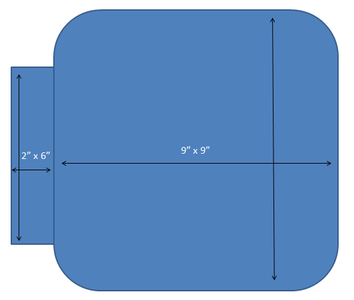

You need to start with a solid page size leaving a solid 1/2" border to sew it onto a backing.
Mine was: 9" x 9" square with a 6" x 2" spine. This was all one piece.

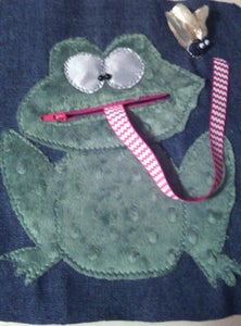

The example here, a frog, I wanted to have a zipper mouth as the interactive part.
I designed the template in two parts: the head and the body/legs. I wondered about having front legs and played around with this idea, but in the end I decided to keep it simple.

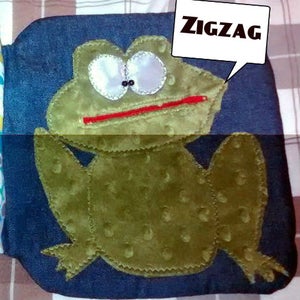

I ironed on 'backing' the wrong-side of my fabric in order to increase stiffness, and then pinned my template to this side (because it is easier to cut). I had to remember to flip my template so that the design would be right-side up when finished - not that it mattered much with these animals.
I cut out my fabric head and body/legs. I also free cut some large eyes out of a shiny material (also with backing).
Now for the interactive component. I had never sewn a zipper into anything before... so it was quite the job. (for other pages this was more simple - the button or hook and eye, for example). I won't go through how to sew in a zipper - I found the info online.
I placed my pieces onto the right side of my background fabric and pinned them down where I wanted them.

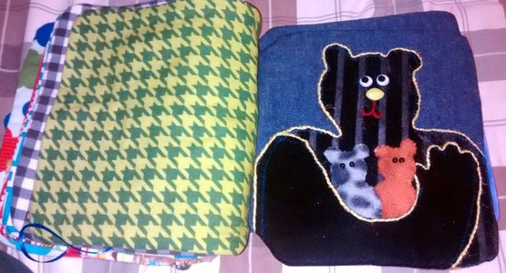

For the frog, I didn't want the bottom sewed into the edge of the page, so I kept his toes away from my 1/2 inch border line. For other pages (hippo, bear) I did want it sewed in to the edge, so I lined the fabric to the bottom of the background in those cases.
I started with the furthest back pieces - body/legs - and pinned it down. I zigzagged over the edge of the fabric and created the feeling of separate legs by continuing the sewing up the edges of the body. Sewing over the edges made it so that I didn't have to turn under anything and reduced the likelihood of fraying. In some places I also put fray check if I thought there was the chance of it pulling up. Because this was a baby book and would likely be pulled on and chewed on, I made sure to double knot every ending by pulling through both threads to the back and tying off.
The next pieces was the head - same process; and then the eyes on top of that.

I hand sewed a fly (bug button and gold fabric wings) onto the corner of the page and hand sewed a tongue (ribbon) into the mouth that can be taken in or out. I also sewed button pupils into the eyes. You should embellish at this stage so that all of your sewing doesn't show through to the back of the page once you sew it together.
