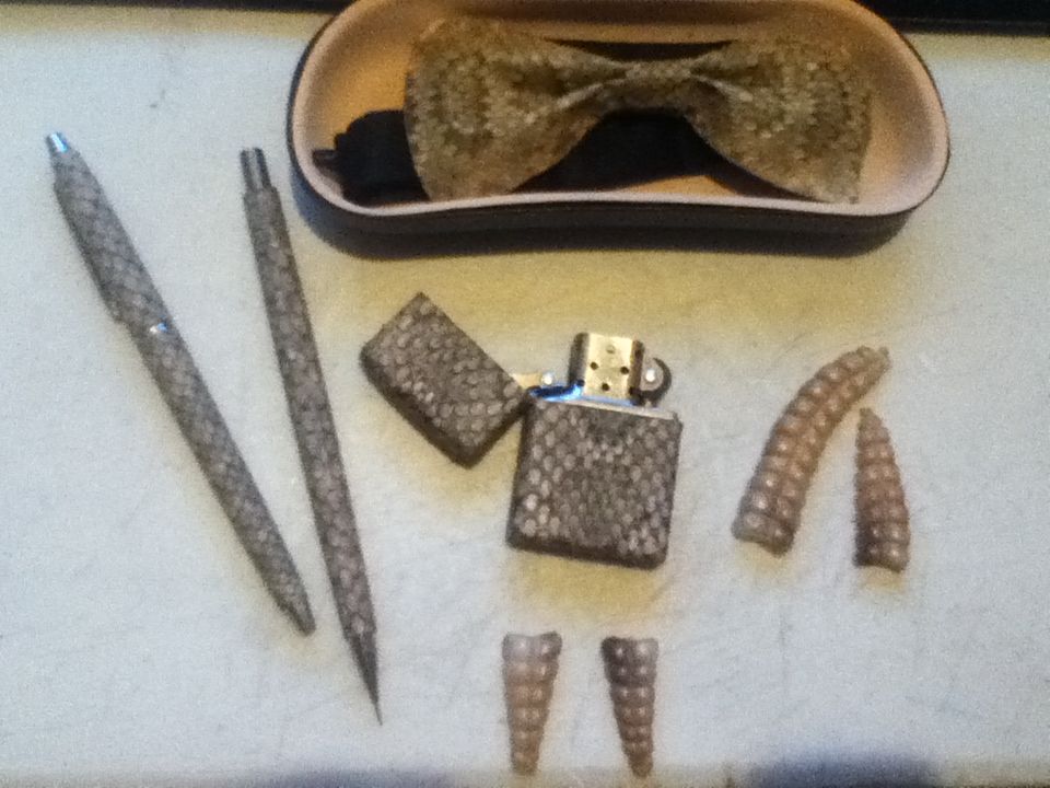

he was kind enough to give me several exotic leathers for free, here i took my regular leather wallet (1st picture) cut off the outside face (2nd picture) and replaced it with shark leather (3rd picture) the final result is obviously my last picture.
i apologize for not getting more pictures of the process but you really didn't miss much the real key is to glue everything together with the cement wherever you can, and then sew around the edges to prevent it from tearing apart. the sewing is the hardest part here and im honestly not too great at it myself. when sewing through such thick leathers, it is best to grip the needle with pliers and pre-punch ever single hole before threading the needle there is a special tool for this called an awl, but im cheap like that. thread your needle using thick waxy thread if you have it, if not get your strongest stuff and double it, you don't want it breaking.
sorry for not being of too much help the main point to this is to glue first, wherever you can, then sew the edges, on less wearable product, such as my hatband, you can just fold and glue the hide into an even band, then give a few stitches were the two ends meet.
