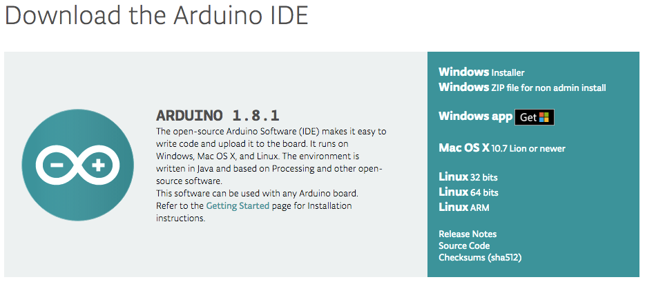

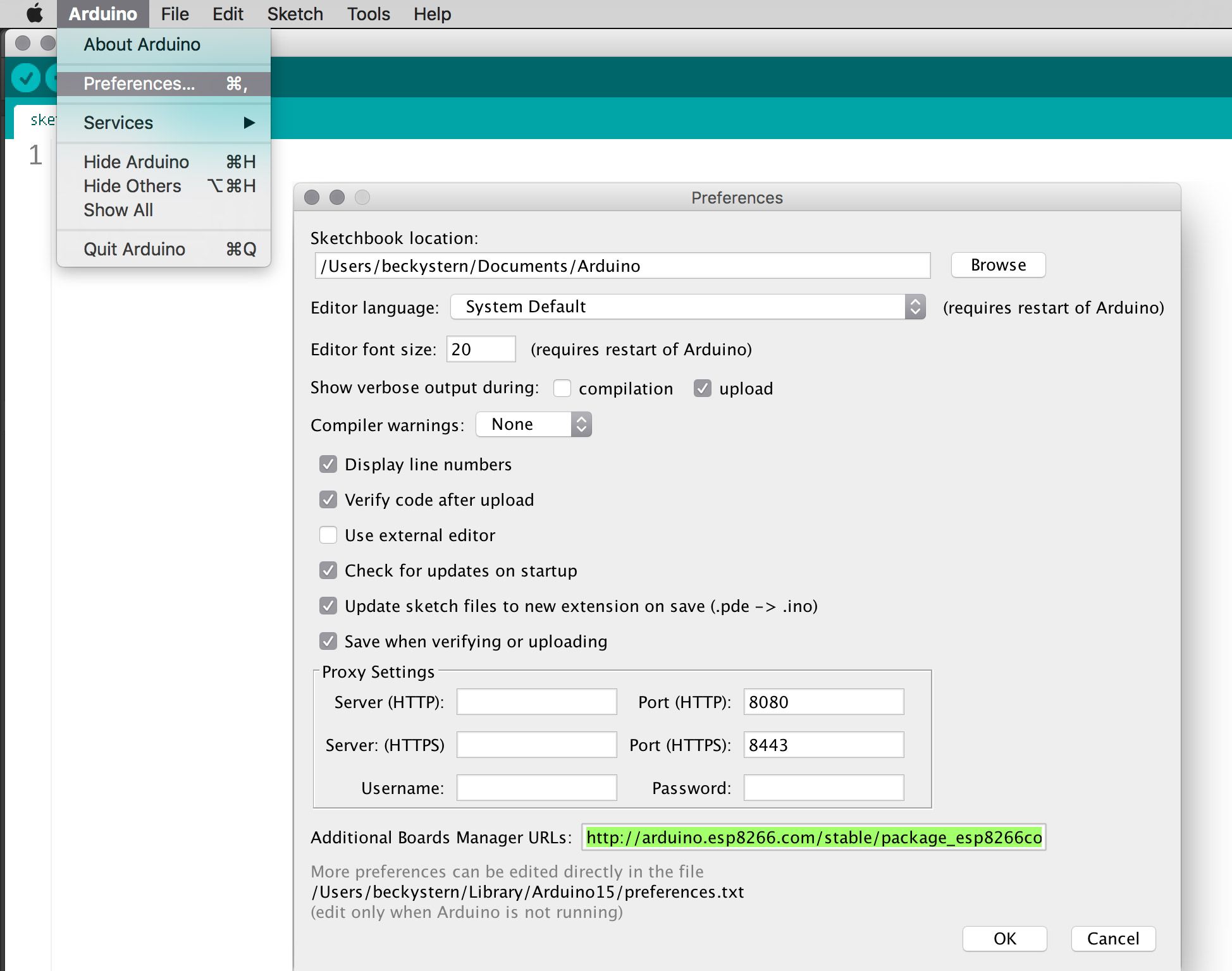

Download and install the latest version of the Arduino software on your computer, if you haven't already. Open up the Arduino application and navigate to the menu item Arduino->Preferences.
By default, the Arduino application supports chips used in official Arduino boards, but not the ESP8266. These boards can be programmed "out of the box" because the Arduino application already knows about each one and its properties. One cool thing about Arduino is that you can add support for other boards, and all you have to do is tell Arduino where to discover their properties. The first step of that process is providing a URL to the Additional Boards Manager. In the text box near the bottom of the Preferences window, paste in exactly this text:
http://arduino.esp8266.com/stable/package_esp8266com_index.json
If the box was not blank when you opened the Preferences window, you may have some other boards already installed. If that's the case, append the text box's contents with the above URL, using a comma to separate multiple URLs.
Click OK to close the Preferences window. Now our Arduino application knows where to find info about ESP8266 boards in general.

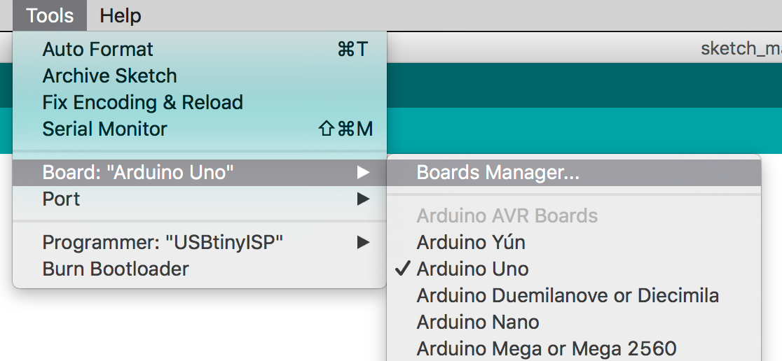

To get specific, navigate to the menu item Tools-> Board:(board name)-> Boards Manager. Allow a moment for the boards manager to download its index, then start typing "ESP8266" into the search bar.
When you see "esp8266 by ESP8266 Community," you can stop typing in the search and click "Install" to get the latest boards package installed inside your Arduino application.

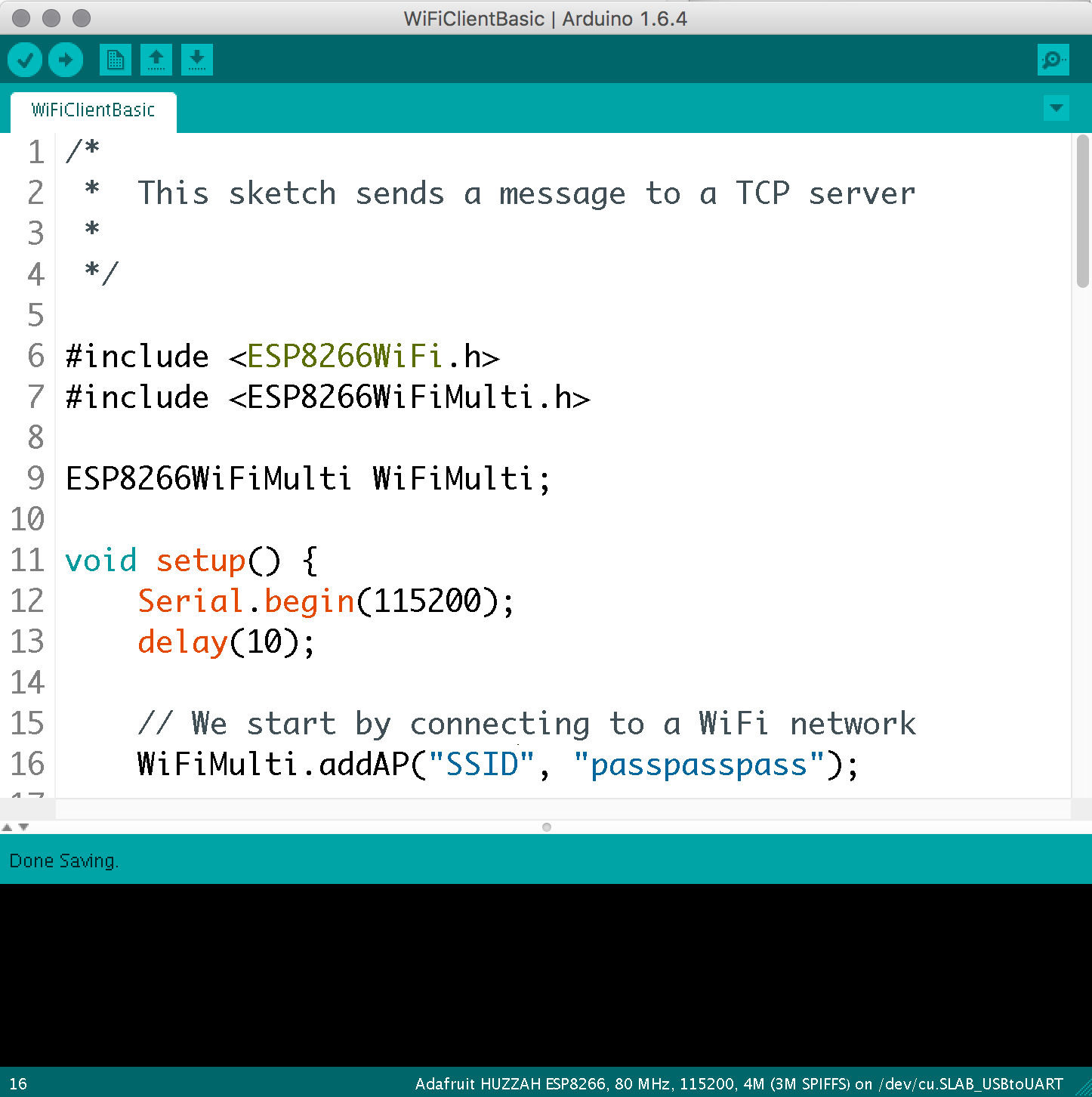

The next code example comes with the ESP8266 boards package and so is already available in your Arduino software. Access it by navigating to File -> Examples -> ESP8266WiFi -> WifiClientBasic. Alternatively, you can download the file attached to the end of this step and open it with your Arduino software. However if you don't see the example sketches in your software's menu, you are probably also missing the necessary library files to compile it— go back to the software setup step and double check you've installed the necessary boards package.
// We start by connecting to a WiFi network
WiFiMulti.addAP("SSID", "passpasspass");
Edit the variables describing the wireless network name(s) and password(s) ("SSID" and "passpasspass"). If your network has no password, leave the password argument empty ("") but do not omit it. Save the sketch and upload it to your board.

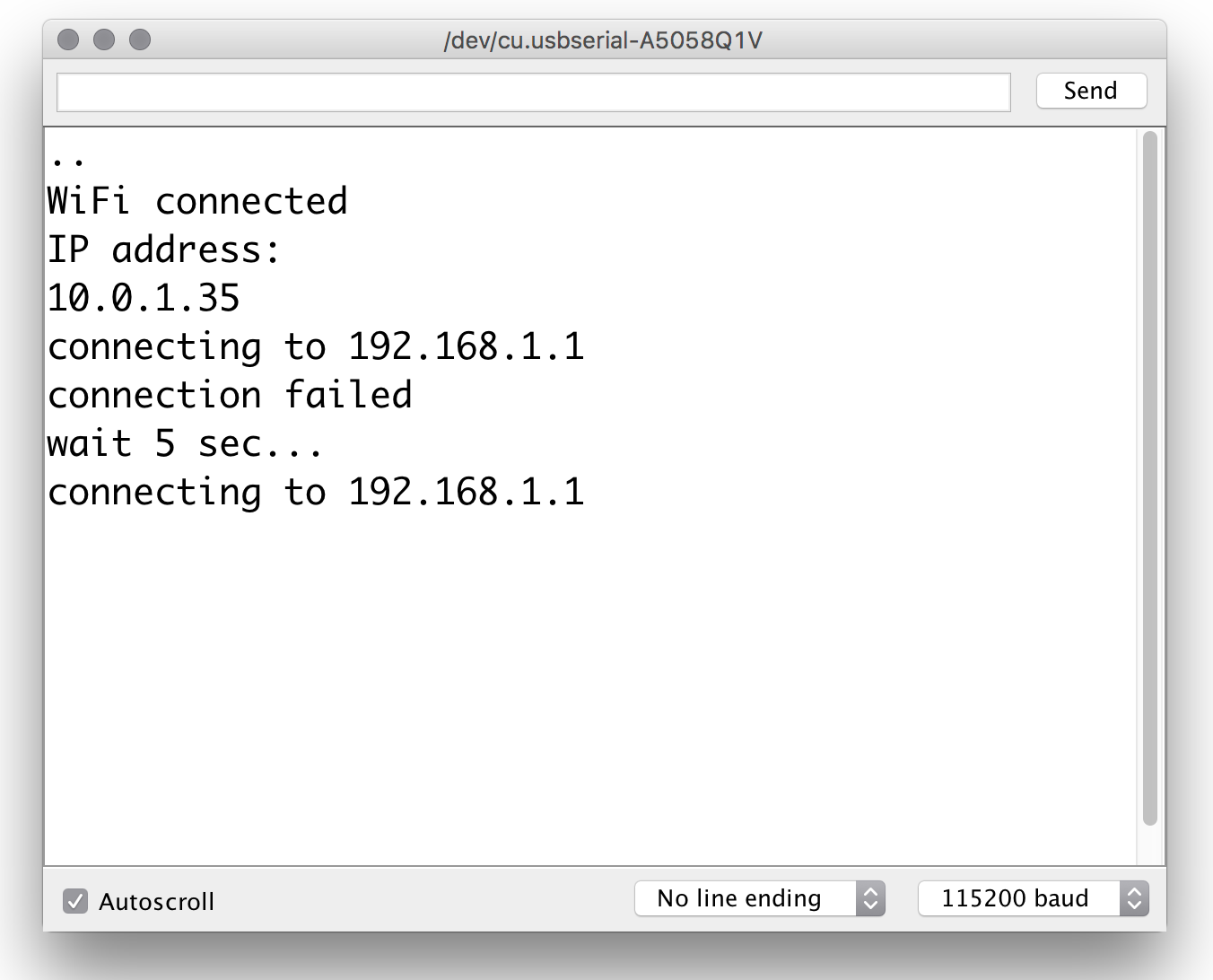

Click the button in the upper right of your Arduino window to launch the Serial Monitor, and select 115200 as the baud rate. Press the reset button on your Feather Huzzah to start its program from the beginning, and watch the wireless connection info appear in the Serial Monitor.
You should see a successful connection message followed by the IP address your device has been assigned. If you don't, double check your wifi credentials for typos and try again. If connected, you'll then see a message: "Trying to connect to 192.168.1.1"
Since 192.168.1.1 is a local network location that may or may not exist, the connection most likely fails.
Update the host variable to any site you like, such as "google.com" just to test your connection. Upload the new sketch to your board and open the Serial Monitor to see the different output. Congratulations, your board just talked to the Internet! We'll dive deeper into the code examples in the sample project lessons.

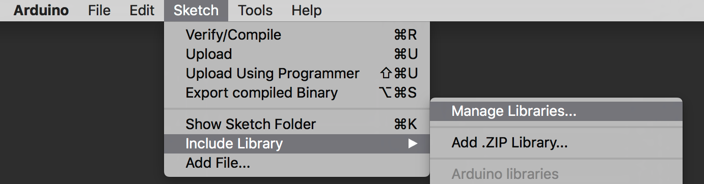

Now that you've got the basic ESP8266 setup working, let's install some additional Arduino libraries that will be used for later lessons. In your Arduino software, navigate to Sketch-> Include Library -> Manage Libraries..., then search for and install the latest versions of the following libraries:

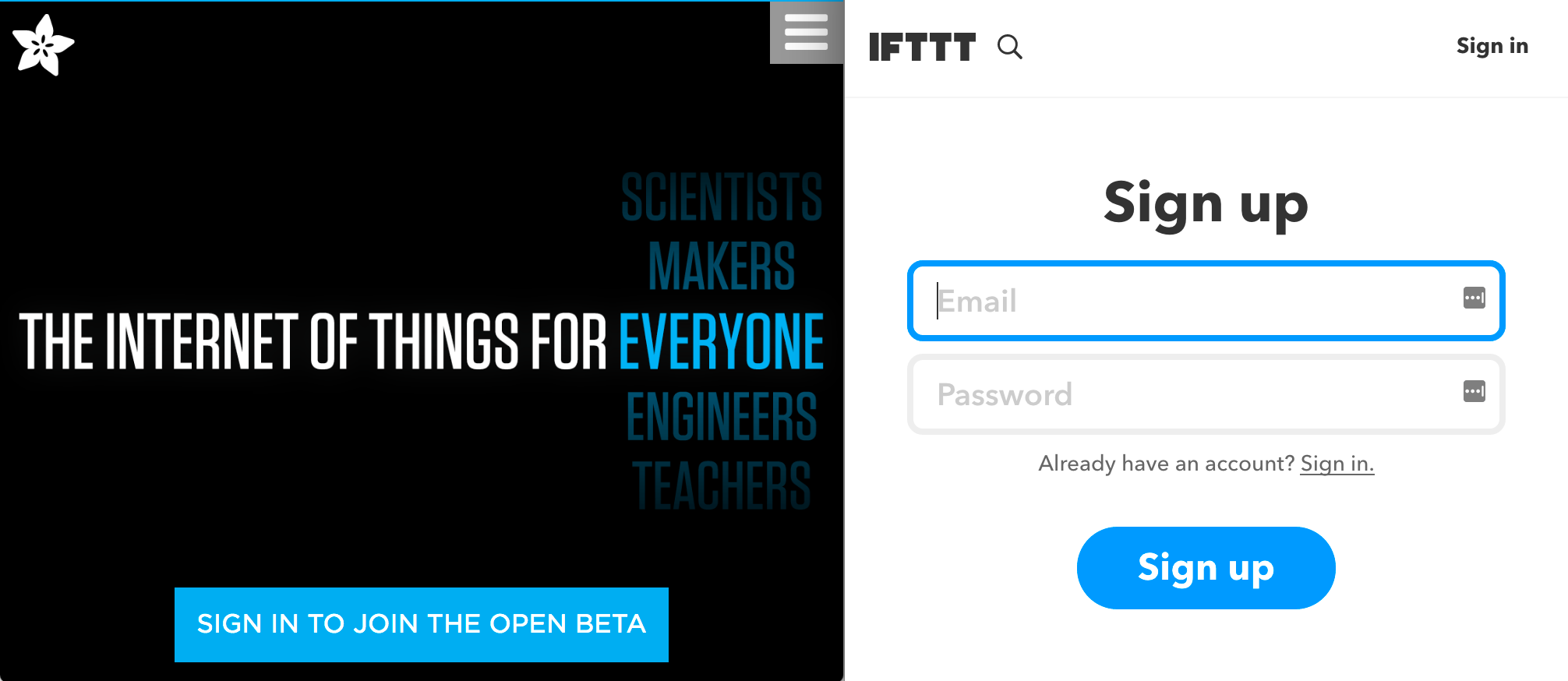

To complete the lessons in this class, you will need to create free accounts on two cloud service websites: Adafruit IO and IFTTT (If This Then That). Adafruit IO is a cloud data service that allows you to set up data streams called feeds to collect information coming from your DIY electronics projects. You can visualize and act on these feeds within Adafruit IO, or expand its function by linking it with IFTTT. IFTTT is a site that aggregates and provides an interface for a multitude of applications, and as such is called an API Gateway.
Head to io.adafruit.com and click "Sign In" then "Sign Up" to create an account.
You should use strong, unique passwords. You may be asked to confirm your email address.
On IFTTT.com, click the "Sign up" button to create an account.
I highly recommend enabling two-factor authentication on your IFTTT account, as you will most likely want to link it to your other personal accounts such as Twitter, Instagram, Fitbit, etc. Keep your accounts safe from hackers and spambots! You will also need to link your Adafruit and IFTTT accounts, which you can do through either site. While you're at it, install the IFTTT app, if you've got an iOS or Android device.
