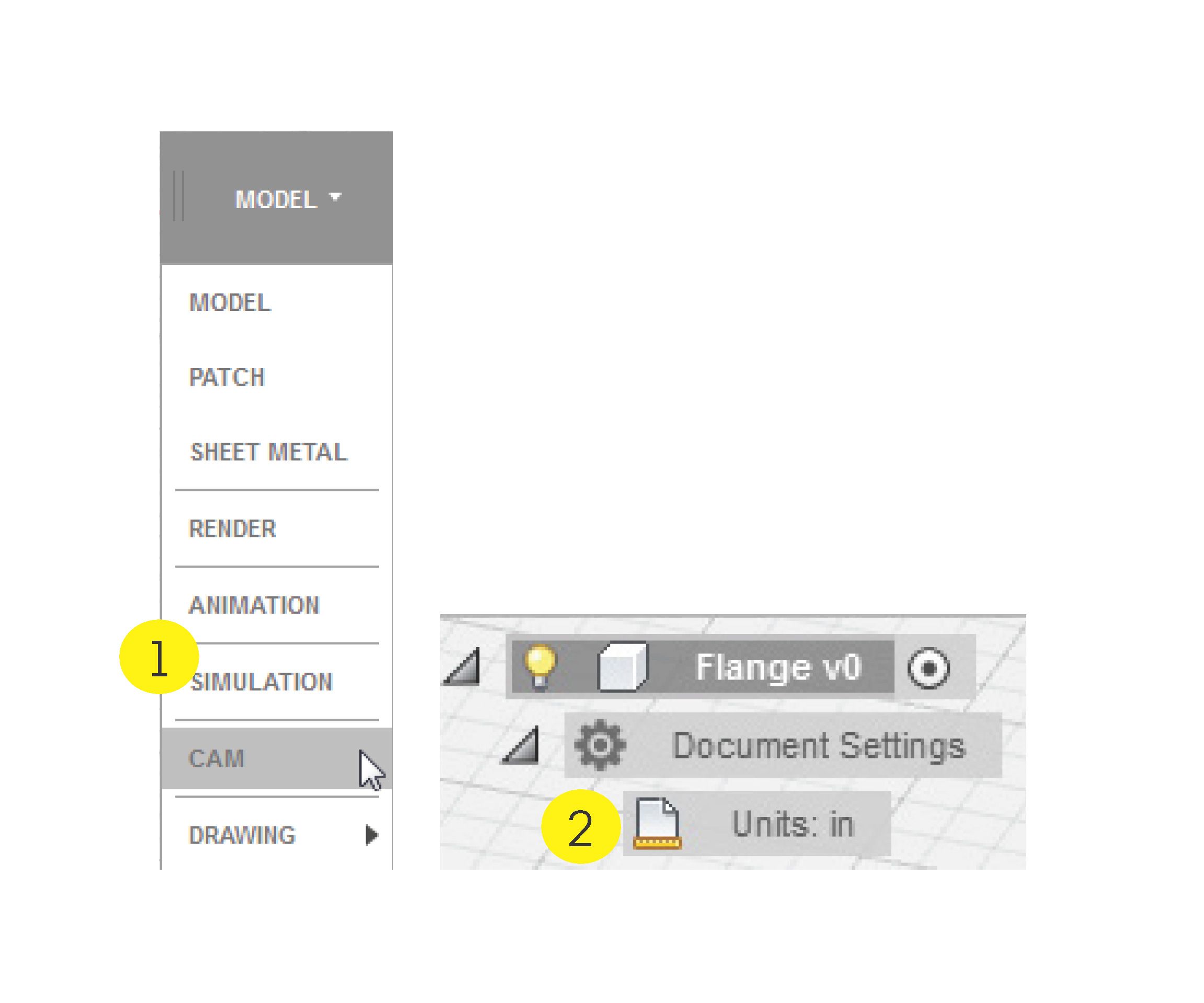

1. Go into CAM mode.
2. Check your units in the tree.
- Make sure you are working in the correct units.

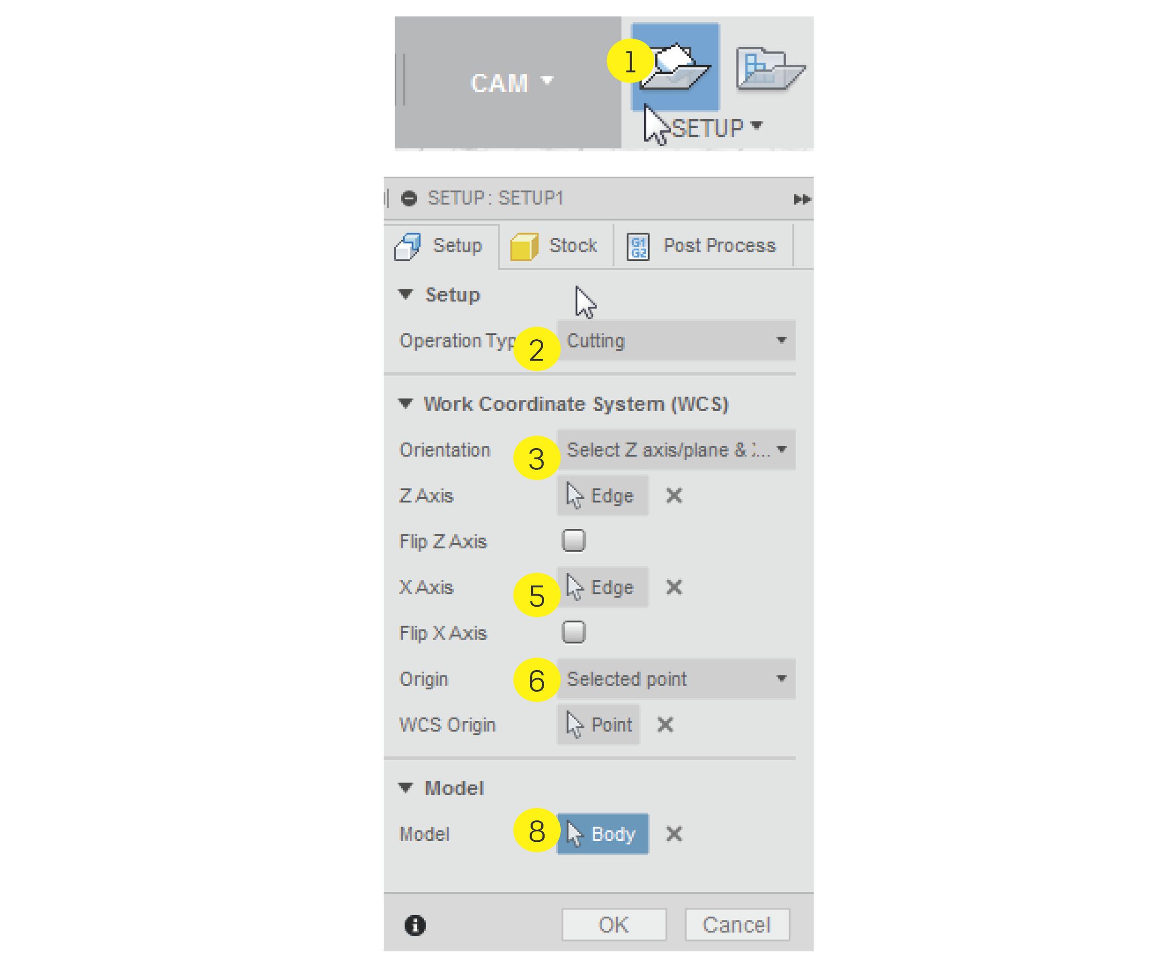

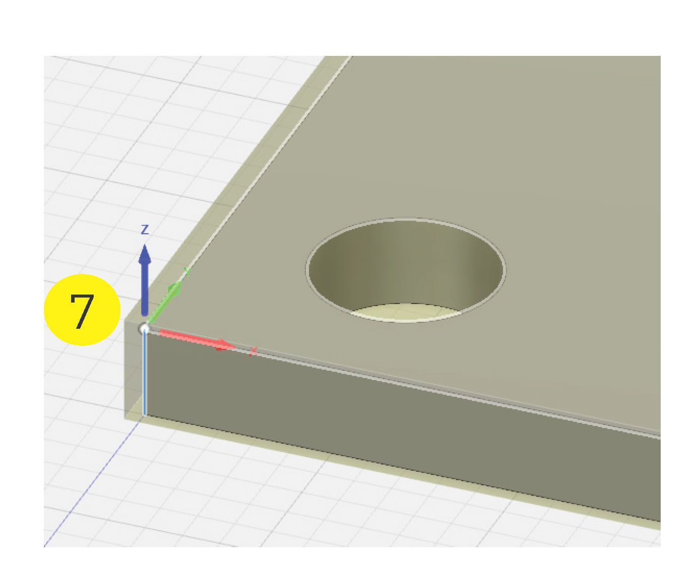

Step 2: Create a New Setup in Fusion 360
- Click the New Setup button.
- Select Cutting from the Operations Type menu in the Setup tab.
- Select Select Z axis/plane & X axis from the Orientation menu.
- You need to select the Z Axis.
- Click on the top plane of your part and ensure that the blue Z arrow is pointed up.
- The X axis arrow should be pointing to the right.
- Click the red x to flip the X axis if needed.
- Or you can select the Flip X Axis checkbox.
- Select Selected Point from the Origin menu.
- Click on the lower left point of your model.
- Double check that the Z arrow is up.
- The X arrow should be to the right.
- Click the top plane of the model.
- The Model menu should change to Body and the top of the model should be blue to show that it has been selected.
- Double check that the model looks like it will cut correctly.

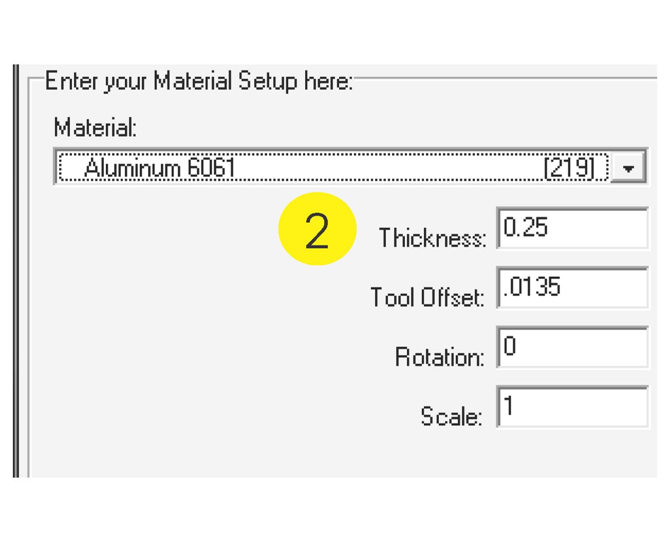

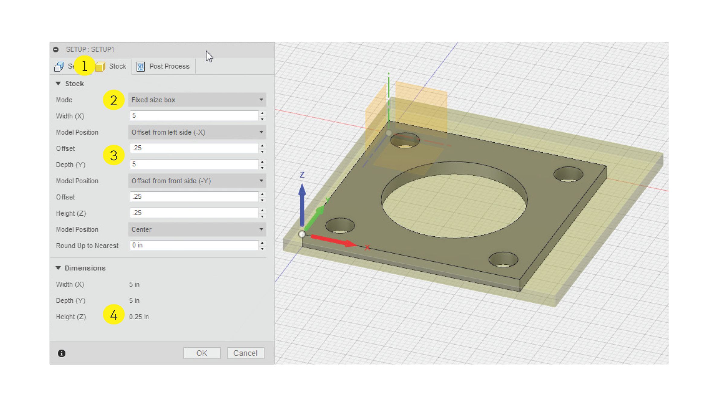

Step 3: Define the Stock in Fusion 360
Input the stock size
1. Click the Stock tab.
2. In the Mode menu, select Fixed size box.
In the next steps, you'll enter the size of the stock, and how far from the edge your part is. Be sure to set Z (material thickness).
3. Set the stock dimensions and the position.
- In this example, the stock is 5" wide and the part starts .25" from the left edge.
- The stock is 5" high and the part is offset .25" from the bottom.
- The stock thickness is .25" and there is no offset; the part completely fills the height of the stock.
4. Check that the stock thickness is correctly displayed at the bottom of the dialog box and click OK.

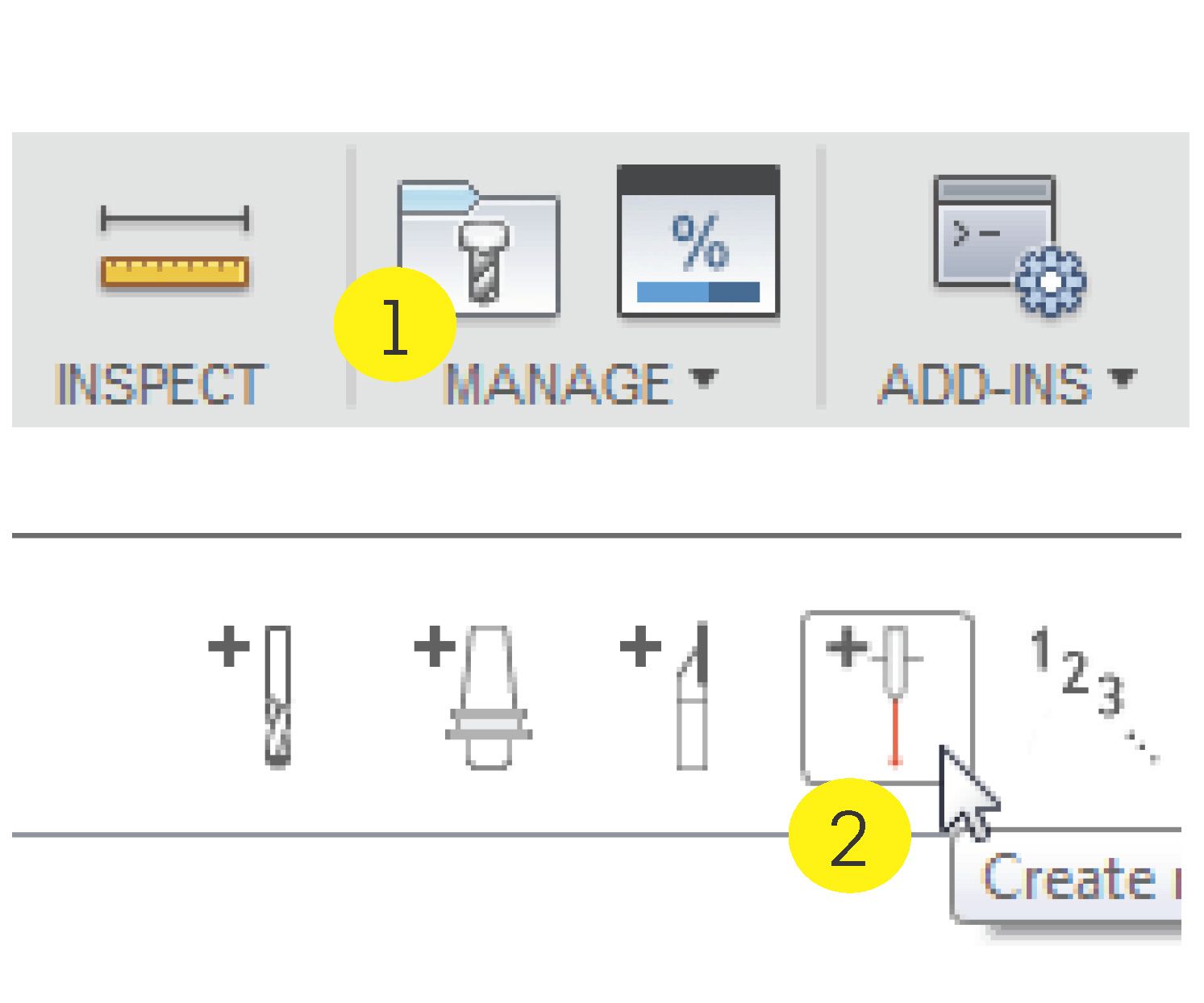

Step 4: Tool Libraries in Fusion 360
ADD THE WATERJET TO THE TOOL LIBRARY
In order to select the waterjet as a cutting tool, you'll need to add it to your tool library in Fusion 360.

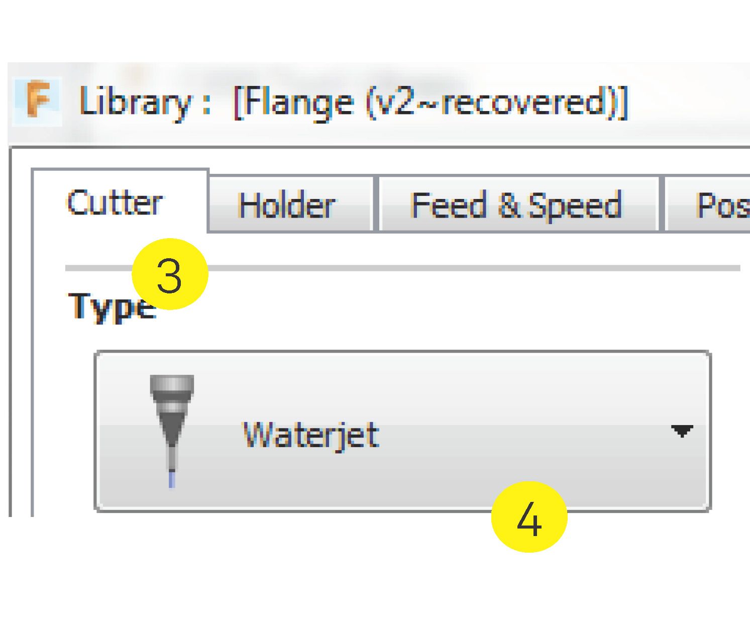

- Click the Manage Tool Library button.
- Click the Waterjet/Laser cutter icon in the upper right.
- Click the Cutter tab.

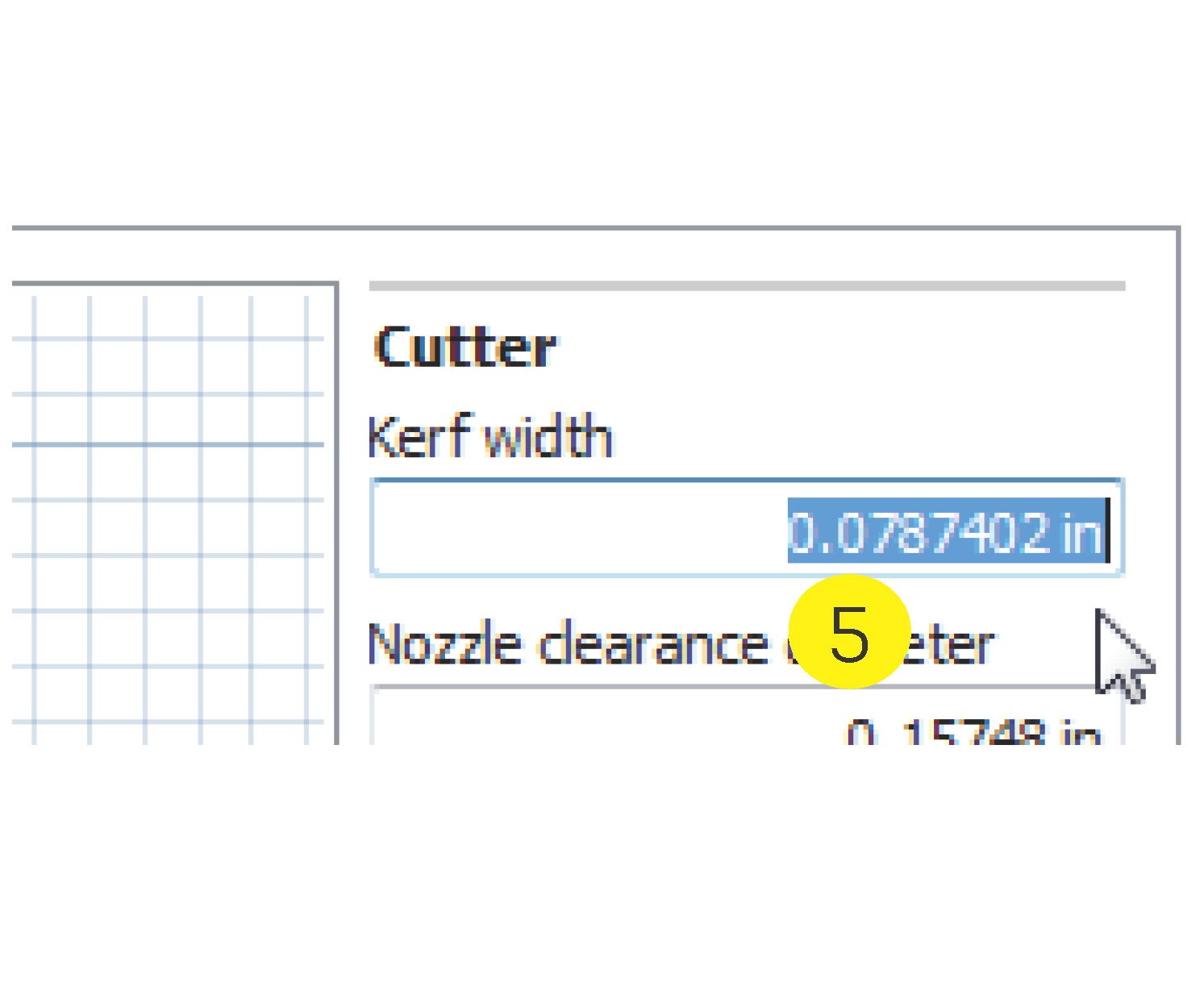

- Select Waterjet in the Type field on the left.
- Enter the Kerf Width on the right.
- The Kerf Width is equal to the diameter of the nozzle.
- It is noted on a sticker on the control computer.

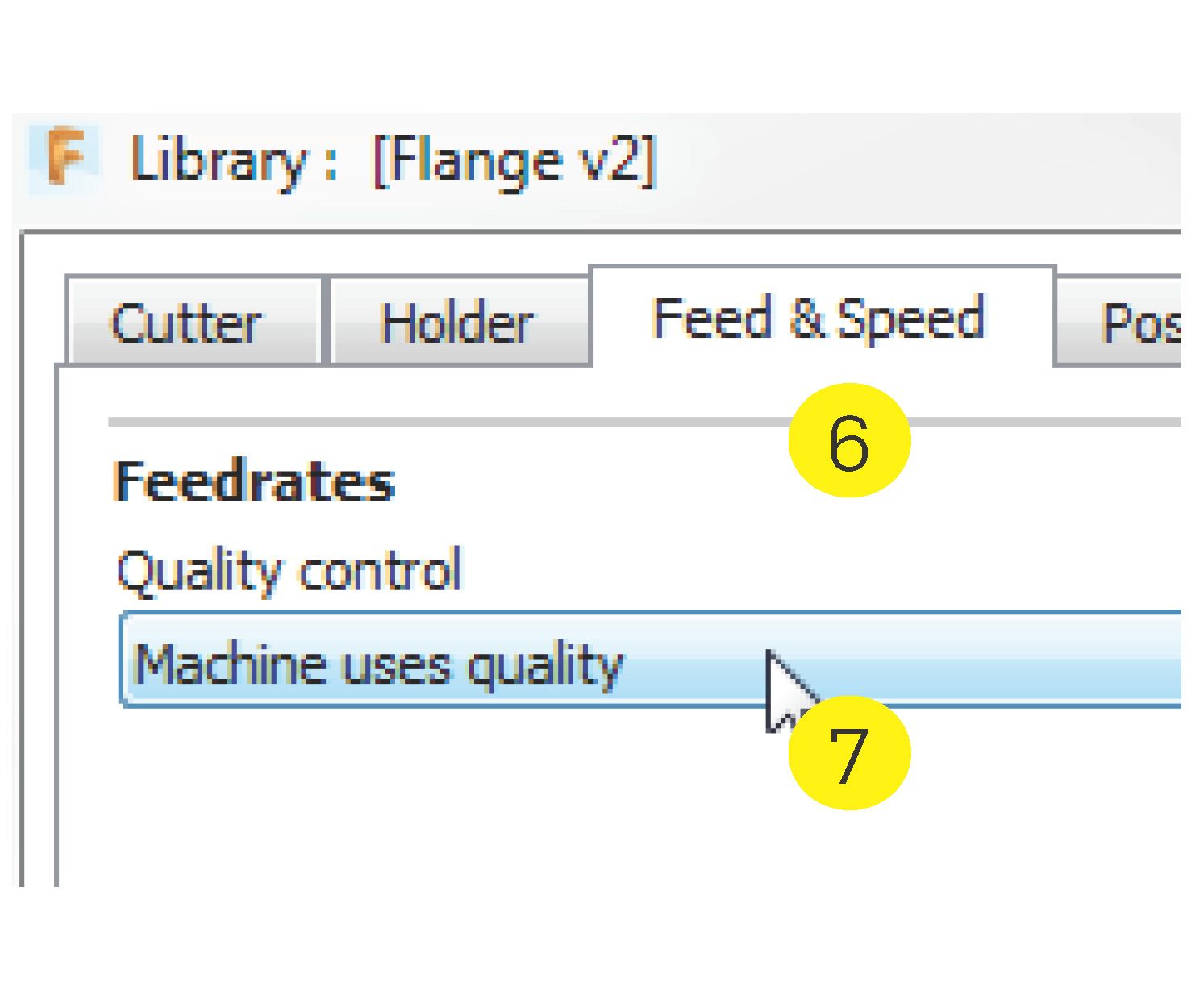

- Click the Feed & Speed tab
- Select Machine uses quality in the Feedrates menu.
- Click OK.
- Close the Tool Library window

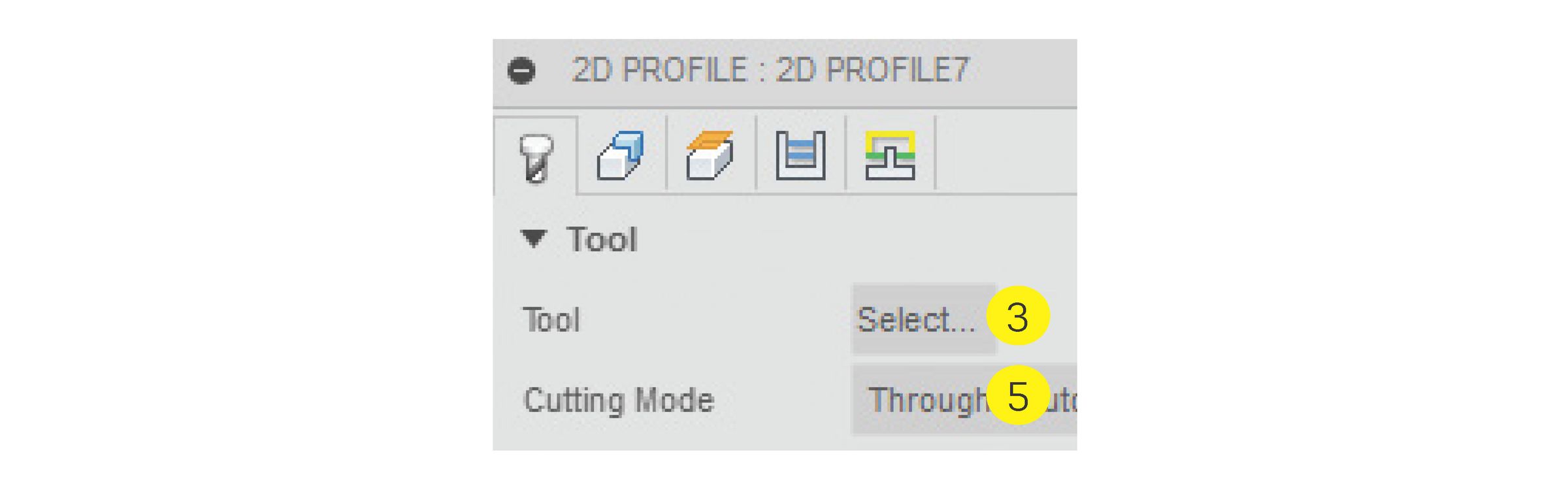

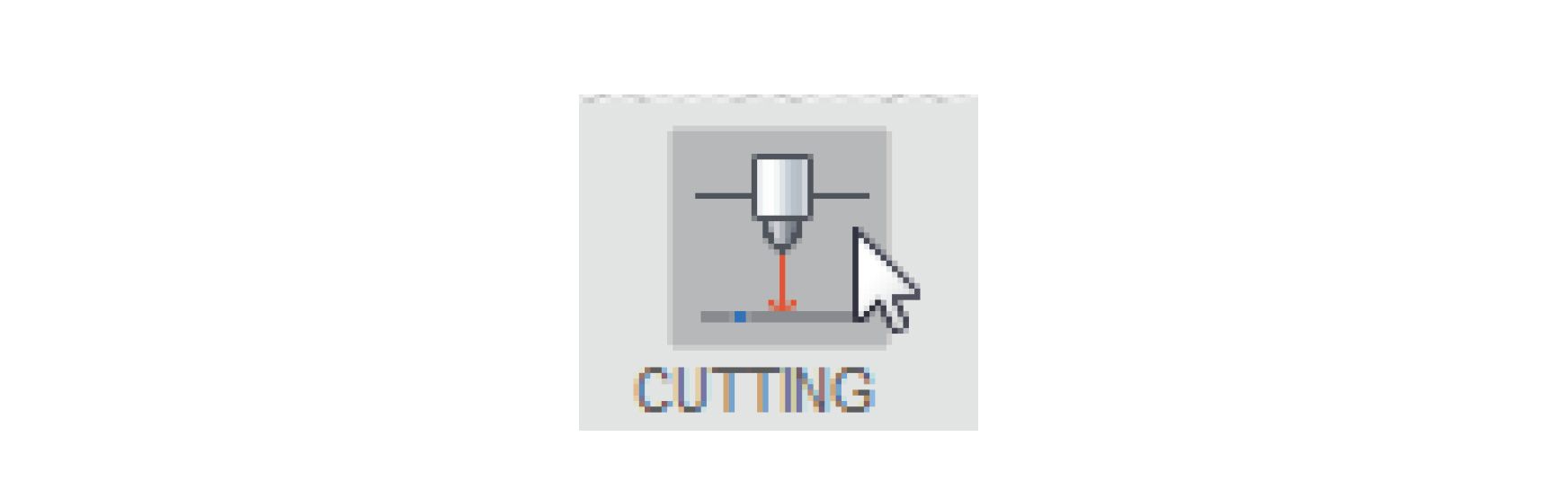

Click the CUTTING button
Select the tool
- Click the Tool tab.
- Click the Tool button to select a tool.
- Select Waterjet In the dialog that opens and click OK.
- Select the desired quality in the Cutting Mode box.

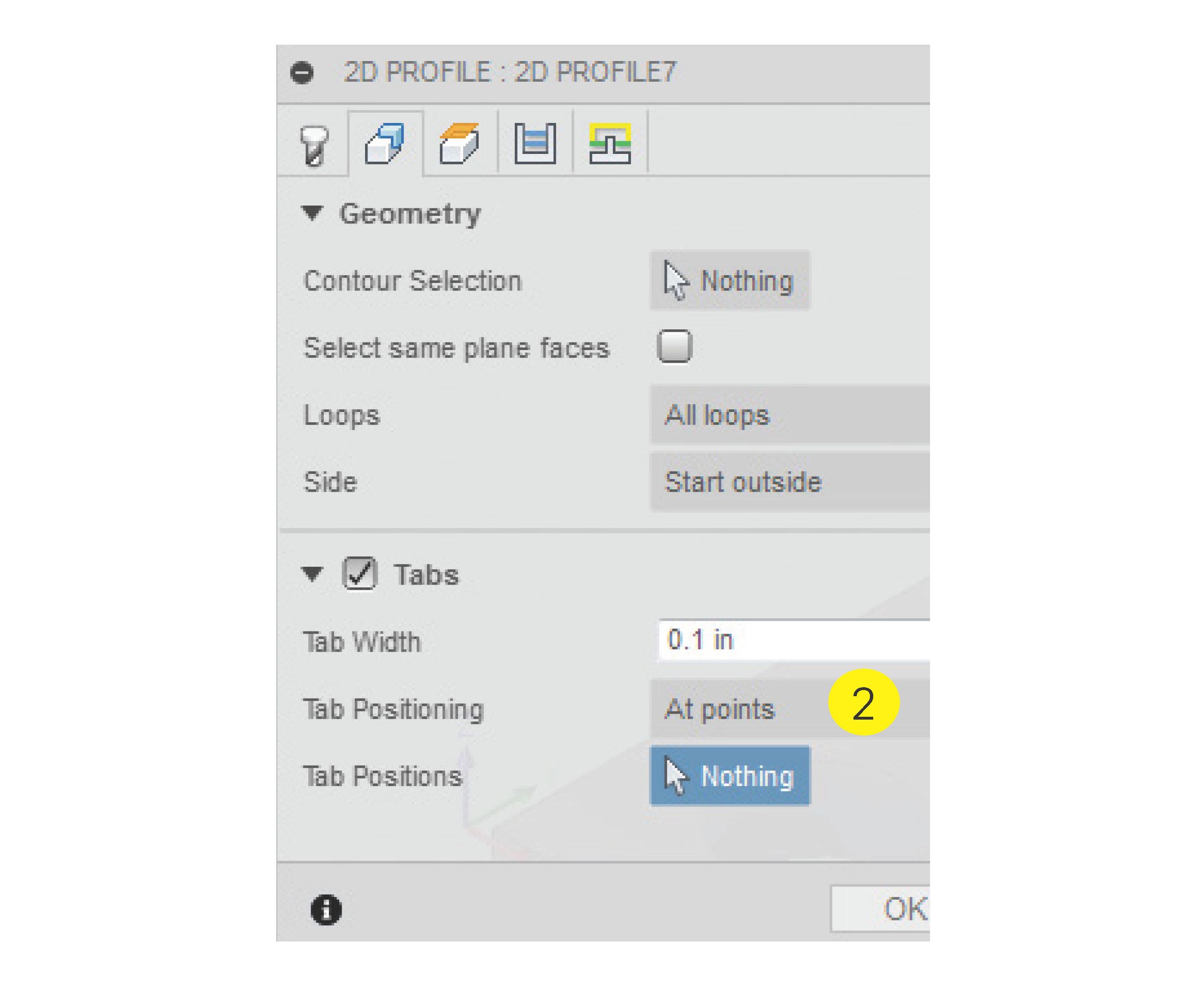

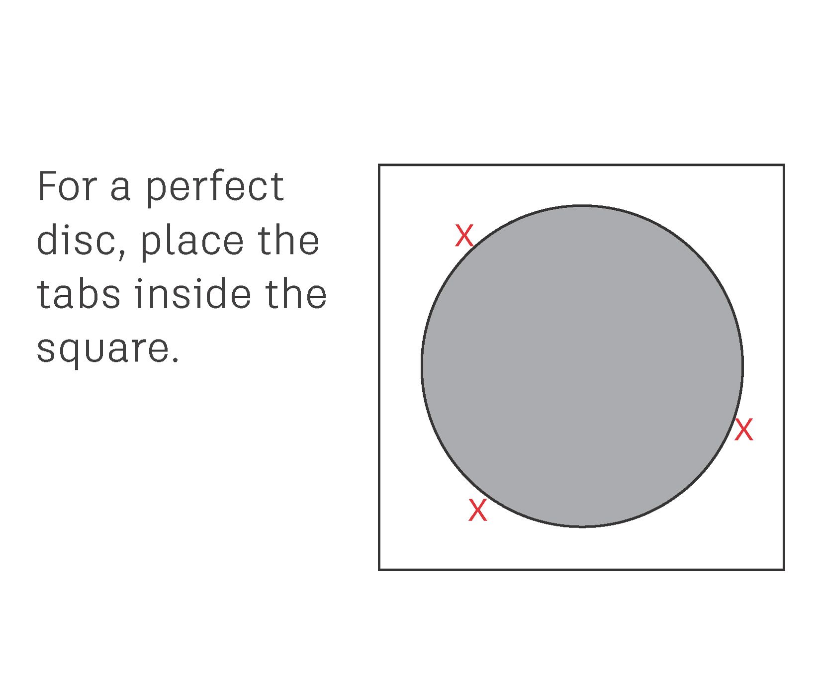

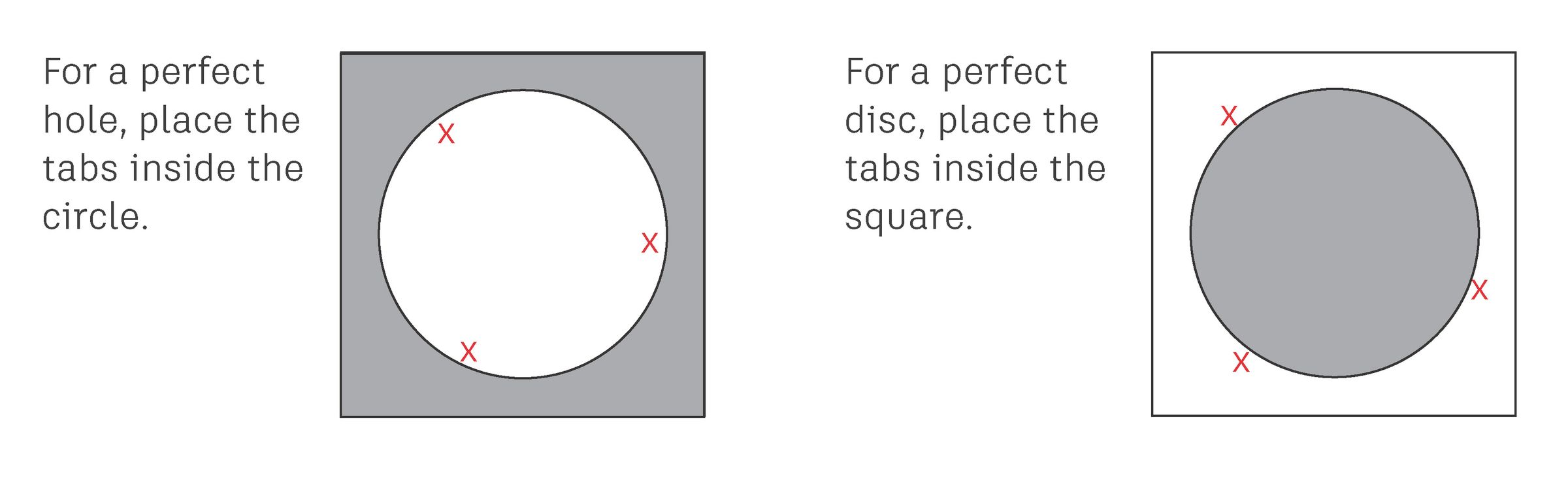

Tabs
Tabs are short gaps that don’t get cut, in order to keep small parts attached to the workpiece. The tabs prevent the piece from moving during the cut or falling into the tank.
- Click the Tabs checkbox.
- Select At points in the Tab Positioning box.
- Click to place tabs.
- Usually two or three tabs will keep a piece from moving.
- Place the tab in an area that will make it easy to remove, such as on a straight section. A tab in a tight corner may be difficult to remove.
- Be sure to place the tab on the waste side of the part.

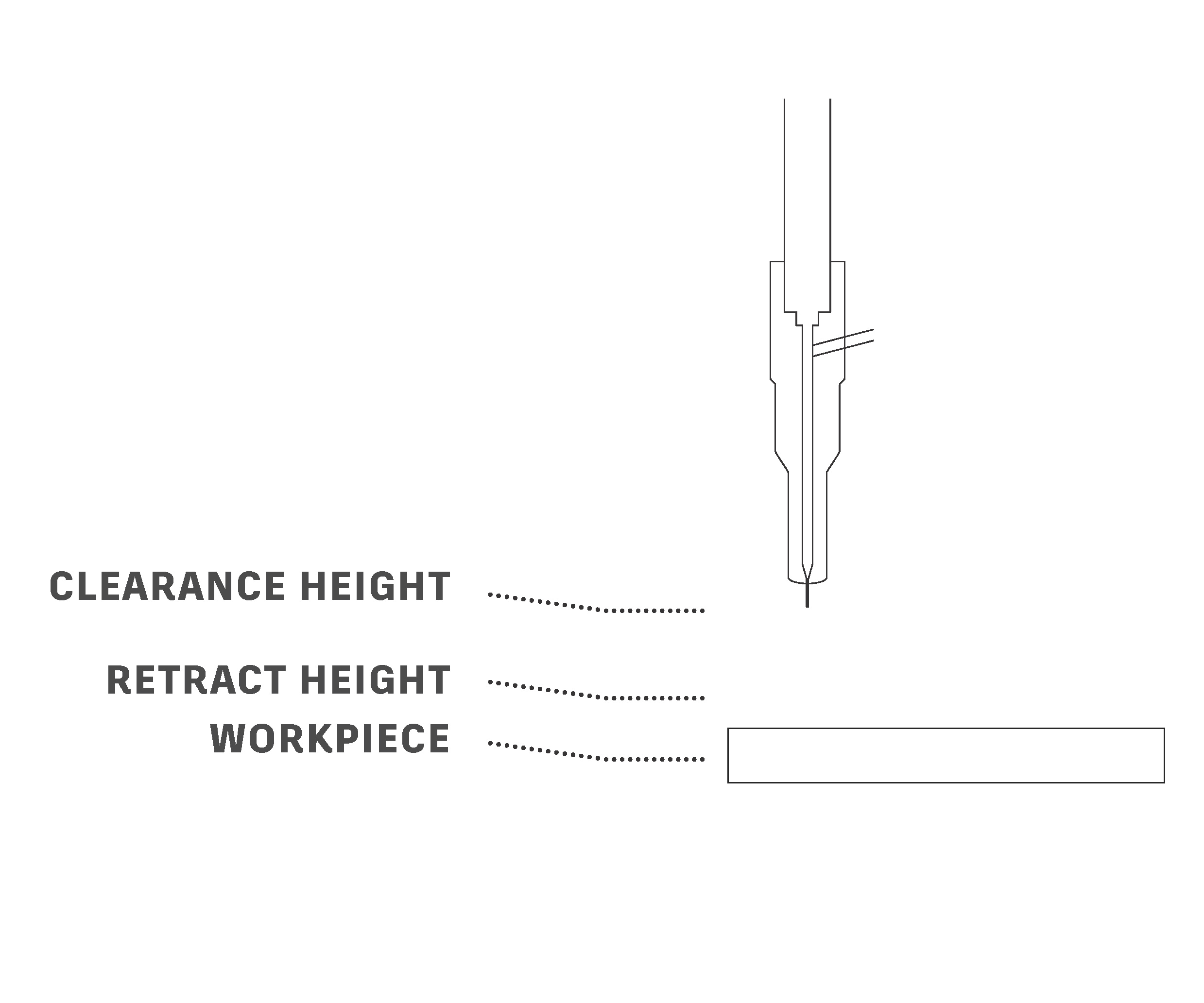

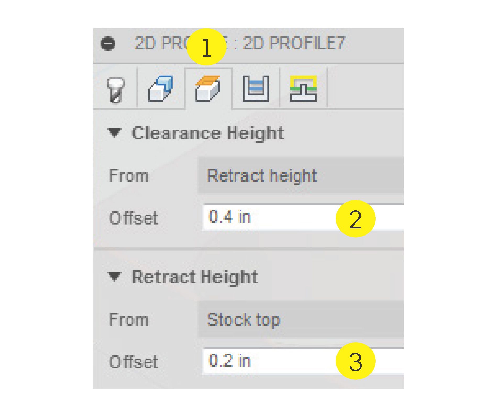

Heights
USE SAFE HEIGHTS TO AVOID BREAKING THE NOZZLE.
Setting the height of the nozzle helps to keep from breaking it on clamps and other objects. Make sure you set the nozzle high enough to protect it.
You will need to set the height for two different things
- Clearance Height
- The distance above the workpiece at the start of a new toolpath.
- Make sure this is high enough to avoid clamps.
- Retract Height
- The distance above the workpiece when the nozzle is moving between cuts (also known as a traverse).
- Click the Heights tab.
- Set the Clearance Height.
- By default, this is added to the Retract Height.
- For example, if your Retract Height is 0.5" a 1" Clearance Height will give 1.5" of clearance.
- Set the Retract Height.
- By default, this will be measured from the top of the workpiece.

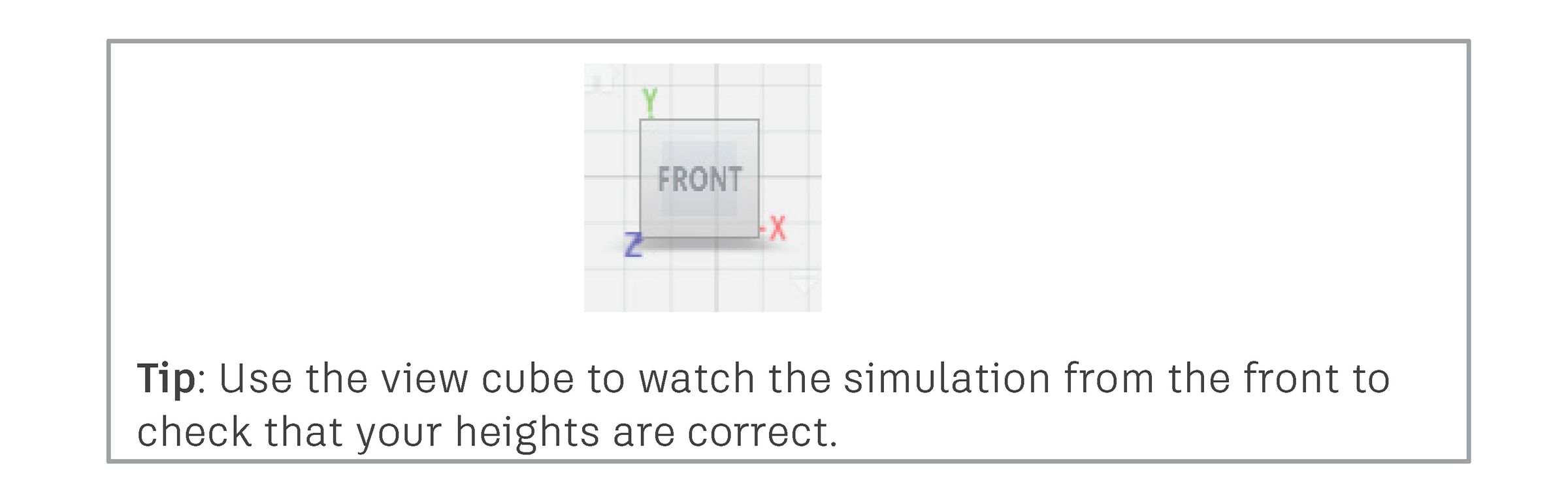

Step 6: Simulation and Post in Fusion 360
SIMULATE THE CUT

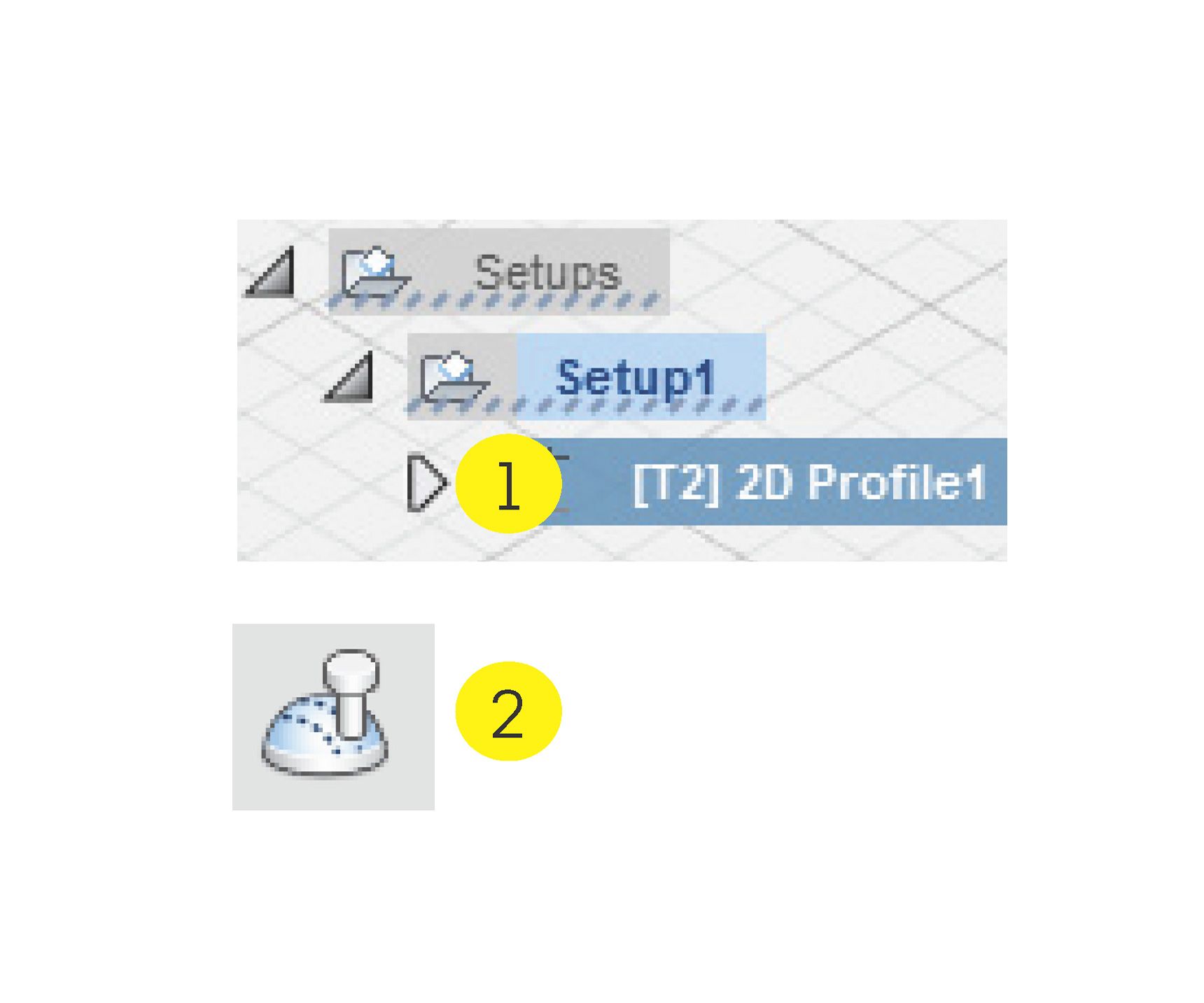

Simulating the toolpath will allow you to check for errors and collisions.
- Select the part by clicking the 2D Profile in the tree.
- Click the Simulate button.
- Use the controls at the bottom to run the simulation.

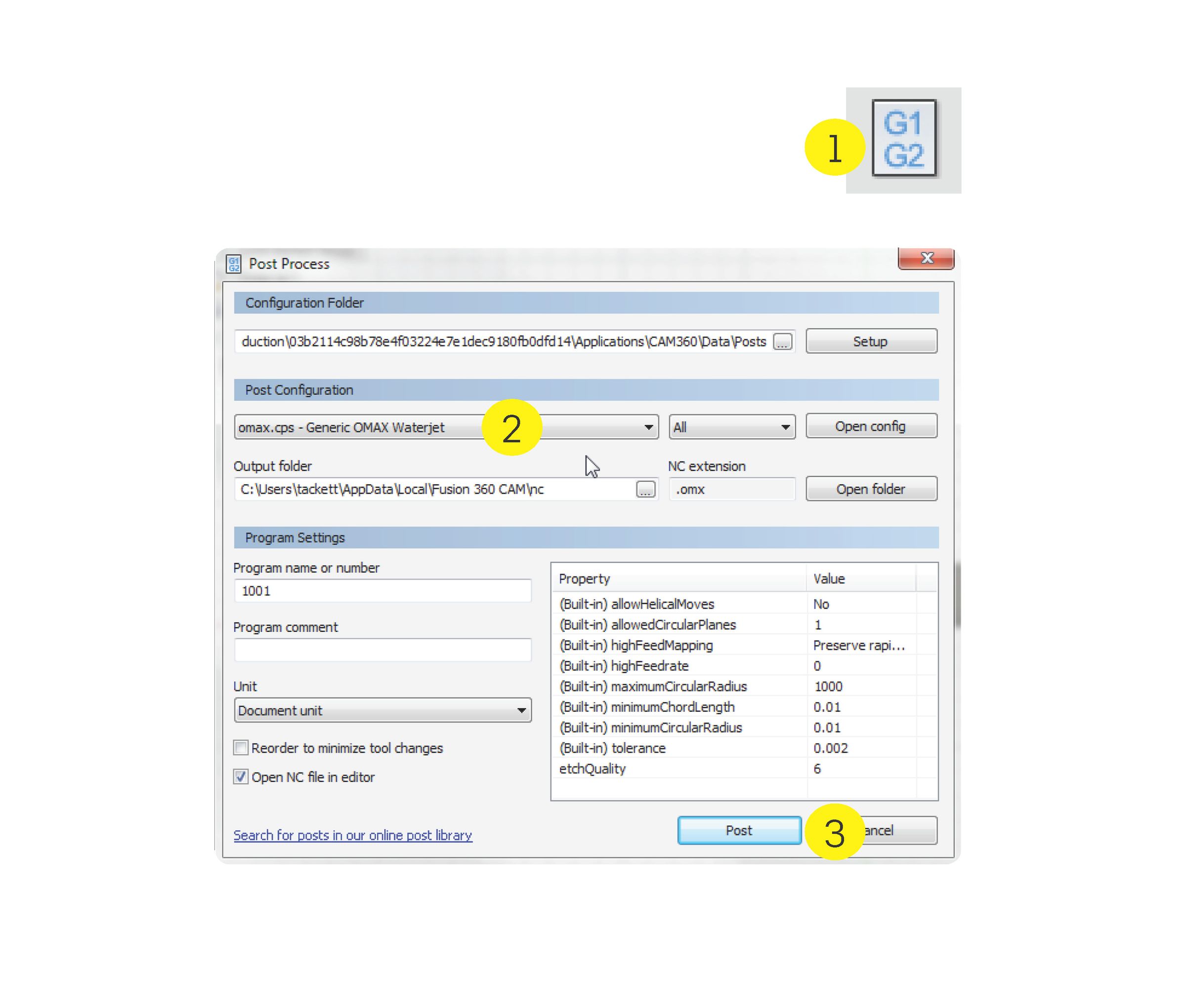

POST PROCESS
The post-processor will write the machine instructions for the Omax, and save the le.
- Click the Post Process button.
- Select Omax from the Post Configuration menu.
- Click Post.
- Name and save the le to a thumb drive.

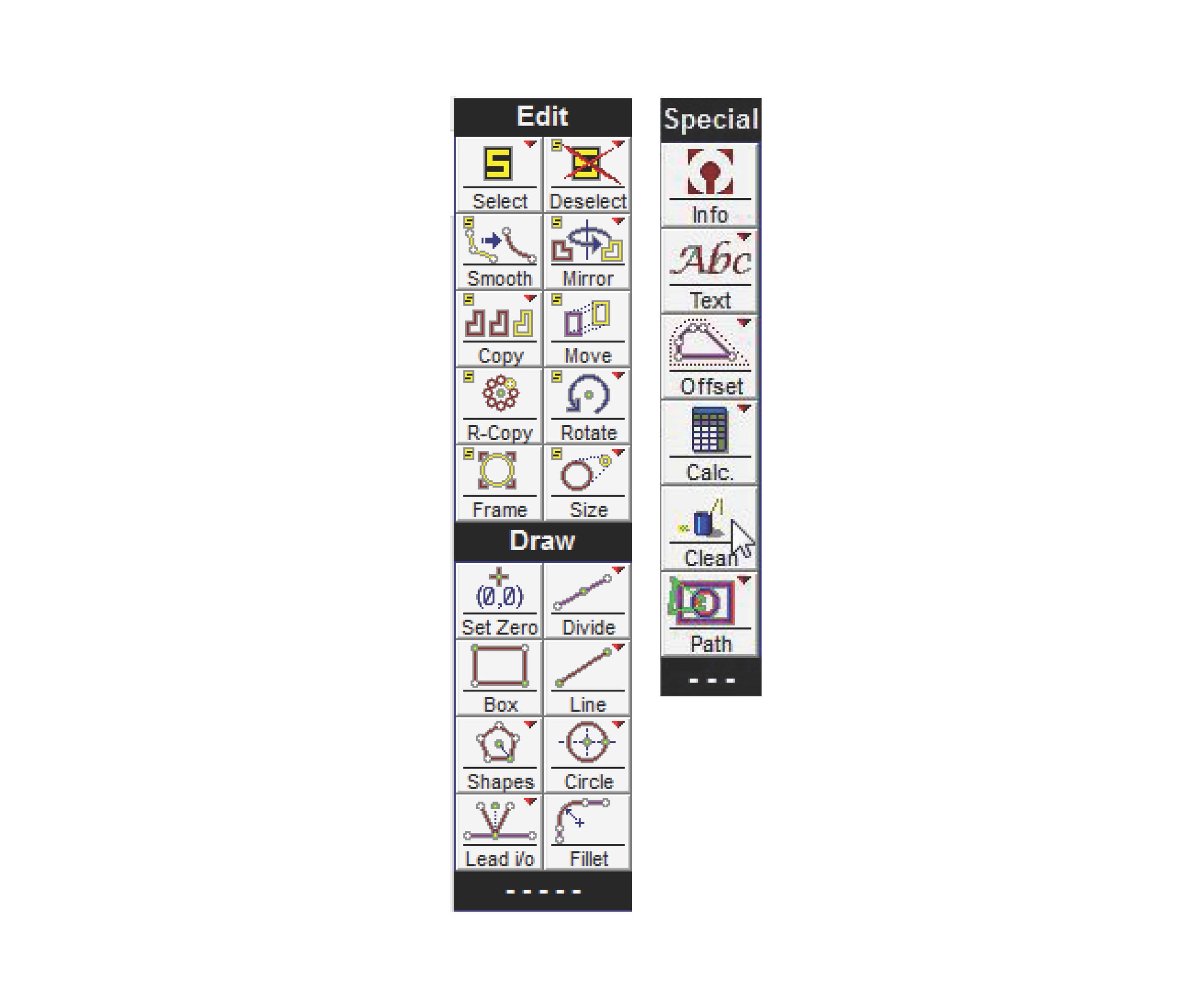

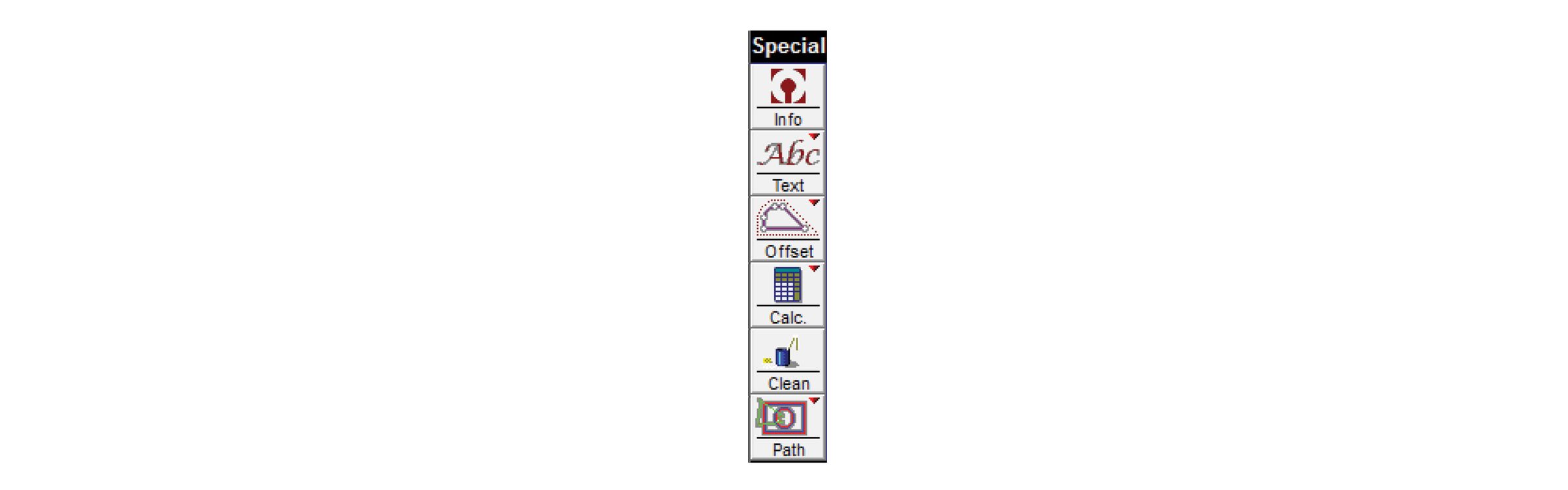

MENUS
There are menus at the left, right and bottom of the screen, in addition to the standard menus at the top.
- Edit
- The Edit menu is on the left side of the screen, and has options for selecting, moving, copying, etc.
- Draw
- The Draw menu is directly below the Edit menu. It can be used to draw primitive shapes. However, it's much more simple to draw in CAD, Illustrator or other vector software.
- Special
- The Special menu is on the right side of the screen, and is used for toolpaths and cleaning the vector file.
- View
- The view menu is at the bottom of the screen, and has options for cut quality, undo and measuring.

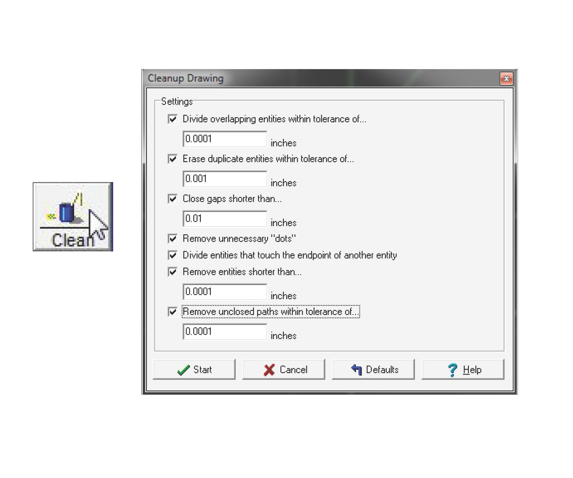

Clean the geometry
Some vector files are imported with errors, such as gaps or duplicates. This step will solve most of the problems.
- Click the Clean button in the Special menu on the right side.
- Select all the boxes in the dialog box.
- The Remove unclosed paths checkbox can be left unchecked if you have geometry with open ends (a line instead of a loop).
- Click Start.

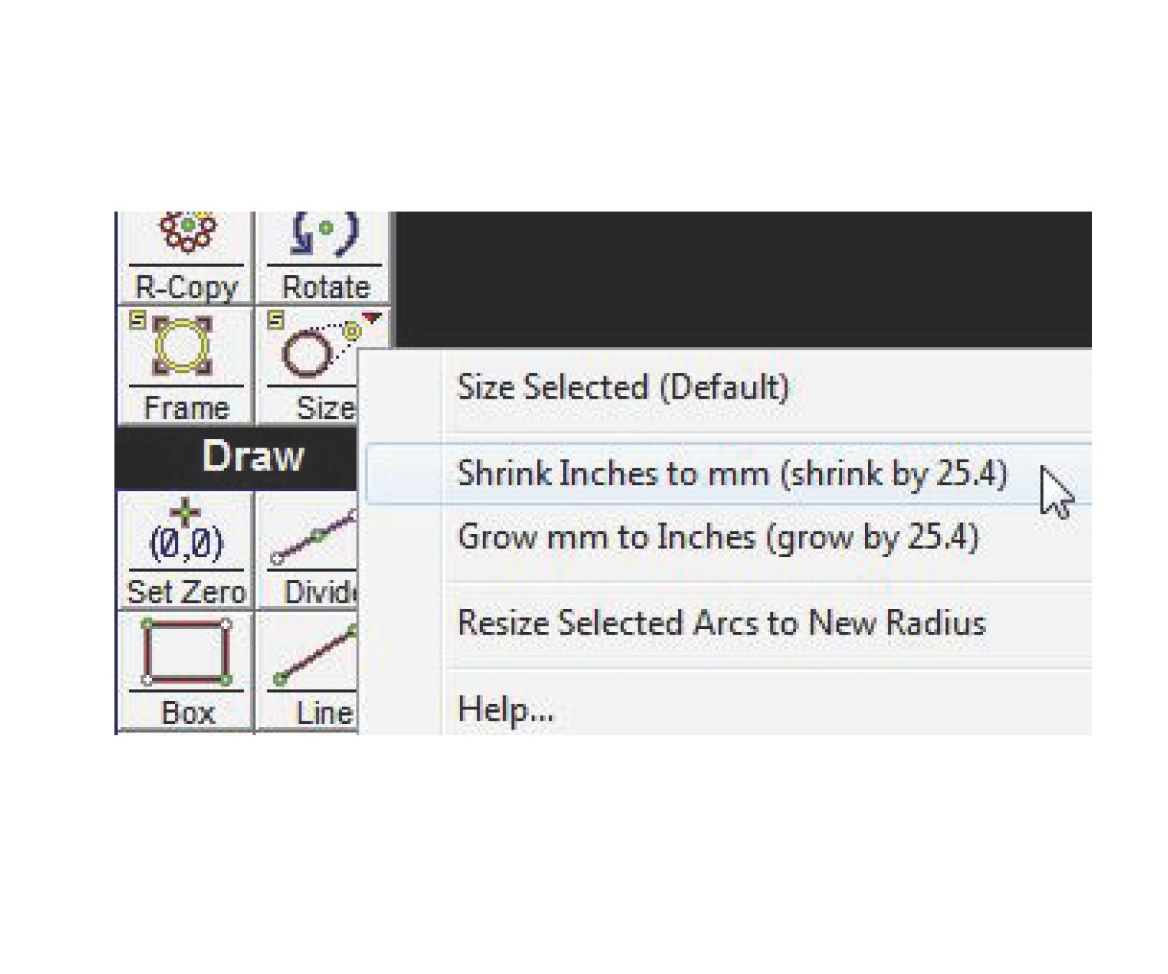

Check the size
Sometimes drawings are imported with incorrect units. Since each square in the grid represents an inch, it's simple to check if your vector file was imported with the correct units.
Change the size if needed

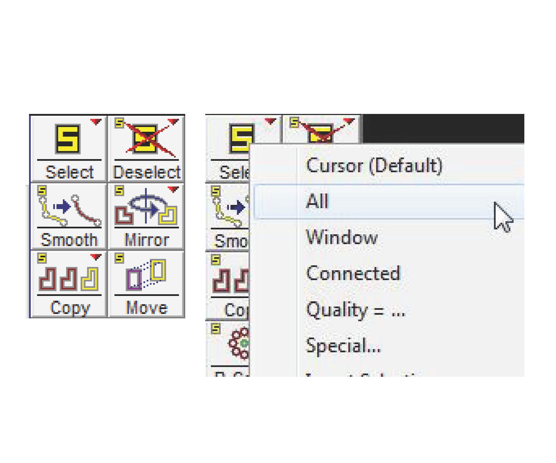

- Right-click the Select button, and choose All.
- Right-click the Size button for sizing options.

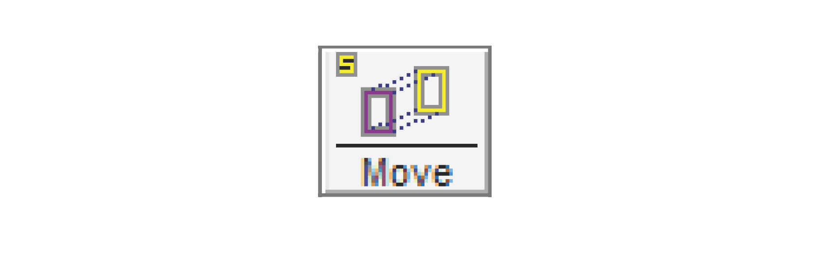

- Click the Move button in the Edit menu.
- Click the geometry to select a start point.
- Move the geometry until it is inside the grid, and close to the lower left corner (home).
- Right-click Deselect in the Edit menu, and select All.
- If the geometry is yellow, it is still selected.

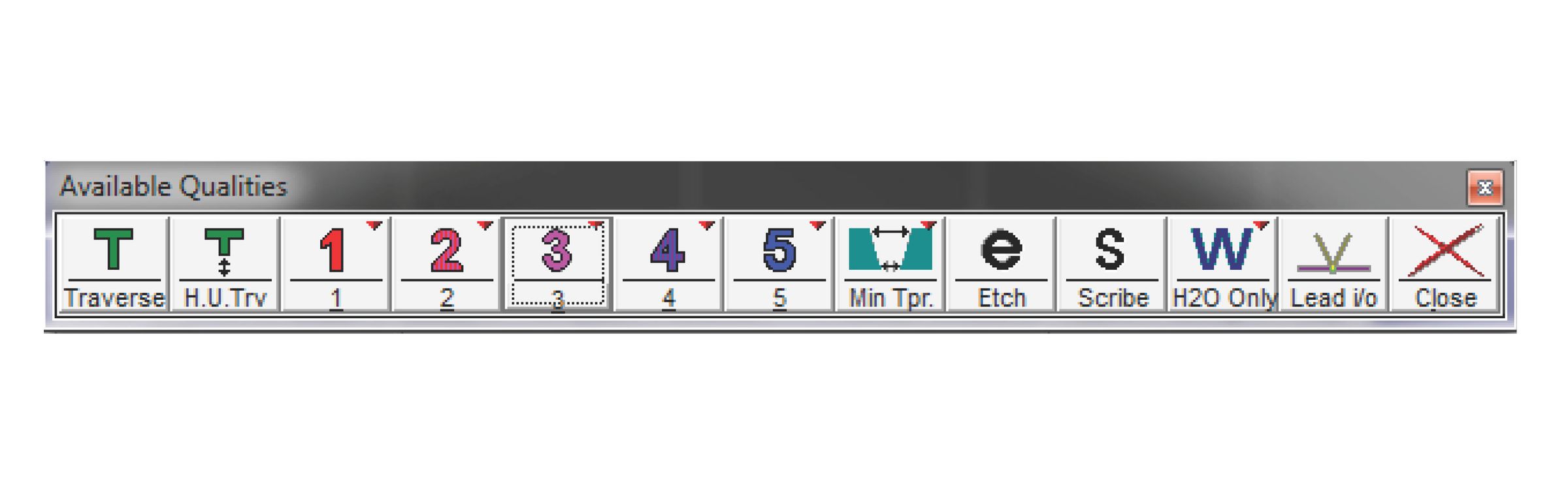

You will need to assign a type or value to every line in your geometry. The quality of the cut can be assigned a value from 1 (lowest quality) to 5 (highest quality). Lower quality cuts will take less time and use less garnet, but produce a rougher cut. Each quality is represented by a different color on-screen. Other colors represent different types of lines.
Each line in your drawing will need to be assigned one of the values from below.
- Quality (1-5)
- Quality 3 is a good compromise of speed vs. quality for most cuts.
- Thicker material shows the effects of a low-quality cut more than thin material.

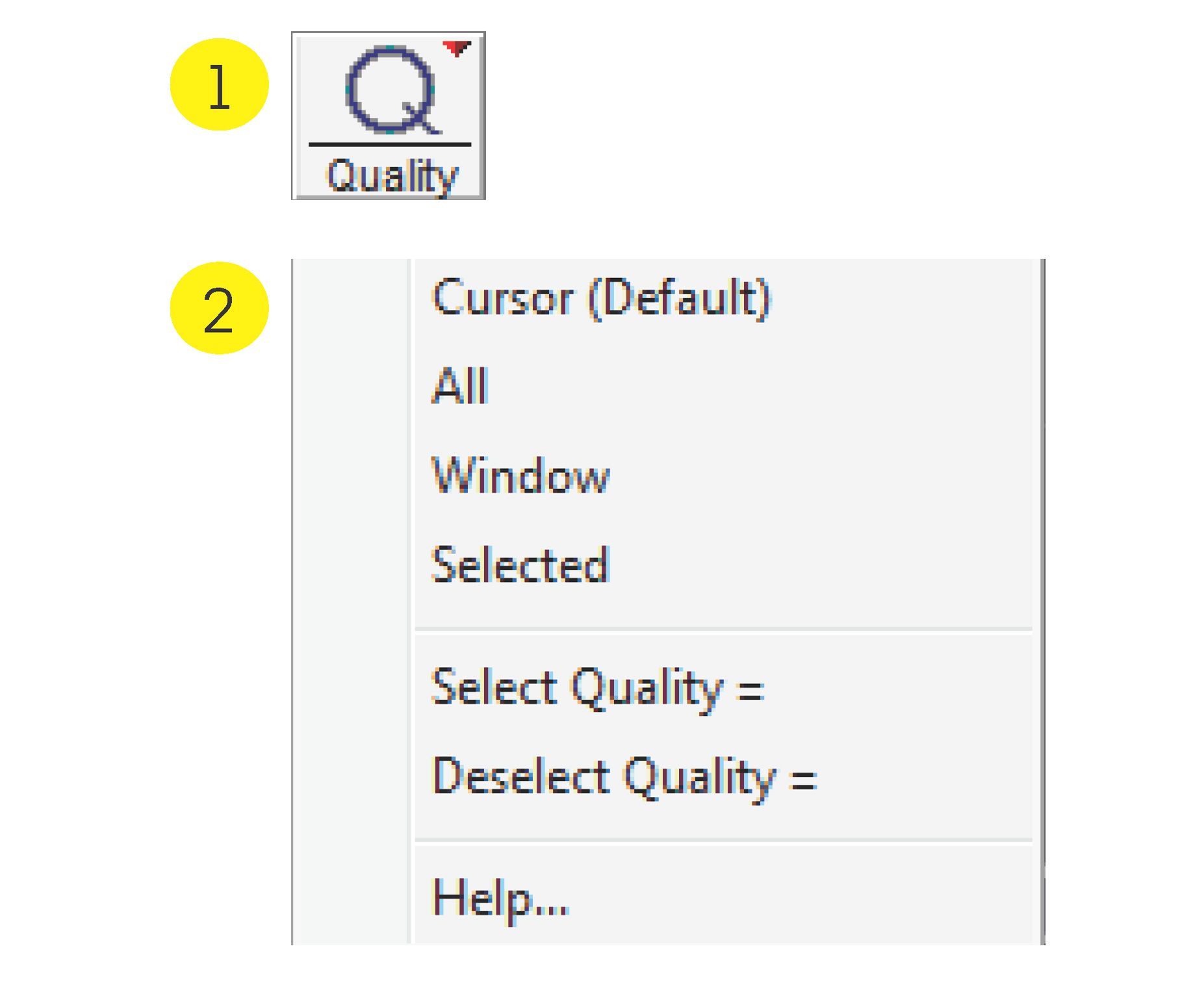

Set line quality
The menu on the bottom of the screen allows you to assign a quality to each line.
- Right-click Quality to bring up the submenu.
- Choose your selection method.
- This works like the Select button.
- Choose the quality level for the selected lines.
- For the 5 levels of cutting, you can right-click and select slit, which is a cut directly on the line, rather than offset to one side.
- This will show the line quality color.

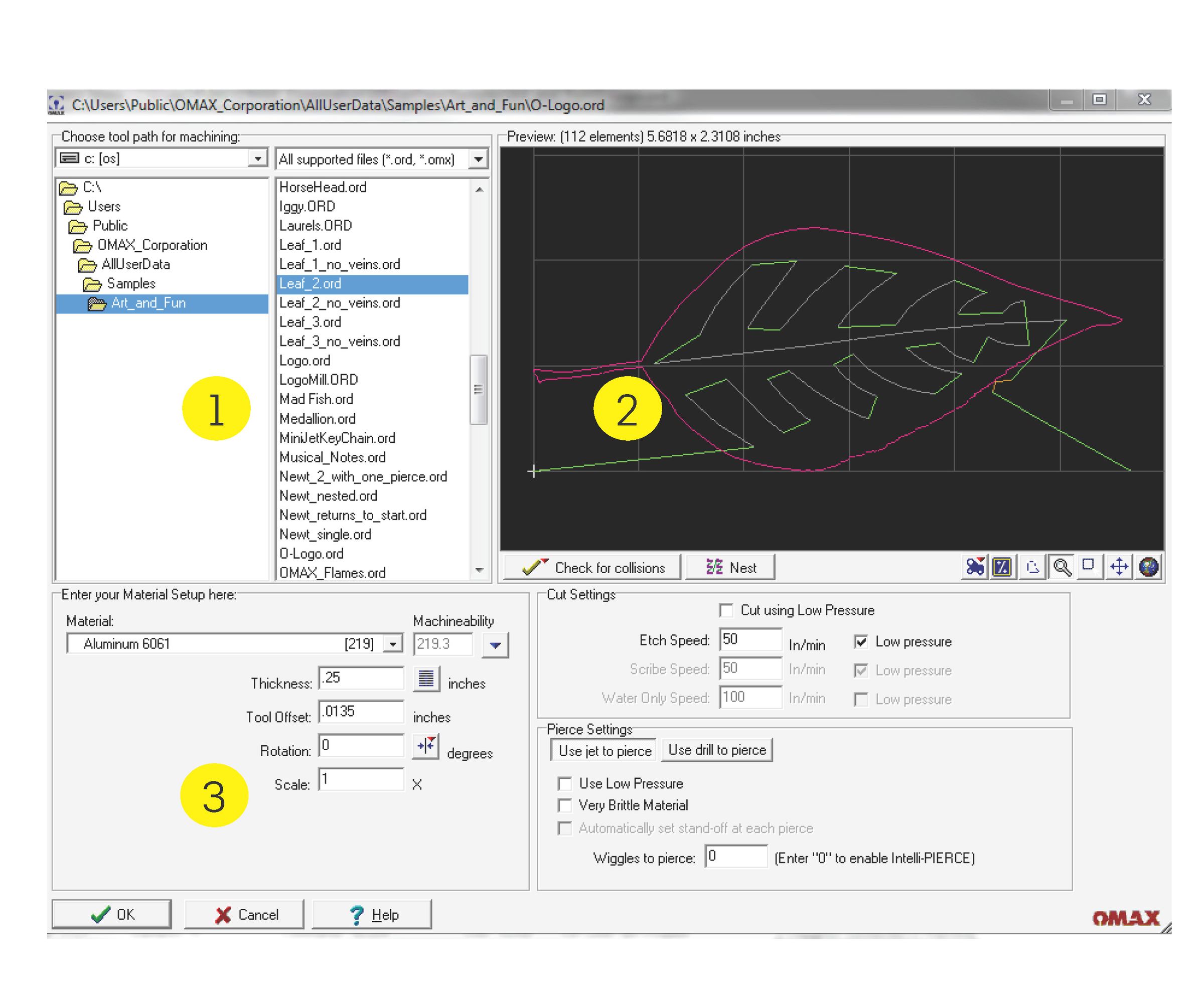

Make the Lead In/Lead Out lines
- Right-click Lead i/o from the Draw menu.
- Select AutoPath (Advanced & Configure)... from the sub-menu.
- The left side of the window allows you to select tool path options.
- The right side displays your file and toolpath.
On occasion, a small cutoff piece can flip up and come in contact with the head. Choosing a toolpath that has fewer possible collisions is best practice. In some cases, it may be required to create custom Lead i/o lines. See Shop Staff.
The start and end of the toolpath can be changed by selecting any of the 9 green (start) or red (stop) buttons.
- It is common to start the toolpath in the lower left corner.
Click Go! to save your settings.

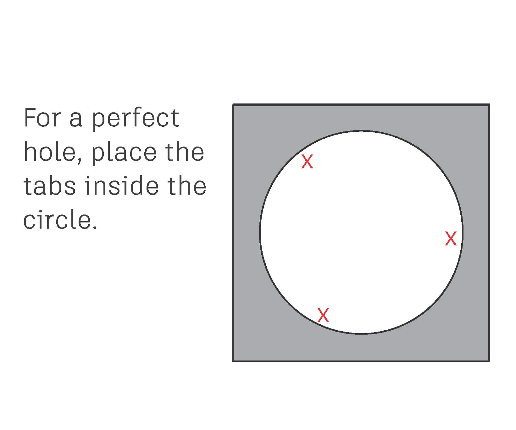

Tabs
- Select Create Tab from the submenu.
- As your mouse approaches a cut line, the tab will jump to the line.
- Click to place the tab.
- Usually, two or three tabs will keep a piece from moving.

If the toolpath is cutting on the wrong side of the line, there are two common possibilities:
- There’s a gap in the geometry.
- Follow the toolpath by eye and look for a gap where the toolpath doubles back on itself.
- Fix the gap with the provided tools and re-create the toolpath.
- The software chose the incorrect side to cut on.
- Right-click the Lead i/o button and select Swap Lead Direction.
- Click to select the lead in line to be swapped.
- Recreate the toolpath.

Step 12: Using OMAX Make
- Open Omax Make from the desktop.
- Select File > Open (Change Path Setup)...
Opening a part with Omax Make
The Open File dialog box has three panels you should pay close attention to.
- File Navigation
- File Preview
- Material Settings
Open the part
- Use the File Navigation Panel to open your ORD file.
- Confirm you have selected the correct file with the preview.

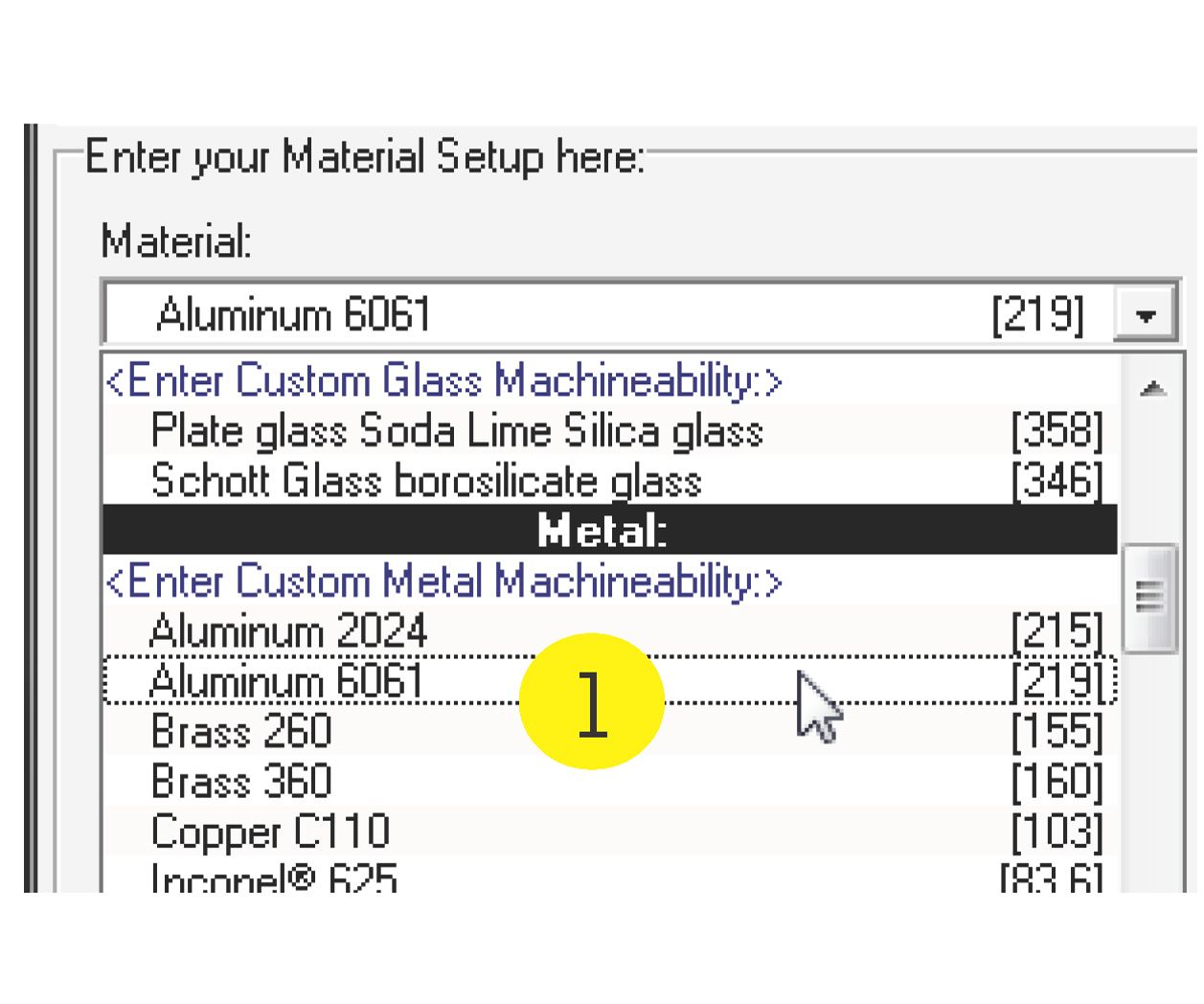

Select your material
- Select your material from the list.
- Materials are listed by category (metals, woods, plastics...).
- If your exact material is not on the list, see Shop Staff.
Set the material thickness
- Use a digital caliper to measure the thickness of the material.
- Enter the value in decimal inches.
- Click OK.
The software is now ready to control the waterjet and cut your parts.
Notes on increasing the accuracy of the cut:
As the mixing tube wears, the kerf will grow larger. If your parts need to be held to a tight tolerance, you may need to adjust the Tool Offset.
Cut a 1" square from your material and measure it with calipers or a micrometer. If it is undersized, increase the value in the Tool Offset eld by 1/2 the error.
For example, if your 1.000" circle measures 0.998", increase the tool offset by 0.001".
