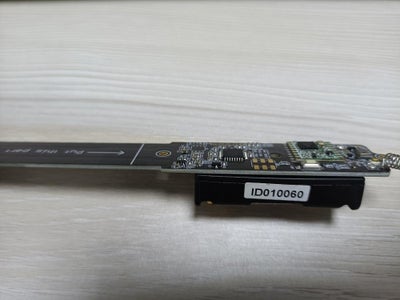

The Makerfabs Soil Moisture Sensor measures the soil humidity (with capacitive mechanism, detailed info ) & temperature and sends the data via LoRa every 1 hour. it is anti-corrosion coated. With a 2 AAA battery, the lifetime can be up to 2 years. It is shipped with pre-program firmware, which users can install the battery and then use directly. For more details, check the wiki. But note that for humidity, its output is “relative humidity”, which is not a “real humidity” but values reflect the humidity changes. Such as values < 500 mean the soil is soaked, while >800 mean very dry. Also, it differs a little depending on how the sensor is installed.

We use the simple LoRa soil moisture sensor, take the sensor from the package, and power the sensor with a 2 AAA battery. There is the sensor ID number on the battery slot (and also on the mechanic case), such as ID010040:

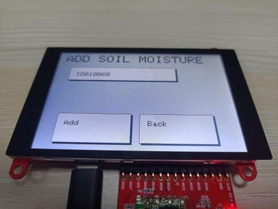

press the “add moisture button” in the ESP32 display, then you can input the ID.
As the setting is complete, the ESP32 display will get the LoRa message from the LoRa soil moisture sensor. As the sensor will output data every 1 hour, to validate the connection, press the “reset” button for an instant message.
The shows ADC data means the moisture sensor output, the lower the values are, the higher moisture, check the Typical Output. The sensor data and the time stamp show on the display, it will update every 1 hour. Actually, it will also add a log in the SD card for further checking.
There Max 8 LoRa moisture sensor can be added and monitored.
