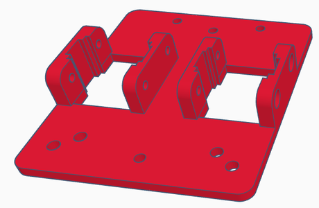

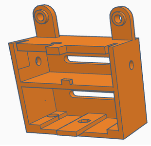

The attached '.stl' files will build the Sokoban robot but some modification may be needed if the components obtained don't quite match. The robot was designed on TinkerCAD and the published design can be found here and is available to copy, modify and download.
Four areas that will need a decision by the builder are:

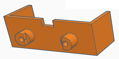

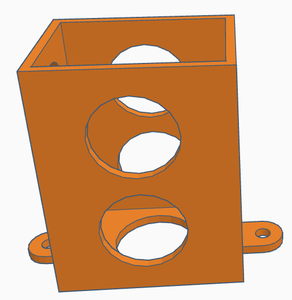

- Orientation of the camera, which will be discovered in Step 3, will need different camera brackets printing. Select the one for the camera to be used once Step 3 is complete and then print that item.
- The robot is intended to be used with either NiCad or LiPo batteries. Print the version of the battery box, and voltmeter holder, that will be used.
- The robot is intended for use on a smooth surface, so either a ball bearing or a fixed skid might be used. Files for both are provided.

Sokoban Chassis.stl

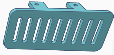

Sokoban Robot Buffer.stl

Sokoban Robot LiPo Battery Box.stl
Sokoban Robot LiPo Voltmeter.stl
Sokoban Robot NiCad Battery Box.stl
Sokoban Robot NiCad Voltmeter.stl

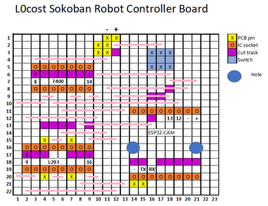

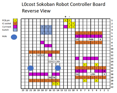

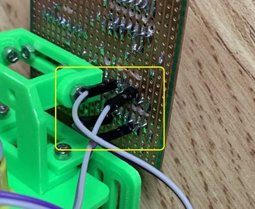

Step 4: Assemble the Controller Circuit
Briefly, the motor outputs from the LRC are routed to a L293D motor controller IC via a pair of NAND gates. One output is routed directly to provide speed control. The other two are converted into four inputs to the L293D by inverting the signal using the logic gates as inverters.
The controller circuit has been assembled on a small piece of stripboard using two ic sockets, pcb pins and pcb sockets together with a switch. As far as possible, all fitted connections run across the strips, except for one fitted along a strip to avoid a mounting hole, shown in black in the picture.
The pcb pins can either be mounted standing up from the front of the board, but the connections are easier if they are mounted through the board, see picture, and connected to the rear.

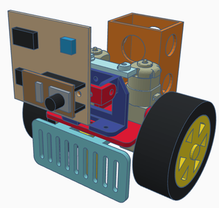

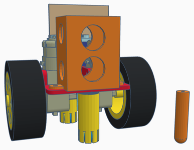

Step 6: Assemble the Robot
The pictures are numbered to aid assembly.

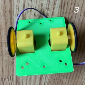

- Solder four wires to the motors with male dupont connectors on the ends. This can be done by adding two wires and then fitting the male connectors or taking an existing dupont cable with male ends and removing the unneeded end.
- Fit the two motors into the chassis and fix in place with 4 x M3 x 30m bolts. The bolts may hold themselves in place against the plastic but there is sufficient length to incorporate a nut on the end of each bolt. Care needs to be taken not to overtighten and break the chassis plastic. The wire connectors can then be fastened against the motor body using zip ties to make them more resilient to breaking off in use.
- Fit the wheels to the axles using screws.

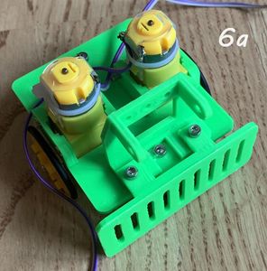

- Fit the chosen skids to the chassis, one front and one at the rear, using the printed spacers to adjust the fitting so that the chassis is almost, but not quite level, there should be 0.5-1mm of rocking to ensure that the wheels have good contact. The ball bearings must be fitted to do this if they are going to be used.

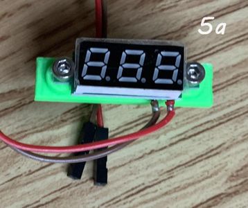

- If the voltmeter will be used fit it to the appropriate holder, for either NiCad or LiPo batteries. In the case of the NiCad holder, attach this to the Camera stand.
- Fit both the camera stand and the buffer to the front of the chassis using M3 nuts and 2 x M3 x 10mm bolts.
- Fit the chosen battery box, either NiCad or LiPo. The NiCad box fits over the rear skid fixing, for the LiPo box, the rear skid has to be removed and re-attached through the hole in the battery box.
- Attach the stripboard circuit to the appropriate camera mount using M3 nuts, bolts, and the plastic spacers printed earlier.
- Attach the camera mount to the camera stand using nuts and bolts, and then adjust the camera to the desired position before tightening the bolts up.

- If using NiCad batteries, connect the voltmeter to the voltmeter terminals on the controller circuit board. If using the LiPo battery box, the voltmeter connections are in the picture.

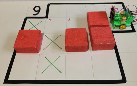

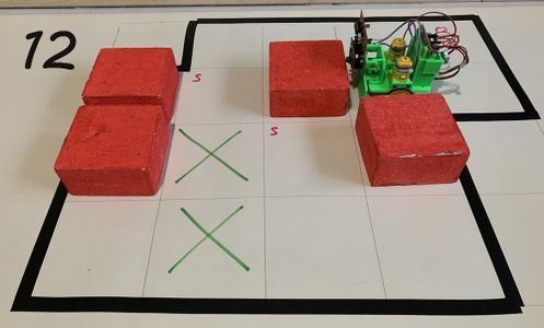

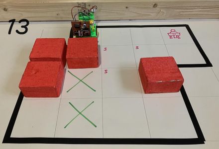

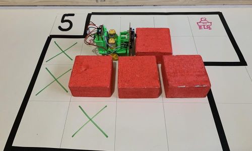

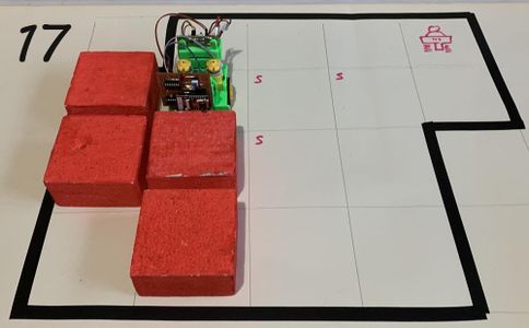

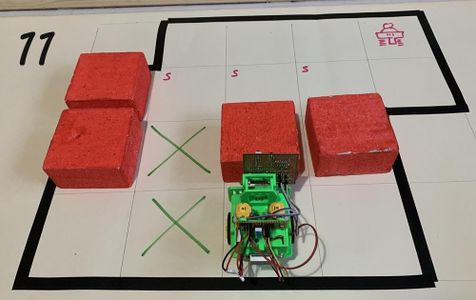

Step 9: Games
A Sokoban game layout is shown in the pictures and many more could be created. The objective is to move the boxes onto the target squares by only pushing them, with the robot starting from a set position. To achieve this, the robot may push other boxes out of the way but must not push two or more boxes at once. The robot must not leave the area bounded by the black line. These limitations are currently rules for players but anyone is welcome to improve on this and add features to the robot to build them in.
The pictures show the progress of a game from the start to the final target position. It's important to ensure that there aren't any loose wires as they can catch on the blocks and snag when playing, so zip ties are important.
The LRC can process video frames so can be used to add line, shape and colour detection to support line and object following.
