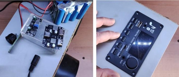

  2. 1 Bluetooth audio module Amazon / AliExpress
  3. 1 Lithium batteryAmazon / AliExpress
  4. 1 USB output moduleAmazon / AliExpress
  5. 1 MPPT solar charge controllerAmazon / AliExpress
  6. 1 12V 5W solar panel Amazon / AliExpress
  7. 1 On/off switch Amazon / AliExpress
  8. 1 Battery indicator display
  9. 1 Charging jack (DC input) Amazon / AliExpress

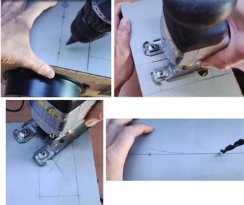

Step 2: Cut the Opening for the Bluetooth Module
Now that the speaker is empty, we can prepare the hole for the Bluetooth module.
Measure the module dimensions, mark the outline on the front panel, and drill a small hole to insert your jigsaw blade. Cut carefully along the line and smooth the edges with a file or sandpaper.
🧠 Tip: Take your time with this step — a clean cut will make your final result look professional.
Step 3: Add Holes for USB, Switch, and Charging Jack
Let’s make space for the rest of the controls and ports. You’ll need holes for:
  1. The USB output port (powerbank)
  2. The main switch
  3. The battery level indicator
  4. The charging jack
Use the battery height as a visual reference to align the components. The acrylic box that holds the power modules can go a bit higher.
This layout keeps the power management section separate from the Bluetooth controls — but you can design your own arrangement if you like!

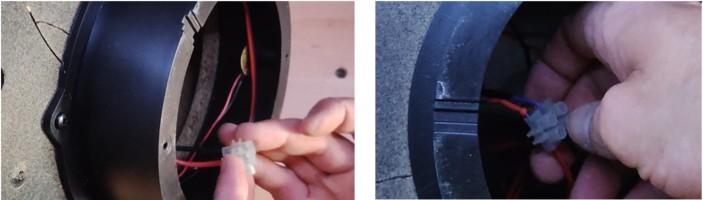

Feed the panel’s cable through the hole you made earlier and connect it to the MPPT controller via a terminal block.
3. Fixing Components and Closing the Box
Once the panel is connected:
  1. Mount the USB/charging module box.
  2. Fix the Bluetooth module in place.
  3. Add the switch, indicator, and jack.
  4. Reinstall the speaker driver.
Finally, reattach the plastic top and grille to close the box.

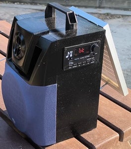

If everything works — congratulations!
Step 7: Final Result
And there it is — your very own solar-powered Bluetooth speaker with a built-in powerbank, made from an old stereo that was collecting dust!
Now you’ve got a gadget that not only plays your favorite music anywhere, but also charges your phone using free solar energy. No outlets, no waste — just clean power from the sun.
I hope that you enjoy it!
