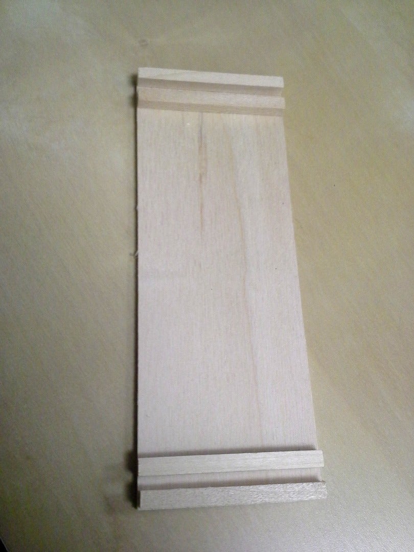

Step 2: Positioning and Gluing the Axle Housings

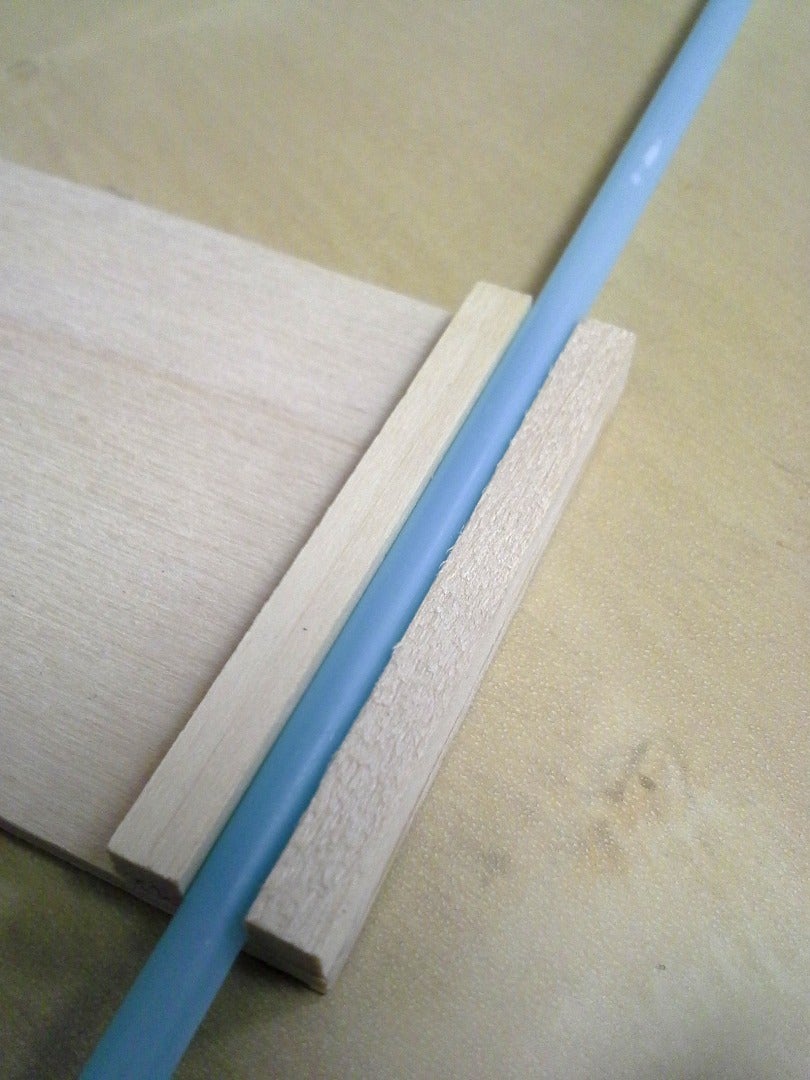

Begin by positioning and gluing the Wood Sticks onto the Wood Board so that the Axles/Straws can eventually sit in between them.
Place one wood stick at the very end and use the straw to determine the space for the other stick. Do the same for the other end.

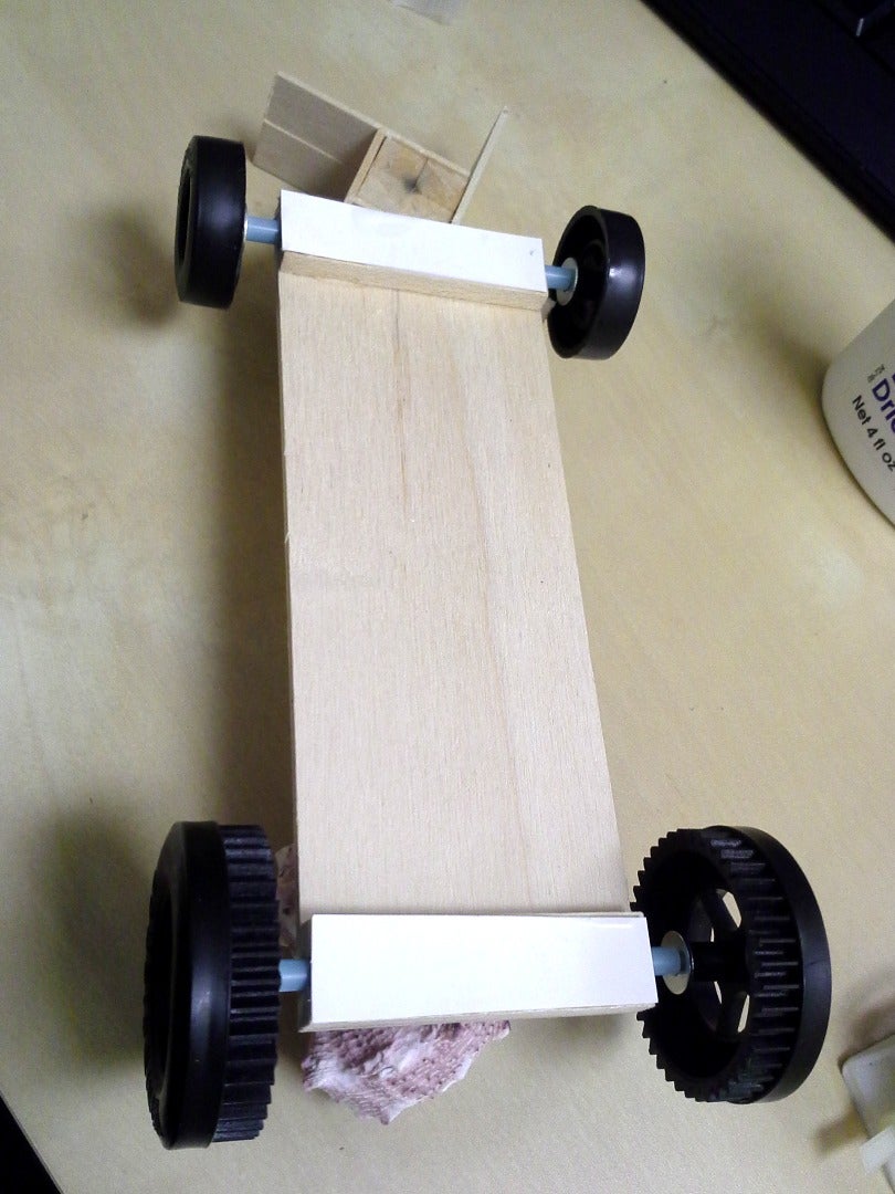

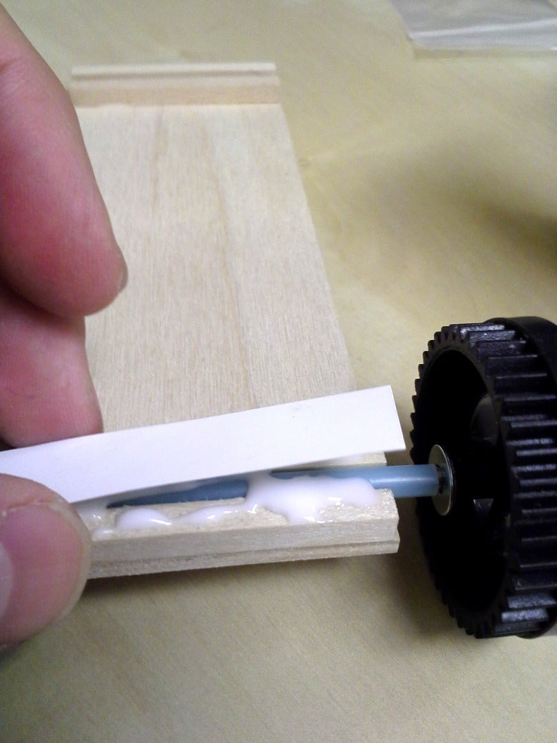

Step 4: Securing the Axles
Place your wheel component in between the two wood sticks you initially glued onto the wood board.
Then glue a thick paper onto the wood sticks to cover the axle so it will stay in place.
Step 5: Suspend to Allow for Drying
Since the wheels won't allow you to lay the board flat on the table to allow them to dry, you must use two small objects to suspend them.

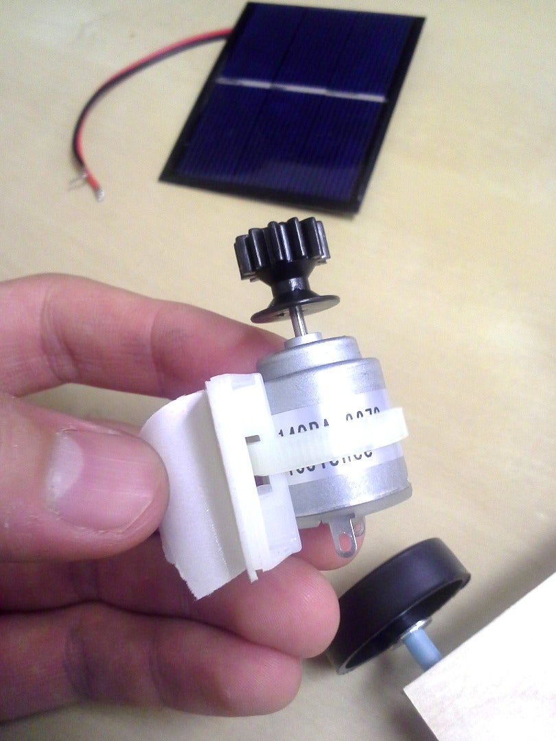

Step 6: Prepare Motor
Place the motor onto the mount, strap it so that it is snug and then put the gear onto the shaft.
Cut off any excess strap to give it a clean look.
Step 7: Position and Placing Motor & Gear
Once the glue on the axle covers has dried, place the car on it's wheels. Now remove the adhesive from the mount to place it onto the wood board so that the gear sits right into the gear of the back wheel.

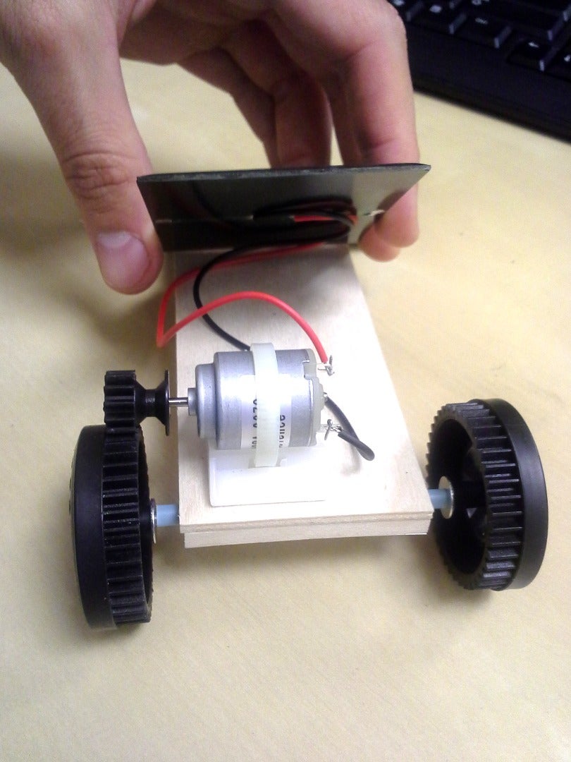

Step 8: Connecting the Solar Panel to Motor
Connect the Solar Panel to the motor and place on the motor so that it is facing upward towards the sun.
Put a piece of tape at the front end where panel is on wood board so that the panel doesn't move. You're now ready to place your car under the sun and start the fun!
