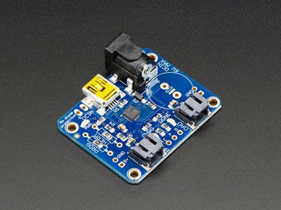

The solar panel (You may use the solar panel that comes with the JSS Kit or any other), the charger, and the rechargeable battery are from Adafruit. I used the Adafruit solar panel because it already comes with a DC jack connector. Otherwise, you need to solder one to JSS solar panel and this is discussed in the next steps.

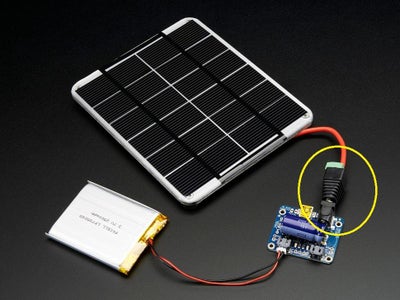

Step 2: Attaching a DC Jack Connector to Solar Panel

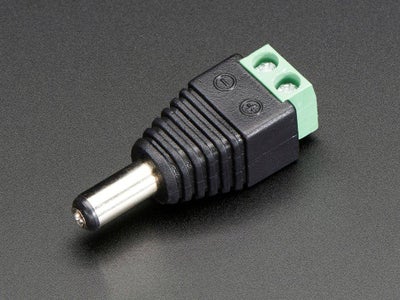

The solar charger has a DC jack. If you are going to use Pitsco solar panel you might need to solder or screw a DC jack connector to it depending on what you have already. Both panels have similar specifications so you would save money if you just purchase the Ray Catcher kit.
If you are going to use Adafruit's solar panel you may skip this part since it already comes with the connector.
Step 3: Attaching 2-Pin JST to a DC Jack

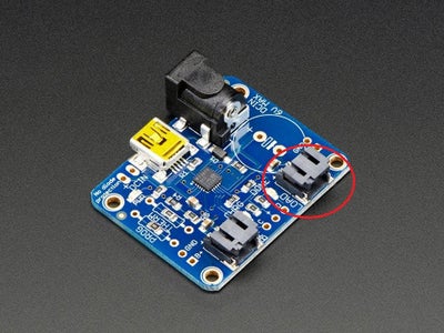

The moto:bit has a DC power jack and the solar charger has a 2-pin JST Load output. Therefore, we need to solder or screw a DC jack connector to a 2-pin JST wire depending on what type of DC jack you want to use. You may need to check polarity: red to positive, black to ground.

Connect everything based on the pictures above and the labels on the solar charger, BATT, and LOAD.

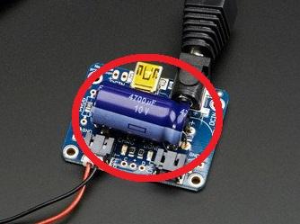

Then I used brass spacers so that the solar panel sits on top of the chassis. I used 2 screws to fasten the solar panel to the chassis. Also, I used one of those screws to fasten the solar charger to the chassis as well. I solder my capacitor standing so it does not fit under the solar panel. Therefore, it has to stick out from the chassis. You may overcome this by laying down the capacitor like in the picture.
