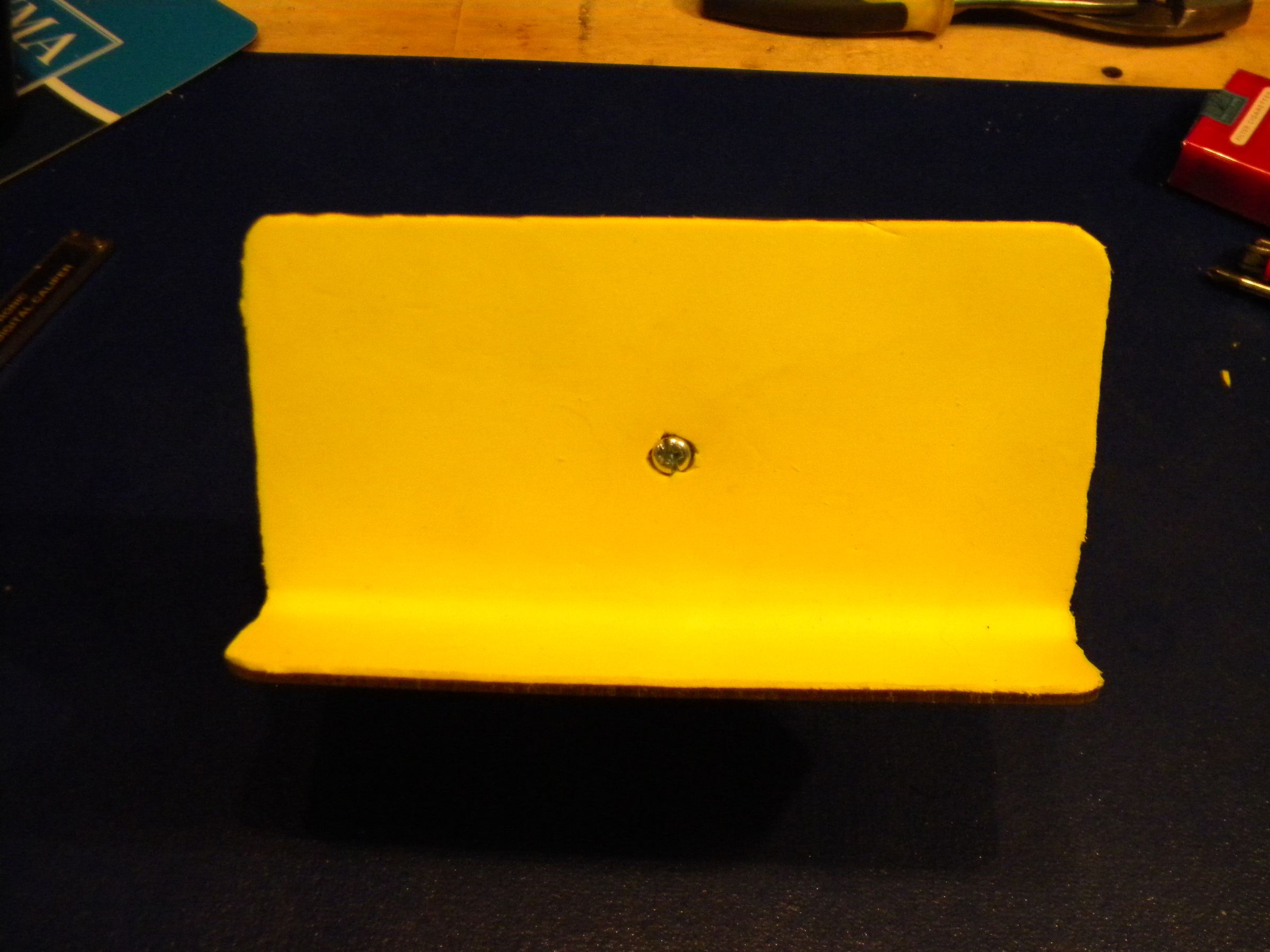

Step 6: FRONT METER MOUNT
Take your 2 inch by 2 inch sheet metal and bend a 30 degree angle
drill 2 screw holes in it (best done in a vice so no injuries occur)
place you meter in the rear holder then push your front mount up to the meter for a good snug fit ant install your 2 screws
