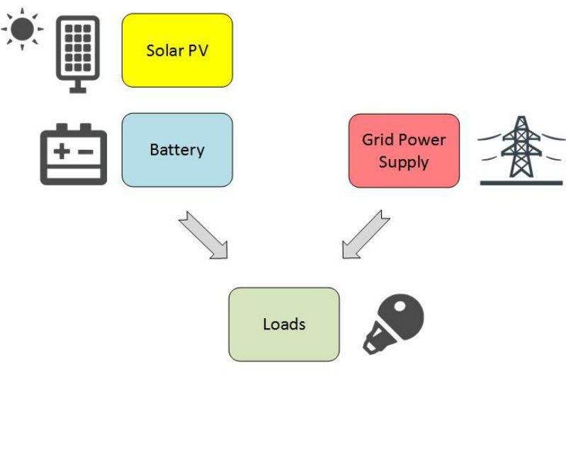

This instructable outlines a portable solar charging station, stereo, and LED light that is built into a playmate cooler. It is an all-in-one portable unit, as you can charge your phone or tablet with solar power, fill a room/beach/field with music, and also have an area light.
You can set this up at your home for everyday charging of your devices, and easily bring it with you for a day on the beach, on a camping trip, or anywhere else. It can be very useful during power outages, or even be a prime source of power in an off-grid cabin or home.
The design of this unit is very flexible, and you can choose features or expand on this to meet your specific needs. You can also take advantage of using scrap parts for its construction, with old car audio components, scrap wood, and spare wire that you might have lying around. I've found that you can borrow from a lot of "car accessories" that are 12V DC powered, or even use a small inverter for AC loads, to use this solar power for a wide range of devices.

There are basically 3 different circuits (1) loads, (2) batteries, and (3) solar panels. For each of these, you will connect everything in parallel to the charge controller, which isolates each circuit from the others. You MUST have a dedicated fuse installed in series with the battery. For the loads, instead of having individual fuses for each load (as shown), you could also lump this into a single fuse for all the loads. Other than that, the theory of it is pretty simple.
