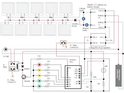

Step 1: Schematics
As shown in the schematics above, the solar power generating circuit itself is simple.
As I'm interested in the operational scheme of the solar cell, several measuring circuits are included such as a voltage meter, ampere meter, and battery capacity level meter.
I'll explain each measurement circuit one by one in the later step or at the other instructable as each device is a little bit complex.
The operational scheme of this solar circuit is simple like below.
- Solar cell produces about 50mA current when it receives sunlight (Although the solar cell specification claims a maximum of 400mA, the actual current I got under the sunlight through windows is 50mA)
- TP4056 lithium-ion battery charger circuit storing electric energy from the solar cell to 18650 battery (This module prevents overcharging and over-discharging of 18650 battery while operating)
- The 18650 battery storing energy from TP4056
- Battery level indicator circuit showing the capacity level of 18650 battery (This circuit was explained in other Instructables)
- 1Watt LED circuit is a load of this solar circuit and consumes energy stored in the 18650 battery
As this kind of solar circuit that charging battery is very common, maybe no further explanation will be necessary.

The second solar charger circuit is made to simulate the operational scenario written above.
