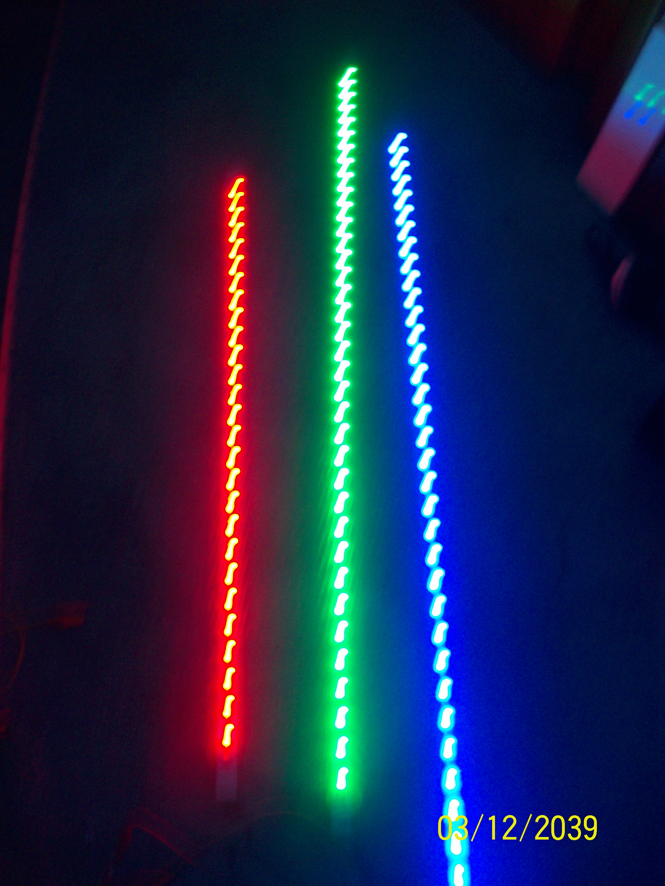

And finally in the last picture, you see 2 plug-ins connected (yes this is 12v not 110) and they go to 2 LED light strips (see my other instructables) and thats what I use to light my room at night. In the next sep I will show you some of the other loads I have created to run off of this system.

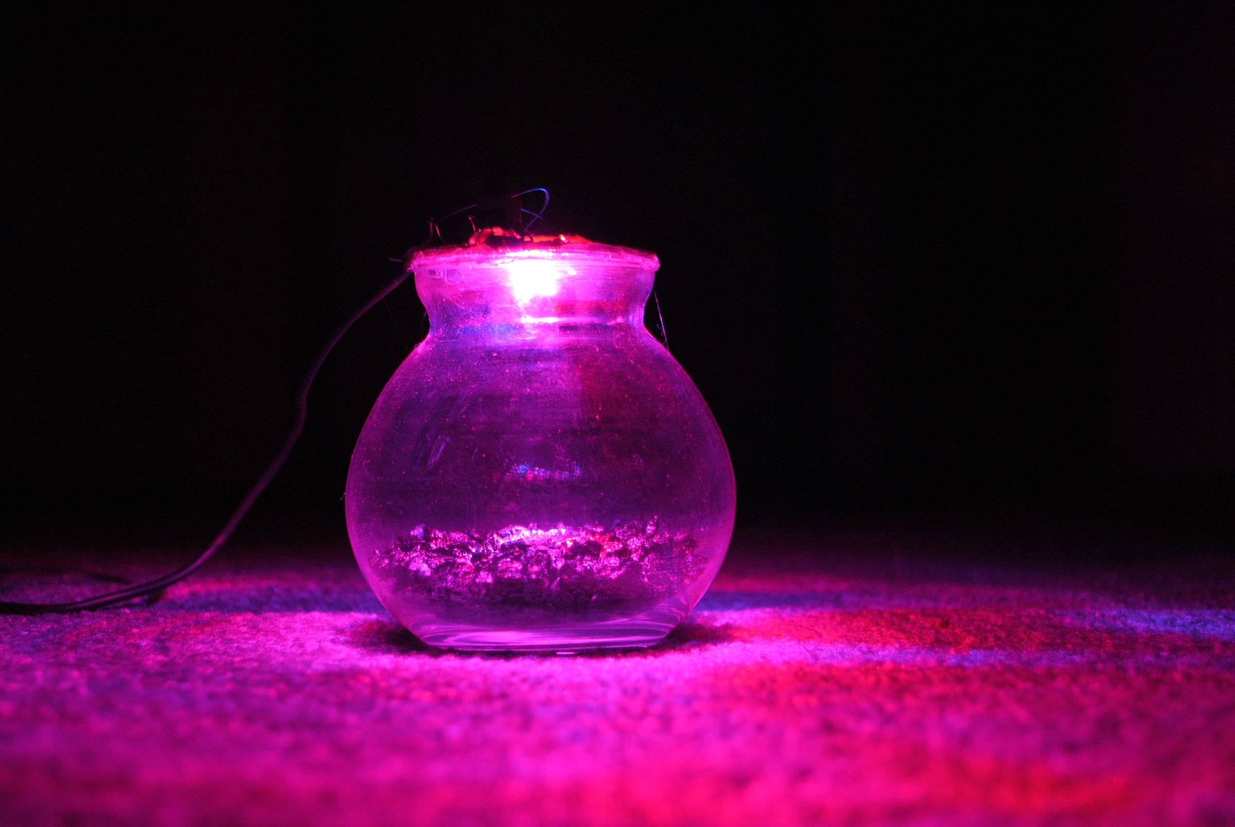

There is a lot of pictures here but it shows you just a few things that I can run off just a small solar panel. And yes every one of the things you see being powered in the pictures, is being powered from 100% solar power. And its FREE!!! :) And like I said before, check out the LED strips on my other instructable!!! And in the third to last picture you can see that I charge my phone, my PSP, and the one to the far right is just a rechargeable battery that I made to use with some of my other projects. And if you wouldnt mind, please vote for me in the Green Living & Technology Challenge, it would mean a lot to me! Thanks for viewing!
