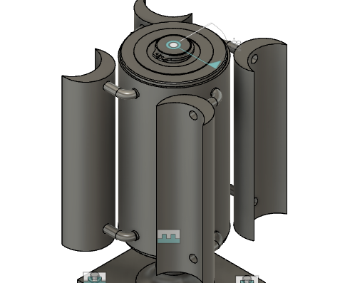

Step 1: Designing the Solar Panel Mounts
The main component of the project is the solar panels movement as such the mounts are the first thing that needs to be tackled. The STL files are attached bellow.
  1. Print using PLA
  2. Generate supports everywhere
  3. Infill 60%

Step 5: Motor Assembley
  1. Screw the panel flaps into the motor hinge using four screws
  2. Using screws and nuts mount Part 1 into the motor hinge
  3. Screw the servo horn into the motor mount
  4. Screw the motor mount onto the large servo motor
