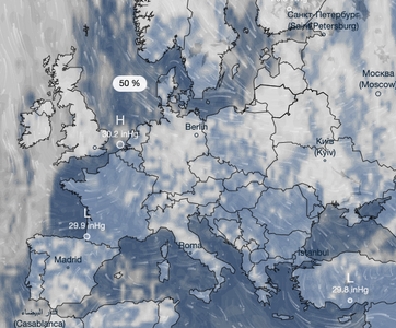

Other apps that are useful are Astrospheric and Ventusky. I use Ventusky as my primary weather app either in the US or abroad, and their cloud forecasting rivals that of apps that are intended for astronomical viewing and they have forecasts for sites all over the world. If you have a favorite astronomical forecast resource for destinations outside the US, please leave a link in the comments.

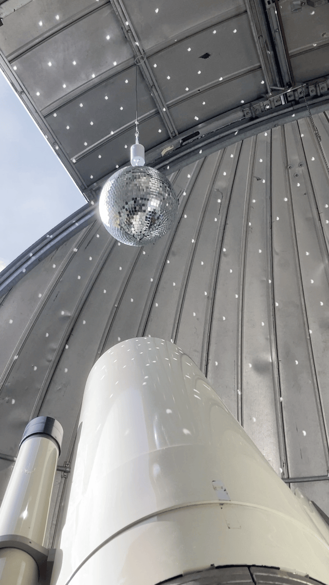

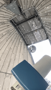

I helped run an astronomical observatory at the time of the 2023 eclipse, and we were fortunate to have the benefit of our telescope's rotating dome. It was easy to attach the disco ball to the slit in the dome, raise it up, and point it exactly where we needed it to be to project the image. The interior of the observatory and the dome itself made for a very immersive experience. If you are associated with an observatory or astronomy club, I highly recommend this method, but it's not necessary to be able to use the disco ball for solar eclipse projection.

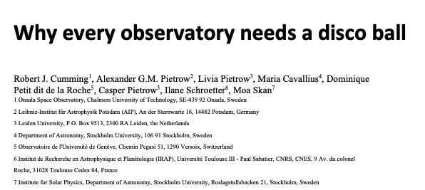

If you want to dive deeper into the science and optics of using a disco ball for eclipse viewing, I highly recommend this scientific paper attached. Citation: Cumming, R., Pietrow, A., Pietrow, L. et al (2024). Why every observatory needs a disco ball. Physics Education, 59(2). http://dx.doi.org/10.1088/1361-6552/ad1fa0
