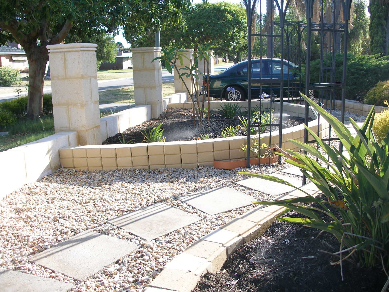

In the end, I am really pleased with how it turned out. I can see around my dark backyard, the edges of the garden path, which I couldn't see before. It also brings light to the garden which makes it special in its own way, which was what I was hoping for.
There will be more lights added in time. Plus i might try again with building my own bollards next time. But for now I will sit back and enjoy the lights over the Spring and Summer months that we are now just heading into.
