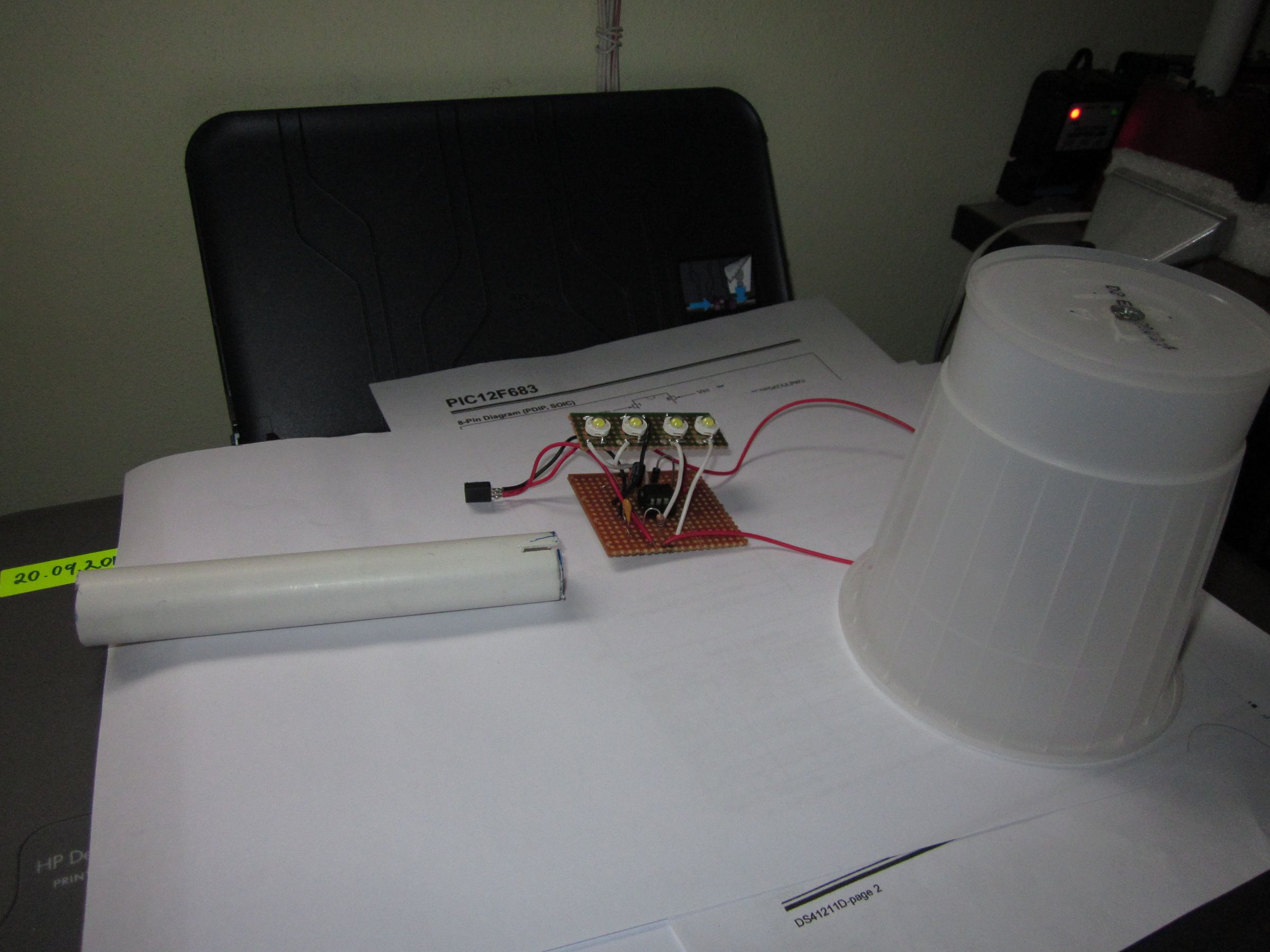

Solder the the circuit as in the picture.

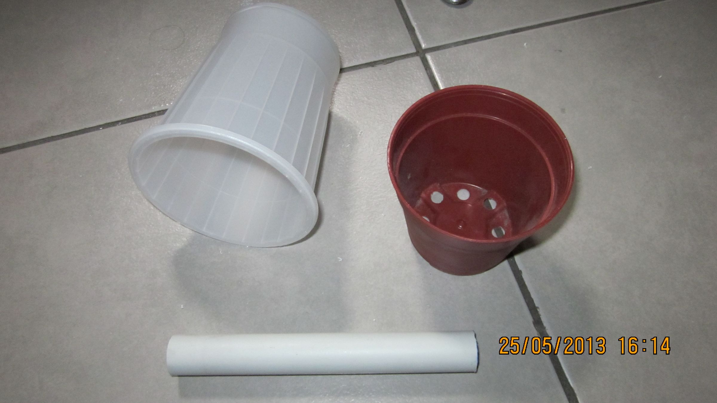

Put the solar cell at the top outside the lid but make sure to cover all open terminal and circuit line to make it
rainproof or water proof. Make a hole for wire connection between solar cell and batteries. Make sure design are waterproof.
Put the photoresistor below the lid or whereareas the ambient can be detected. Put all together for example like in the picture.
Operation tips:
Put the lantern outside under direct sunlight in a day and the LED would not be lit on because photoresistor became less resistance under bright environment. The base would be more negative than decreased the current flow through LED. Meanwhile, the battery is charged.
When sunset or in dark the lantern would automatically lit on using battery power.
The charging cycles for NiMH is over 1000 times. Mine, using same technology has worked for one years. Just put it outside sunlight. When power blackout, it would be usefull as usefull as commercial solar lantern.
