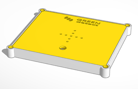

- Solar Panel case ( https://www.tinkercad.com/things/baTjBssvbcp )

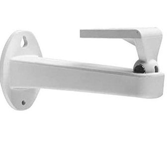

- Solar Panel mounting support (for example: https://www.amazon.it/ds-1296zj-h-regolabile-Universale-Fotocamera-sorveglianza/dp/B01KZP6KKI/ref=dp_prsubs_1?pd_rd_i=B01KZP6KKI&psc=1 )

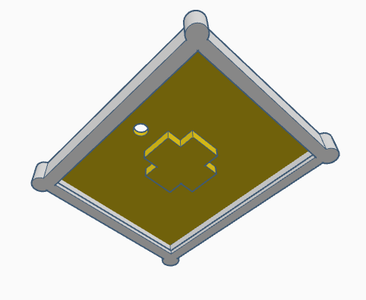

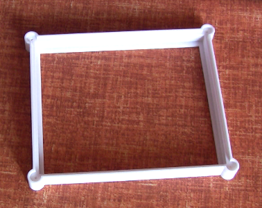

Step 1: Print Solar Panel Case

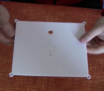

Solar Panel case is composed by 2 parts: the frame and the closing back panel
Download the .stl attached files.
Print both parts

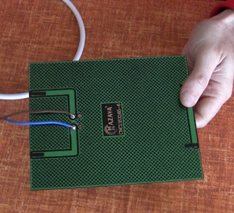

Step 2: Solder Solar Panel Cable
Solder positive and negative wires on the solar panel back.
It is suggested to insulate the poles with hot glue

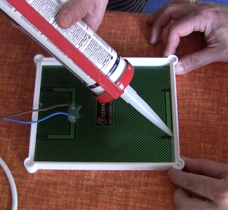

Step 3: Fix Solar Panel to the Frame
Fix solar panel to the frame by waterproof silicone sealant

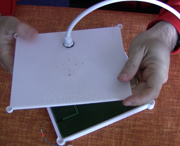

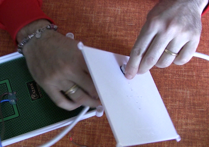

Step 4: Pass the Cable Through the Closing Back Panel
Install cable gland on closing back panel.
Pass the cable through the cable gland of the closing back panel

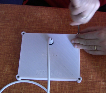

Step 5: Close the Solar Panel Case
Close the solar panel case by 4 small self-tapping screws

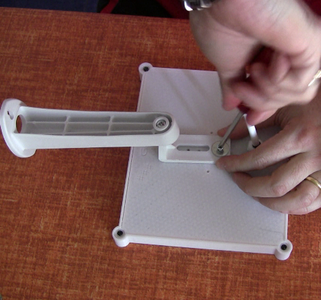

Step 6: Install the Mounting Support
Fix the mounting support by 2 self-tapping screws

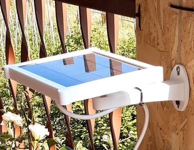

Step 7: Enjoy!
Your solar panel is ready to be installed outdoors!
