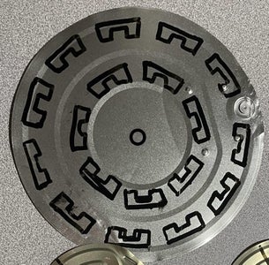

For the frame of the flower, place the 7-inch diameter tin can lid down with the best-looking side facing downwards. From 0.25 inches inwards from the outer rim of the lid, draw a horizontal, 1-inch line. Proceed to draw a 1 cm vertical line going downwards at each endpoint. From the endpoints of these vertical lines, draw a horizontal line going 1 cm inwards on both ends. Now, at the endpoints of these horizontal lines, draw a vertical 0.5 mm line on both ends and connect those two points with a horizontal line, which should be about 5mm. Repeat these steps, going around the entire circle at 0.25 inches inwards from the outer rim of the lid, and leave around 1 cm of space in between each figure. There should be 11 of the figures.
Part 2: Inner Section
At 3 cm inwards from the outer rim of the lid, repeat the steps above, but instead with a 1 cm space in between each from the TOP of the figures. There should be 7 of the figures in this section. Proceed to draw a 1 cm diameter circle in the very center of the lid.
Part 3: Cutting
When all the figures are drawn out, cut them out using a flathead screwdriver and a mallet. Place the tip of the screwdriver on the drawn lines and use the mallet to hammer the screwdriver into the metal to cut through all of the figures to create openings. Use the triangular file as needed to smooth out any rough ends.
