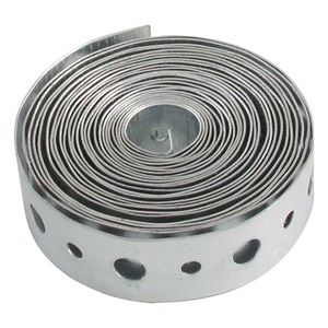

Step 1: Panel, Scrap Wood, Pipe Strap
The whole idea "hinges" on the pipe straps, being flexible to fit contours of closed window frame.
Got scrap wood on both ends of panel. Also Scrap wood inside window with 2 straps out to the panel.
The closed window essentially holds the straps, the inside piece of wood is good for initial setup.
