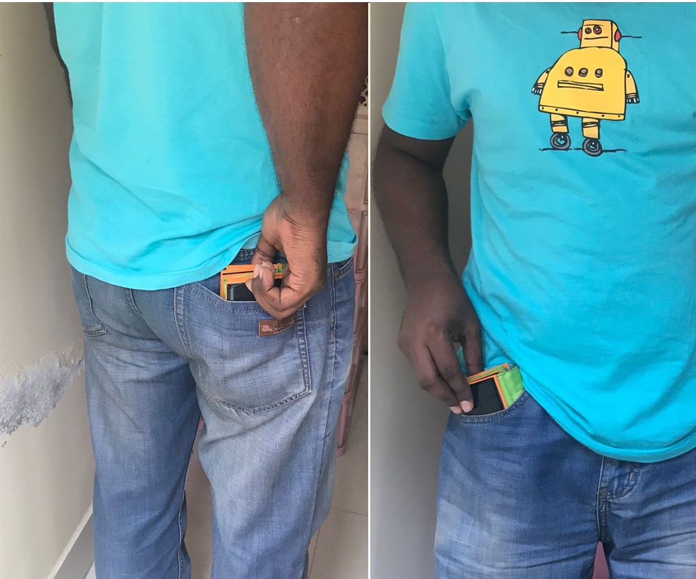

Step 8: Final Product
If you completed all the previous steps accordingly then Congratulation!!!
You successfully made your own Solar Pocket Charger. Now, you can easily carry the charger in your pocket and use it to charge your mobile phone, mp3 or tab.
You can also you it in a backpack and keep all of your electronics charged up while you are on the go.
