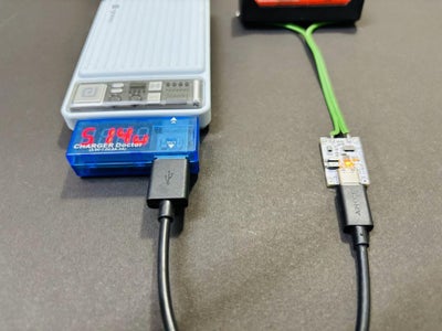

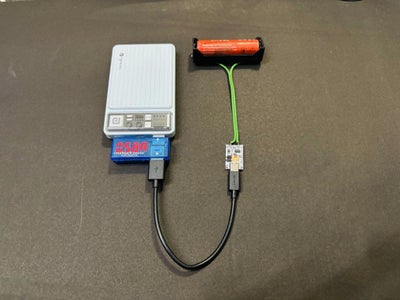

Step 8: Testing and Working:
I powered on the board after assembling it with a power supply set to max current limit of 100mA so that if anything goes wrong, it will not damage anything. But worked in the first go, all the connections are correct, but always check the VCC and GND lines continuity before powering ON. So, I connected a 3.9V LI-ION battery with a max charge voltage of 4.2V. The default charging current is set. The charging current rating should match the battery rating, so I always recommend using a high C rated battery, while charging with 3A.

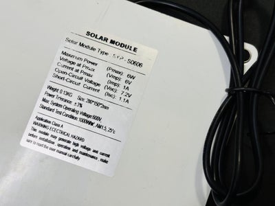

Solar Charging:
Simple Charging:
When charging the battery at full potential a very little heat is produced, which satisfies the 94% efficiency of this IC. I also have tested all protection features and all of them are working very normally. It is always recommended to check the output voltage of the board which should be in the range of 4.15-4.22 volts for the Li-ion battery. Try PCBWAY services from here, get free PCB coupons on first sign-up.
