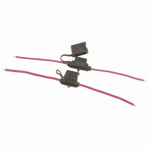

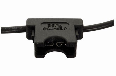

In-line fuses - used to fuse the main battery to inverter lead and the battery to solar charger lines
http://www.jaycar.com.au/productView.asp?ID=SZ2042
http://www.jaycar.com.au/productView.asp?ID=SZ2040
There is no reason why I used different leads - its just what I had in the garage at the time.

For the main battery to Charger and Battery to Power supply I used inline fuses like this:
Use red for the positive and black for the negative. Keep the routing as tidy as you can and use cable clips to help in this regard.

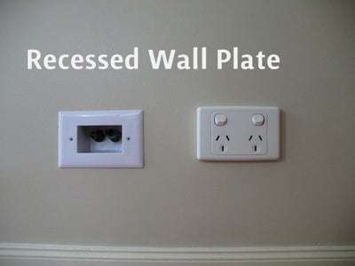

Step 25: Assembly - Wire From Solar Supply to Power Station
Using around a meter of solar cable to wire from the recessed socket to the right hand terminals of the solar charger. Pass the cables through the brush wall plate in the rear of the box. The spare cable stores neatly underneath the box allowing the box to be placed about 50mm from the wall. The cables from the battery to the solar charger can be done now also. These terminate to the centre connections on the solar charger. Leave the fuse out of the circuit at this stage.

I used a 10A fuse for the solar charger and 30A for the 240V inverter
I used 5A for each of the 5V DC power supplies and 10A for the Cigarette 12VDC socket and the Laptop Charger
