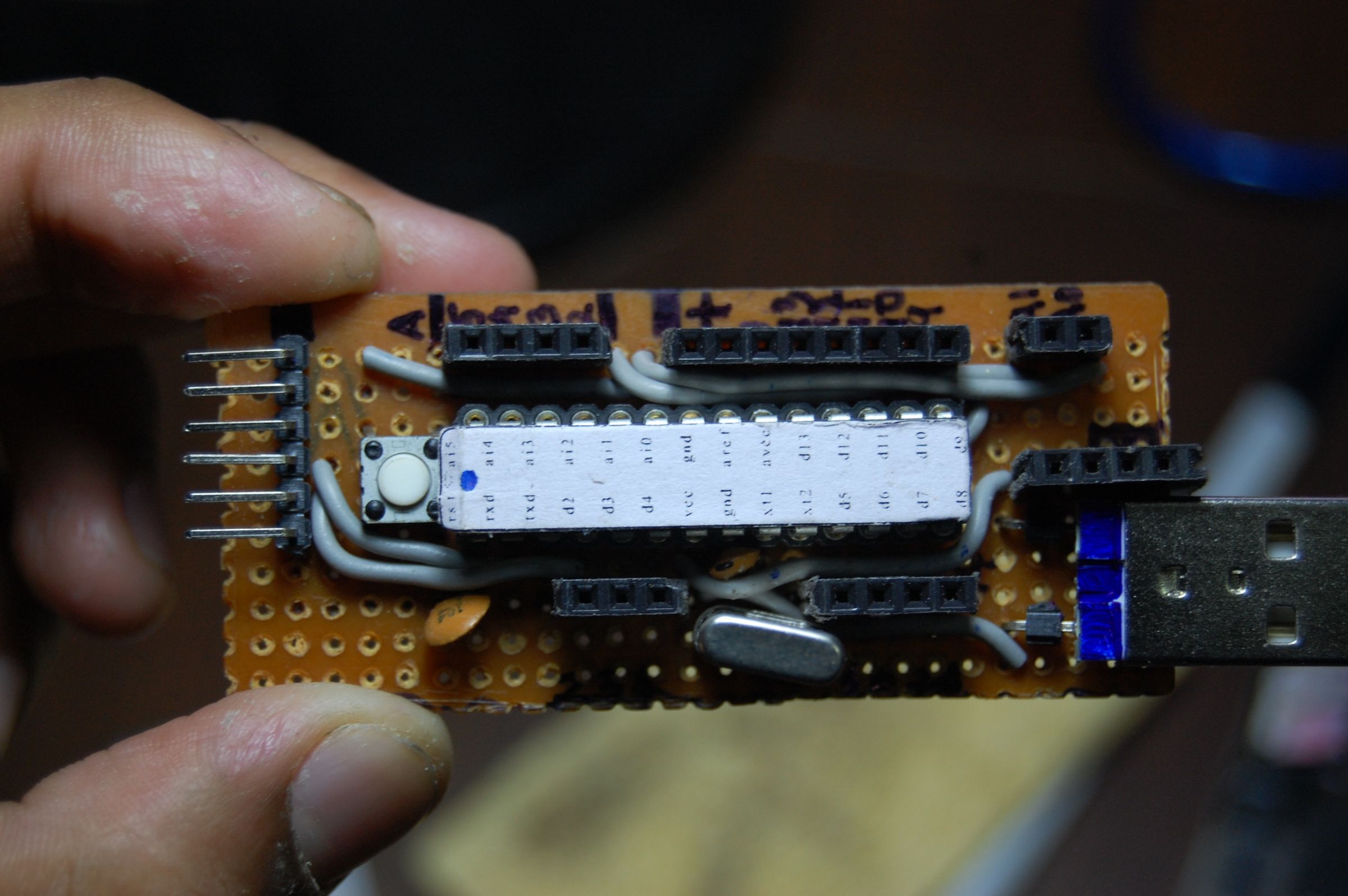

Step 2: Make Your Arduino Board...
Making an Arduino on a perfboard isn't very difficult at all. You'll probably spend 2-4 hours in total, so I suggest you do it over a couple of days. Soldering the Arduino requires a little soldering experience and proper tools, so if your a beginner check out this.
First solder all the passive components, like the sockets, headers, buttons, resistors, capacitors and thecrystal. I have not soldered the ATmega328 directly to the PCB, but instead soldered on 2 berf socket strips into which I'll place the microcontroller. This makes it easy for me to solder without worrying about frying my chip. You can solder the components in any arrangement you like, but if you want to do it the easy way, follow these steps:
- Solder all the passive components to the PCB, as shown below. NOTE: Soldering the bent male headers is only required if you plan to program you ATmega with an FTDI breakout. I have however shown a way to program the microcontroller with another Arduino, which is much easier.
- Now solder the jumper wires; vcc pin to the 5v header, A0 and A1 pins to their respective headers, and the wired to the ftdi cable. Refer to the circuit above for help.
Now make the solder tracks on the PCB. The result is shown below...
How to make solder tracks??? In the following pictures I have shown how to make a solder track connecting the ATmega's pin to the respective header...
- Deposit a blob of solder on the pad(s) between the pins you want to solder, as shown on the above...
- Melt the ATmega pin and the middle solder blobs with the solder iron, and while they're molten, add some more solder (not too much!) and remove the iron (but not the solder wire!). Remove the solder wire just before the lead completely solidifies. See the picure below...
- Repeat the above step for the header pin too. Basically melt the two blobs of solder you want to join, and while they're molten, add more solder and remove the iron. This is the result...
- You have now completed the "Arduino" circuit on the PCB. It is also helpful to add more 5v and ground headers. I also added a male USB plug for conveniently powering the board...
Check all the connections; see if you've forgotten anything, or if the solder tracks are incomplete, or if something is loose. Then pop in your ATmega328 chip...
Yay! Your Arduino is complete!!!

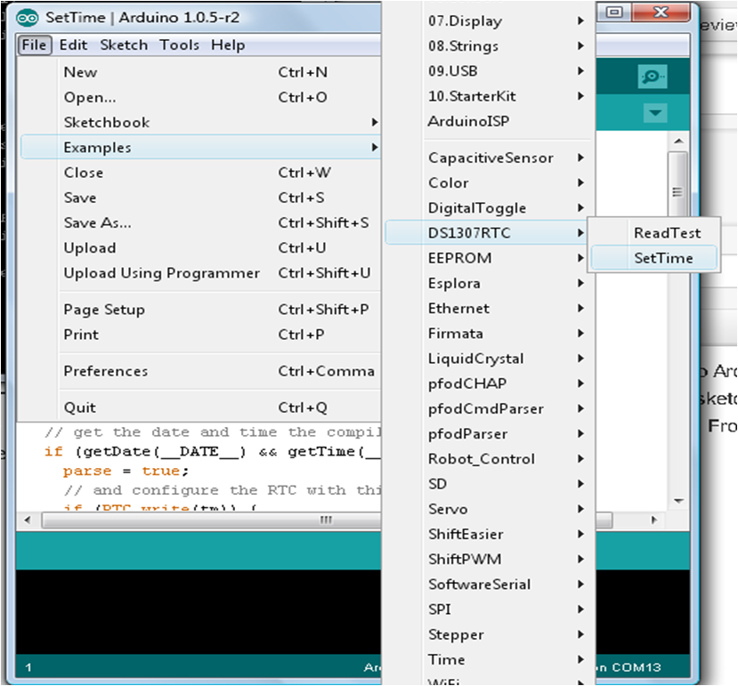

Step 5: Set Time on Your RTC...
Now its time to work on the computer. Download the Time and DS1307RTC libraries. Import the libraries to Arduino IDE, and then start the IDE. Then go to File < Examples < DS1307RTC < setTime.
Upload this "setTime" sketch to your Arduino board (with the RTC board connected). Now, DON'T reset or remove your board from power. From the DS1307RTC library examples, open the ReadTime sketch, and upload.
