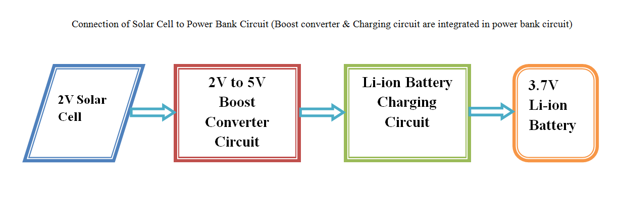

For charging a Li-ion battery with 2V solar cell we need a boost converter and a charge controller circuit. Li-ion battery should charge with constant 4.2 V. So, 2V solar cell is not capable to charge a 3.7 V Li-ion battery and for that we need a boost converter. Boost converter will step up 2 V to 5 V. The output of the boost converter will be fed to the input of a Li-ion charging circuit. Charging circuit provides constant 4.2 V output to charge a Li-ion battery. If you use 6V solar cell instead of 2 V you can directly connect solar cell to the input of the charging circuit through a diode without using the boost converter. Diode will reduce 6V to 5.3V to make the voltage acceptable for the charging circuit.
Good news is that, power bank circuit contains both boost converter and Li-ion battery charging circuit in a single board (very useful!!!). Boost converter of some power bank circuit is not capable to step up 2 V and in that case you have to use 6V solar cell or an external boost converter circuit like this. I am lucky enough mine is capable to convert 2V to 5V. To know more about power bank circuit you may visit the link.
Let's slightly modify the control circuit of the power bank to make it suitable to connect with solar cell and battery. In the power bank output of the charging circuit and the input of the boost converter circuit is connected to same Li-ion battery. We need to detach the boost converter input from battery. We will connect it to the output of the solar cell as shown in the above image. After detaching the boost converter from the battery connect positive output of the boost converter to the positive input of the charging circuit and ground of the boost converter to the ground of the charging circuit. With this connection output of the solar cell will be feed to the input of the charging circuit after stepping up to 5V with boost converter. Follow the attached photo to make the thing clear.
