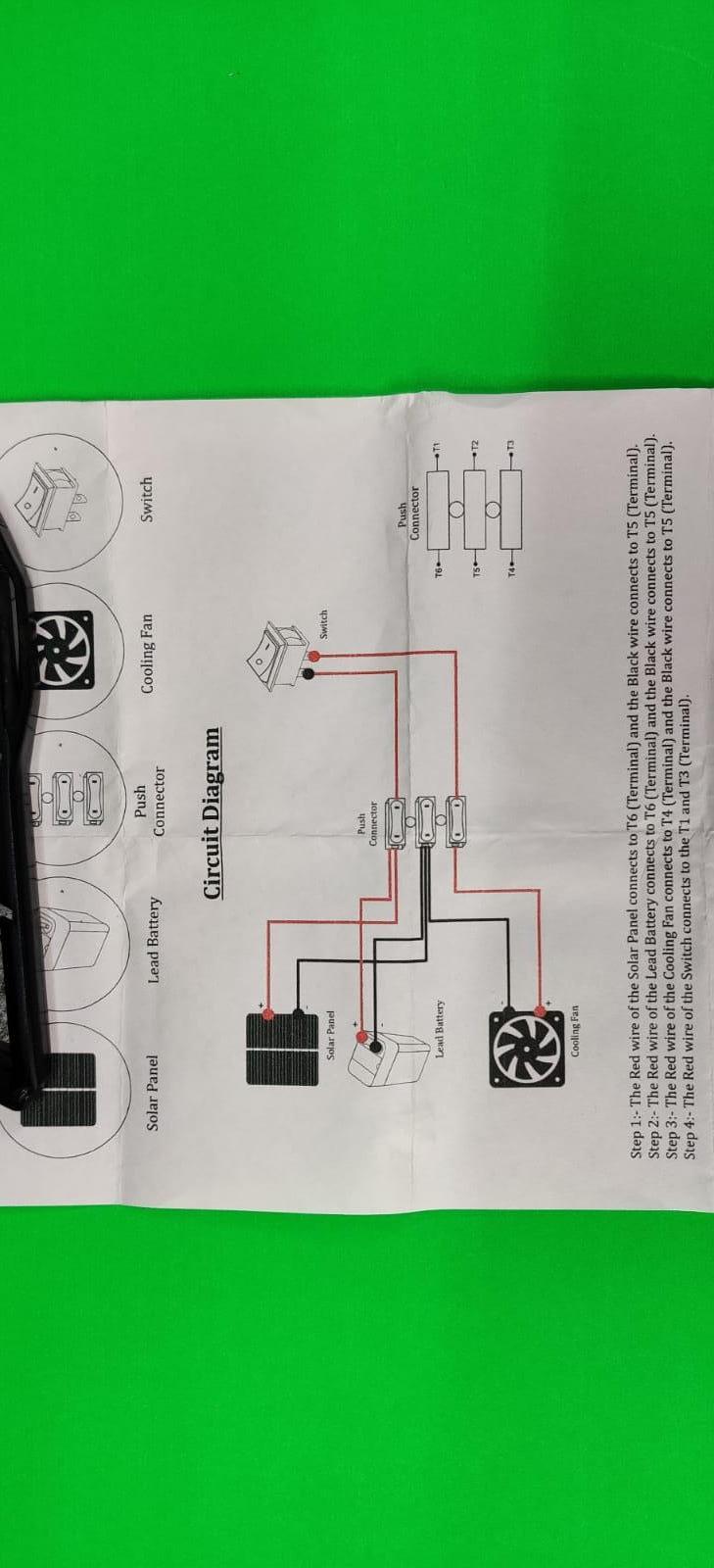

  1. Follow the circuit diagram and connect the battery, fan, switch with the solar panel.
  2. Ensure smooth operation without loose wires.
  3. Fix the fan on the floor of the box so that the air and moisture inside the box is fanned out.
