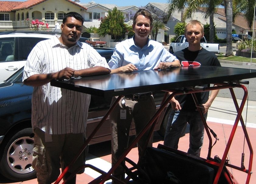

In this project we took a go kart frame designed to take a gas engine and made it electric and solar powered. It uses a 48V SLA battery pack with a EMC-ME0909 Brushed DC motor, 0-5k Ohm Pot Box throttle, Alltrax 4834 controller and an Astronergy 5612M 190W solar panel to charge the pack. Runs great with a top speed of ~20-25mph, and because of the solar panel a potentially infinite range!

The baseline of the electrical system is from the Alltrax electrical diagram for EVs, at this link here. It has wall chargers but the primary source of energy is the solar panel on the roof of the kart, which is always on and always charging.

Engineers Who Built It:
Will Bagienski , Adam Plesniak , Luis Torres
