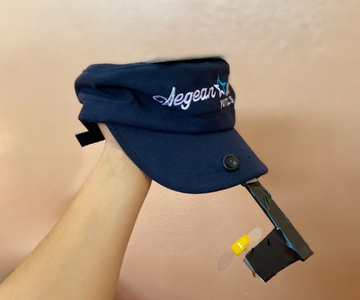

The object I created is a hat 🧒 that collects solar energy β˜€οΈ to power a fan and provide coolness on sunny days. On top of the hat is a photovoltaic panel that absorbs solar energy and transfers it to a solar charger. The charger stores the energy in a rechargeable battery πŸ”‹.
When the battery has enough energy, you can press the built-in switch to activate a small motor with a fan attached. The fan spins 🌬️, generating air and keeping you cool on hot days.
It’s the perfect solution for a sunny day β€” providing comfort while conserving energy through clean, renewable power 🌱.

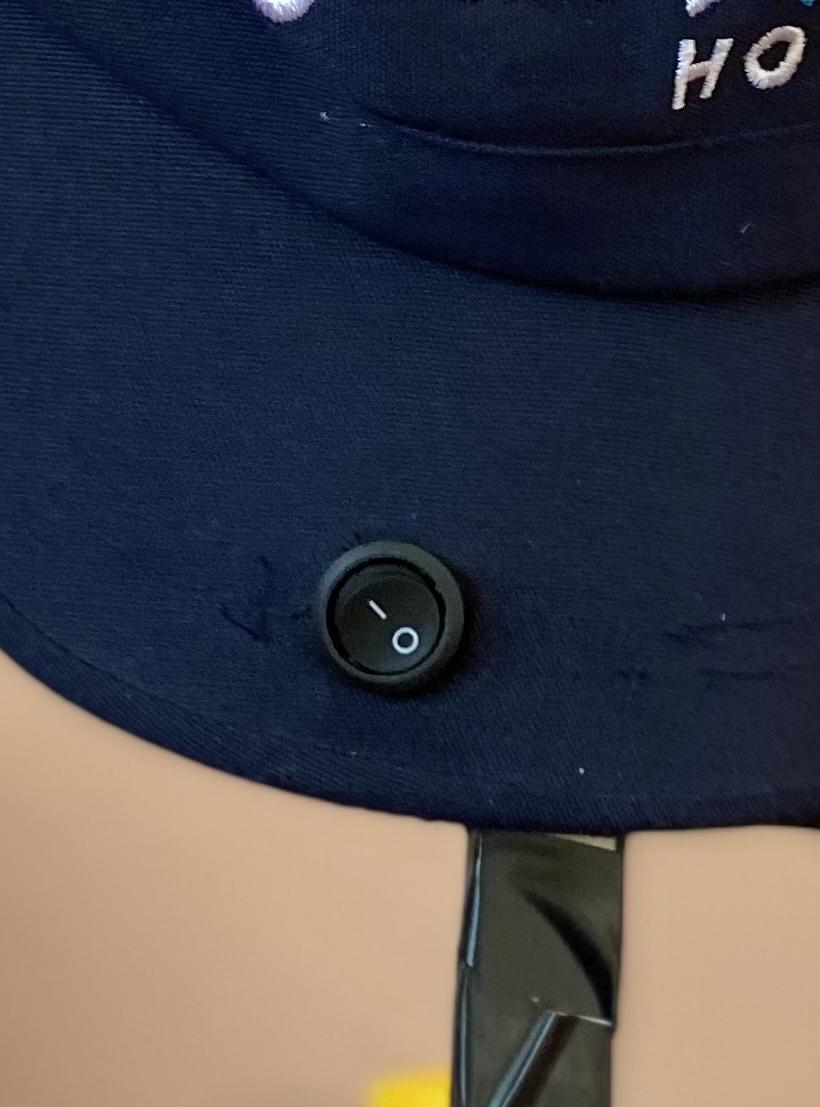

Step 2: Adding the Switch
Next, I made a hole in the baseball cap 🧒 β€” just large enough to fit the switch πŸ”˜ β€” and carefully inserted the switch into place (see image above for reference). Once secured, I connected the switch to the circuit, as shown in the image in the previous step.

Next, I crafted a pouch πŸŽ’ from a transparent sheet sized to fit the solar panel β˜€οΈ. I then sewed it πŸͺ‘ securely onto the top of the baseball cap (see image above). I placed the panel inside the pouch and carefully passed the wires through a small hole I made, routing them to the inside of the cap.
Step 4: Mounting the Circuit in the Inside of the Cap
I mounted all the circuitry inside the cap 🧒 and secured the motor πŸŒ€ under the bill (visor) of the cap, just like you see in the images above. Finally, I attached the fan accessory to the motor, completing the setup.
