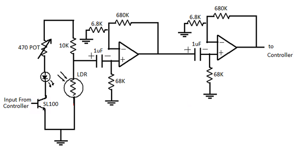

Step 4: Getting a Heart Rate Sensor Board...
Getting a premade HR board makes things much easier. I got mine from the local shop. You can try that too, but if you don't get one, try some of the following sites:
If you can't get one, you may have to make one yourself. I have uploaded two different but similar schematics using dual opamps. Then go on to the next step to see how to test them...

thanks. can i use another IC instead of mcp602?
Reply 6 years ago
yes u can... an LM358
