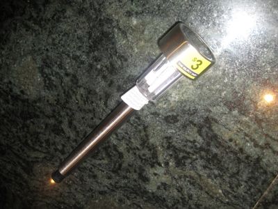

- A light. I found a really cheap solar garden light in the discount shop.

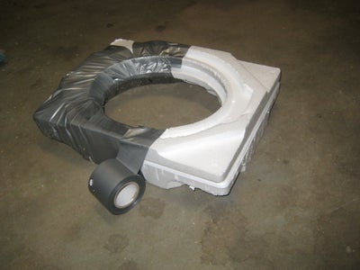

First create your float. A ring shape works well. I just used some polystyrene which I thoroughly taped up with duct tape to prevent it from disintegrating and making a mess.

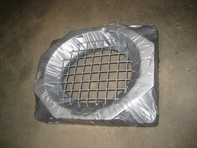

Then make a support for the light. I used some weld-mesh. The important thing about this is that the insects can fall into the water.

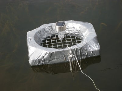

Then Attach your light to the support. Make sure that the solar panel gets sunshine, and that the light will be visible from all angles.
Make a mooring line or anchor line with the string.
Step 3: Launch
Simply float your fish feeder in the pond. Position it where it will get plenty of sunshine during the day, and where fish are likely to be swimming about during the night. Use the string to stop it from floating away.
