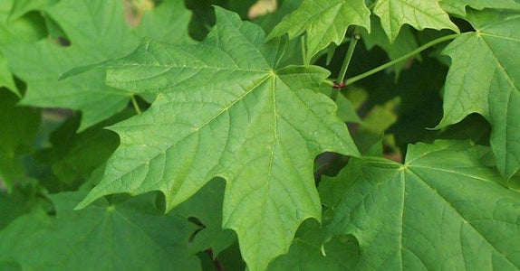

Step 1: Identify Maple Trees
First, you need a maple tree or two that has grown big enough to tap. I identify maple trees by their leaves, but apparently it is possible to find maple trees in the winter looking for opposite buds on twigs and inspecting bark. Just be aware that ash and dogwood also have opposite buds on their twigs. A tree with a trunk that at four feet above ground is 10 inches in diameter (which equals about 32 inches in circumference) can be tapped.
Several varieties of maple trees can be tapped. From what I've read, sugar and Norway maples tend to have the highest sugar concentration in their sap, followed by black maples and then red maples and silver maples. I'm not picky about which species of maple I tap; I just try my best to avoid tapping oaks and ash trees.
Last fall while the leaves were changing I went out to our land with a tailor's tape measure, found some maple trees by looking at their leaves, checked the circumference of trunks four feet off the ground, and tied yellow ribbons around the ones that had a round girth of 32 inches or more. Going back in the winter after the leaves are off, I’m honestly not sure I would have been able to tell the difference between our ash trees and our maples. I must be tree blind, because my friends can see a difference in bark between the maples and ashes. In any case, if you want to be sure what you’re tapping, a fall expedition is worthwhile to identify your maples beyond doubt.
