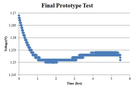

I tested two variables here, the size of the solar panel and the type of charging device. So I tested between a larger solar panel and a smaller panel and then also a 70 F super capacitor and a rechargeable battery. I used a TP4000ZC to log the data every 1/4 second and a 40 W bulb to power the solar panel. The base software from that multimeter wasn't that useful so I used a python library to log the data.
These tests revealed that the smaller solar panels I tested at first weren't big enough. They also revealed that the 70 F super capacitor discharged a lot faster than the rechargeable battery. But after implementing the circuit found in the next step and using the largest solar panel I had, I retrieved the following graph above. After about 6 hours of testing with a dummy load of 47 Ohms (simulating the absolute maximum load from the mouse over a longer period of time), the test showed that the solar panel not only sustained a charge, but it also started to trickle charge the battery.

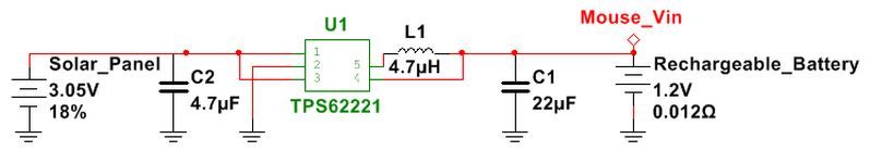

Voltage Converter:
The circuitry seems pretty simple, with a down voltage converter. The converter can at most take a voltage of 6 volts and in this configuration the regulator can output 1.5 volts according to this datasheet. This circuit may seem easy at first, but due to the size of the chip, it can take about an hour or so while being careful with regular soldering iron tips and larger gauge solder wire. The circuit was placed on the SMD protoboard and the components were found in my school's electronic supply closet. I'm absolutely sure that the circuit could be smaller, but at the time I didn't get the smaller surface mount components. If this is done the circuitry could easily fit inside the mouse.
