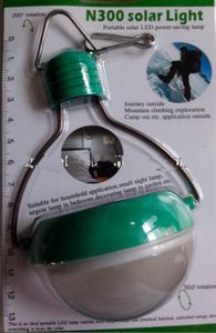

Some time ago I won an instructables contest and received all kinds of solar powered gadgets. Wonderful! Among those things were three solar powered camping lights. A fun design, like a bulb with the middle part missing. I put them outside in the garden and at night they shine with a bright white light for several hours. So? Why mess with a success story?
Well, for camping and hiking the plastic shape seems fun and fine, but for permanent use in the garden its a bit eh..., cheap?
And as I'm using the lights for atmosphere, and not for reading I did not mind making them a little less bright.

Remove the socket like part of the light. It destroys the "bulb" effect, but somehow I like the design better without. No "would be" smart gadget, but a straightforward object to use. Put the hook directly on the metal handle.
