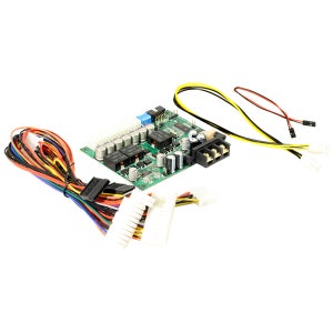

M4-ATX, 250w output, 6v to 30v wide input Intelligent Automotive DC-DC Car PC Power Supply
We need a very special power supply - namely, the M4-ATX from Mini-Box that can handle input voltages in a range from 6 to 30V DC.
This is supplied as a power board only! There is NO enclosure and NO cooling! So make sure you provide these before you fire it up, or it MAY set fire!
This board provides 250w power! Plenty!
